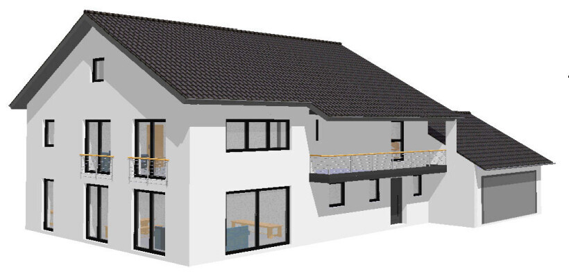

What do you think of the design? What would you change?
Since the terrain needs to be adjusted and the foundation slab filled to compensate for the slight slope, how much would you estimate the additional cost for a basement? The planner suggests that a basement should be considered with a height difference between 1.5m and 2m (5 to 6.5 feet).
Do you have any other thoughts? Once you commit to a design, it’s easy to become a bit blind to alternatives...

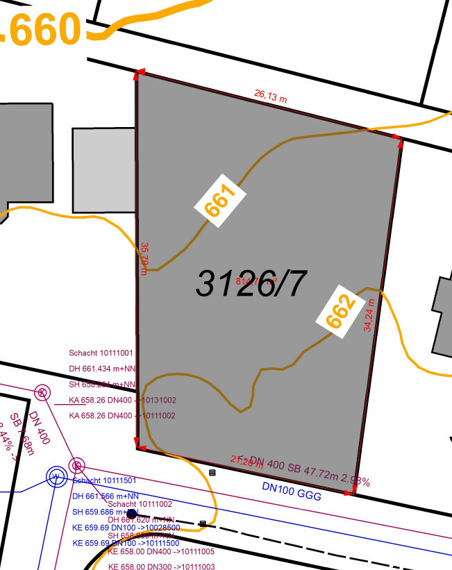

Contour lines

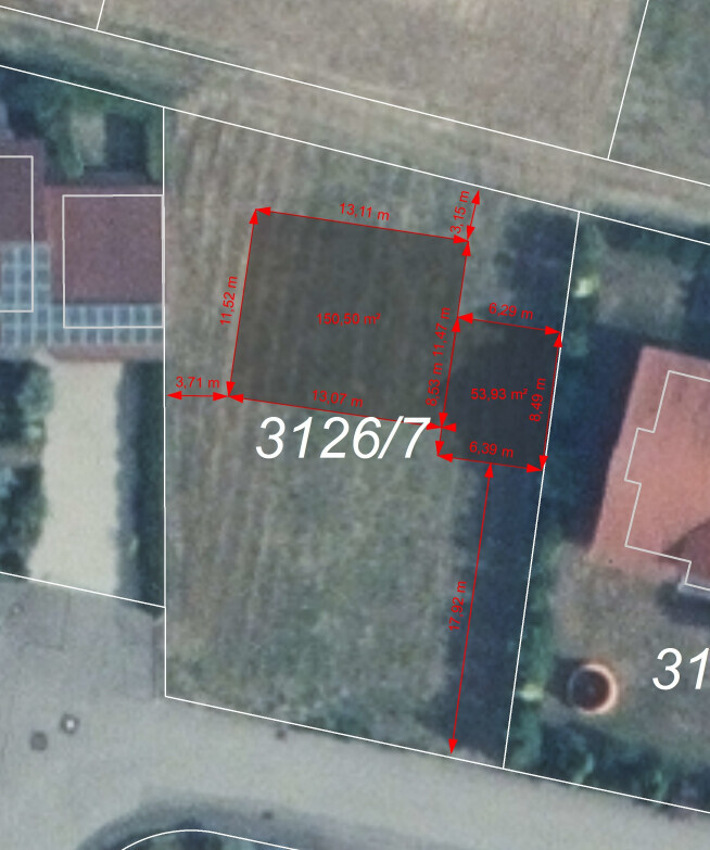

Aerial image with dimensions and boundaries

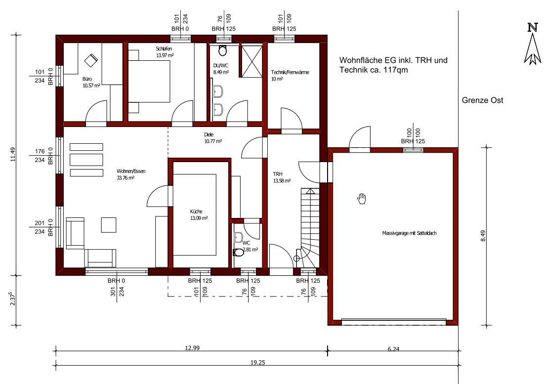

Ground Floor (GF)

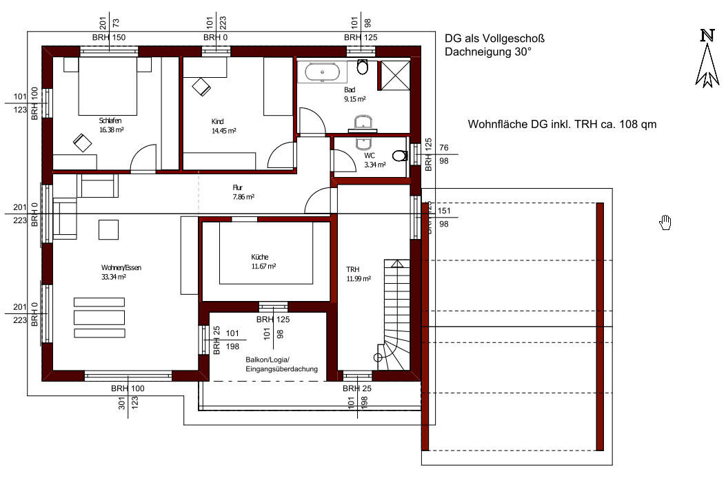

Upper Floor (UF)

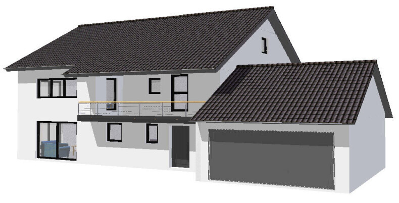

Front view
Front view

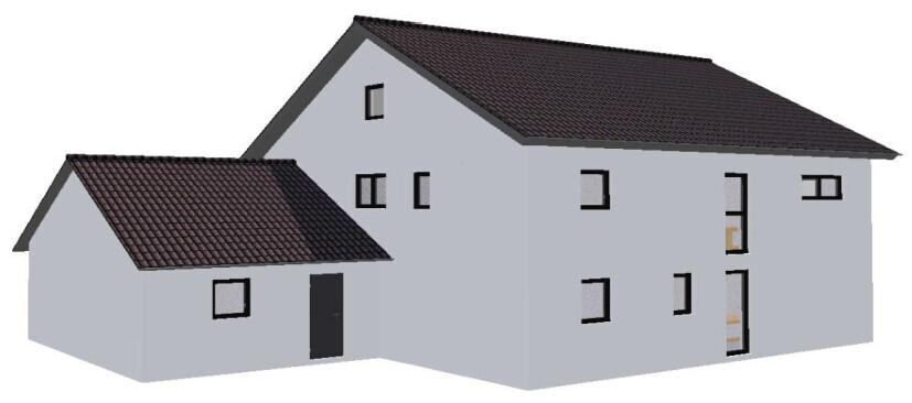

Rear view

hm…
First of all, some important information is missing here that we need to properly assess the project.
I don’t see a single-family house, but rather two apartments in a duplex. This does not change even if the kitchen is initially not installed upstairs.
So I don’t see what defines a single-family home.
If you intend from the beginning to build a duplex because the children are already 20 years old, please state that clearly.
We don’t know you, your family, or your requirements.
As I said, I currently see no flexibility, just two separate living units.
In my opinion, such a staircase separated from the family living area is a no-go, not just for a young family.
Also, for living in retirement, the lack of clear zoning between public and private spaces — such as the bedroom opening directly into the living area without offering intimacy or privacy — is a no-go for me.
I have seen much more clever solutions when considering separating two levels.
Well, I see a two-story building plus an attic space suitable for conversion plus a double garage.
With a 1.5 slope (1.5 meters (5 feet)), the most cost-effective option is usually a single-story with an expanded attic, or a single-story with a small attic and a basement.
However, it is not clear how the site levels are distributed, so it’s difficult to estimate.
Whether it must be a two-story from the start or can be, is a budget question that unfortunately has not been answered.

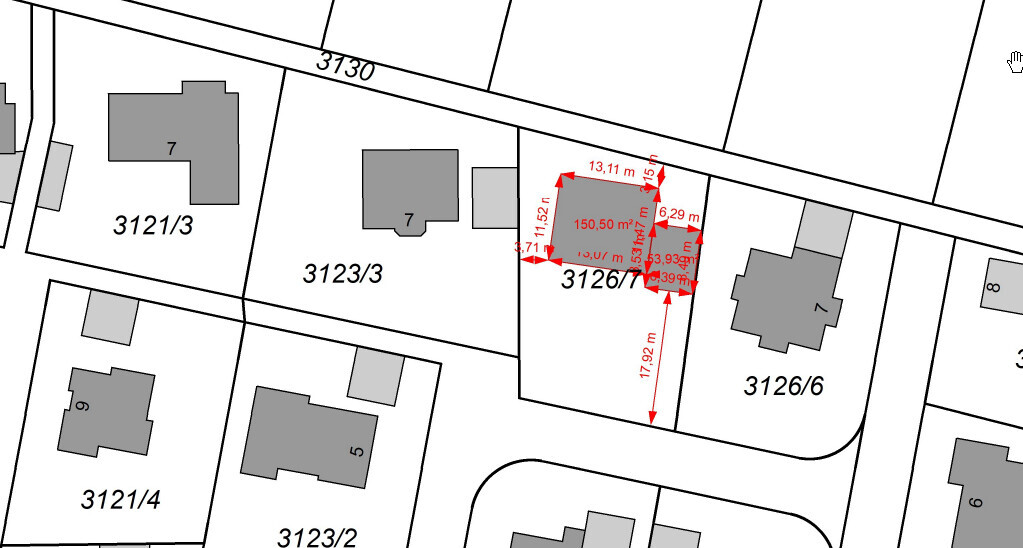

And the owner (a relative) also agrees to an easement if it becomes somewhat larger. A tolerance declaration is not sufficient; setback areas must be maintained.

hanghaus20231 Sep 2023 13:08ypg schrieb:
However, it is not possible to clearly see how the elevations are distributed across the plot in order to make an assessment.The original poster even provides the contour lines (very commendably).
hanghaus20231 Sep 2023 13:25The slope is between 5 and 7%. In my opinion, the basement doesn’t pay off yet.
WilderSueden1 Sep 2023 13:29An image showing the building volumes drawn into the elevation profile would be helpful. However, when I put this together for myself, I am not very pleased with the placement. The house is not only positioned far back (long utility lines, 18m (59 feet) driveway...), but also in a depression. Is all of this going to be filled in, and how will the upper boundary of the plot be retained?
