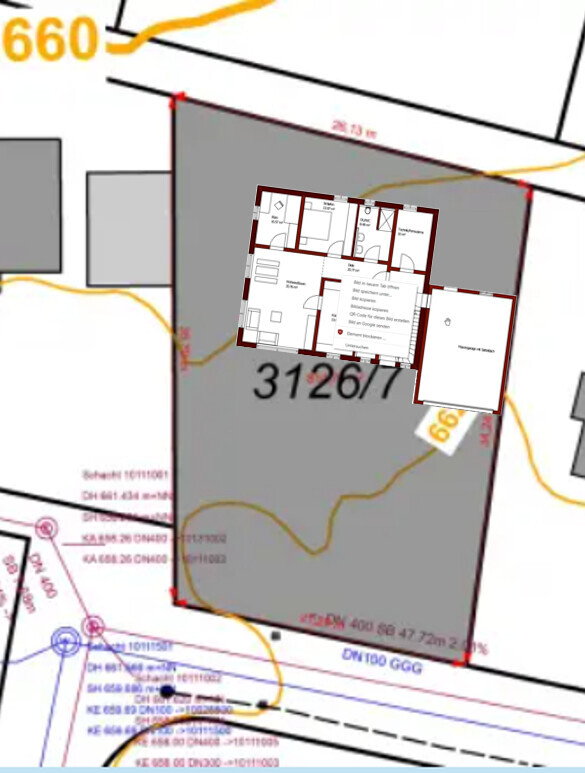

Hello.
I have a plot of land with a slight slope; the height difference from the front to the back is about 1.5m (5 feet).
For cost reasons, I would prefer to forgo a basement and have as much as possible on the ground floor level. The upper floor is intended to be used either by the children or possibly rented out later, depending on what the children decide to do.
I expect that building upwards with an additional upper floor will provide more flexibility than building downwards with a basement, which is usually less pleasant to live in compared to the same area at ground level.
A large double garage will be built on the east boundary. The neighboring property on that side only has frosted bathroom windows, and the owner (a relative) has also agreed to an easement if the garage is somewhat larger.
Plot size: 814m² (8,761 sq ft)
Slope: approx. 1.5m (5 feet) across the entire area
Floor area ratio (FAR): 0.4
Plot ratio / floor space index: 0.7
Maximum number of floors: 2
Roof style: gable, 30 degrees
Ridge orientation: east to west
Maximum heights / limits: none, the development plan dates from 1980, and various roof and building shapes can be found in this area

Since the terrain needs to be adjusted and the foundation slab filled to compensate for the slight slope, how much would you estimate the additional cost for a basement? The planner suggests that a basement should be considered with a height difference between 1.5m and 2m (5 to 6.5 feet).
Do you have any other thoughts? Once you commit to a design, it’s easy to become a bit blind to alternatives...

@WilderSueden that can definitely be helped.
Plot with gray parcel; inserted house floor plan with interior rooms.
1 Sep 2023 17:02
hanghaus2023 schrieb:
Here, the original poster even provides the contour lines (which is very helpful).
However, it’s still not entirely clear how the elevations are distributed across the plot,
My concern is the exact distribution.
But we, or rather I, can also put the slope issue aside. It doesn’t change the fact that we are discussing a two-family house here.

2. I have also thought about moving the garage further forward in favor of a longer driveway (see picture), which would make the driveway 4m (13 feet) shorter. Whether I need to provide parking spaces on the driveway is still unknown, but it would work with both versions.

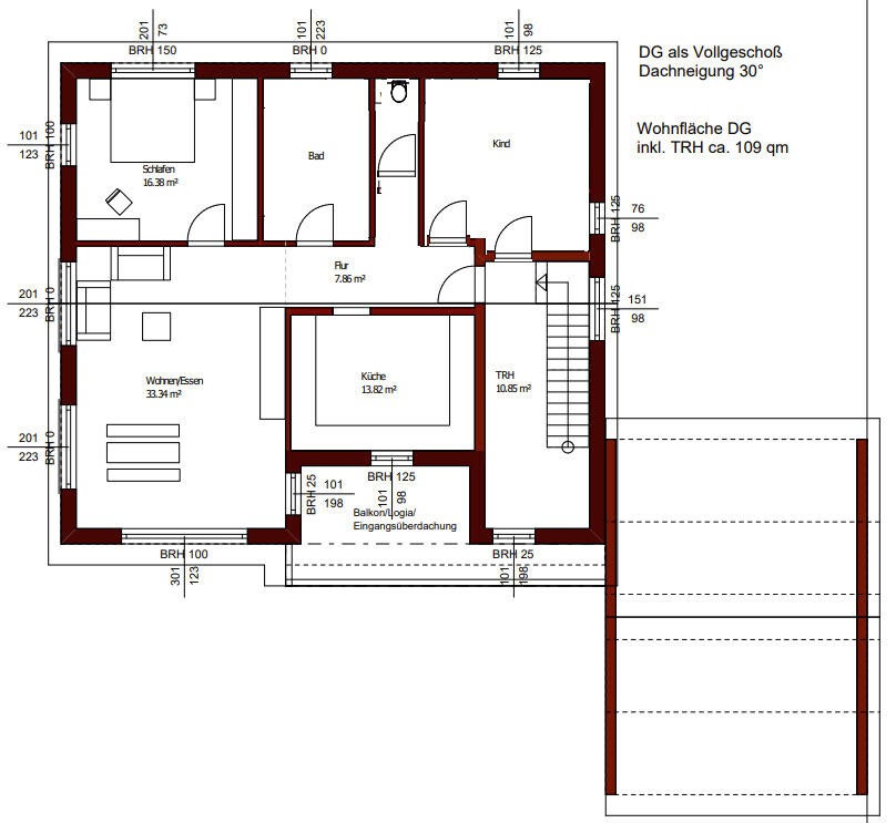

3. I have also considered giving a room on the upper floor two doors so that it can be used by both housing units as needed, see sketch, I edited the picture accordingly myself.
4. Since the plot is narrower at the front than at the back, I have pushed the house and garage further back, also because of the garden on the south side.
Since there is no urgent need, it is difficult to know exactly how it should turn out.
But I definitely want the first housing unit to have everything on one level. Then there is the option to add a basement or a second floor, and I expect the second floor to offer better use at probably the same cost.
2D attic floor plan of a house with bedroom, bathroom, kitchen, and living room

WilderSueden
2 Sep 2023 08:41
Ralf1980 schrieb:
Since there is no urgent need, it’s difficult to know exactly what it should be like.
With that requirement, you can only build something that is neither fish nor fowl.
Ralf1980 schrieb:
Then I inherited this building plot and have already saved some money that I would like to invest in a house before inflation eats up the money.
You have a hammer (the plot of land) and now only see the nail to build something there. Money can also be invested elsewhere. Or you go all in and build a house purely for rental purposes, if that makes sense in the area.
Your children probably won’t live in the house for more than five years. In your early 40s, a few steps might sometimes be annoying, but that’s no reason to build a different house.
haydee
2 Sep 2023 11:02
@WilderSueden is right. This way, it ends up being neither one thing nor the other. You need to decide whether you want a two-family house or a single-family house. At the moment, you have a suboptimal two-family house that might, with many compromises, be used as a single-family house for a family with teenage children.
2 Sep 2023 11:31
Ralf1980 schrieb:
Since there is no urgent need, it’s difficult to know exactly how it should be.
You first need to consider whether you are building for yourself or as an investment property and then plan accordingly. Of course, it is possible to build an accessible apartment and use it later yourself.
However, two apartments are not enough for two families. Even for a large family, the design shows a significant barrier, namely the staircase and the separation of rooms.
