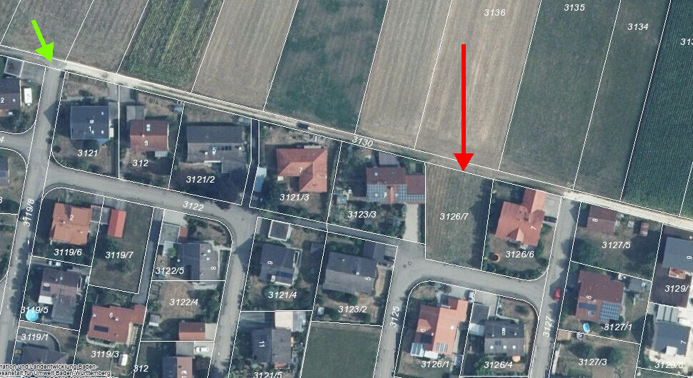

hanghaus20234 Sep 2023 10:25How is the view looking north?
Are there any pictures of the surrounding area?
The plot (red arrow) is located on the edge of the village.
The channel for the expansion of the building area exists up to the green arrow. Many plots north of Grasweg belong to the municipality, but when an expansion will take place is unclear, as is how the houses will be positioned there.
Traffic on the small road on the south side is very low, as all residents drive "south."
I also looked at aerial images from other new housing developments and would say that 60% have their garden facing south, 25% face west, and the rest have gardens facing other directions or none at all.
If I place the house and garage fully to the south, I would be outside the building line and block the view of my two neighbors to the east and west, which seems unfair, if it is even possible.
If I move a few meters forward, the space becomes narrower again and I would have two gardens, but the western part would be shaded by the neighbor’s garage on the west side.
Please feel free to suggest or sketch how a house with an attached garage could be positioned here.
Thank you very much.
Regards, Ralf

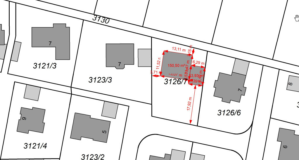

Ralf1980 schrieb:
Feel free to also share suggestions or sketches on how a house with an attached garage could be positioned there. In the third image of this post, you can see the building plot.
I would follow the angled boundary a bit more, especially for a rental property. But basically, I stick to my semi-detached house proposal.
A semi-detached house does not have everything on one level, at least the semi-detached houses I know are two single-family homes joined together. Having everything on one level is a must-have option; otherwise, I can’t consider it for old age.
In combination with a double garage, one semi-detached house would have to face south and the other north, or is that not what you mean?
Regards, Ralf
Regards, Ralf
So, let’s assume we’re talking about a two-family house…
… then choosing a shared double garage is already the less favorable option.
You are thinking too much in terms of “lining up rooms side by side.”
A garden is wherever you decide to establish one.
That’s why the outdoor seating area doesn’t necessarily have to be there.
That’s exactly why you would plan, for example, a garage or carport as a space divider, a hedge as a visual barrier, or a building shape that isn’t just a simple rectangle.
That’s probably the building boundary instead.
Where is the garage or parking space allowed to be placed? What does the zoning plan say about this?
That’s what zoning plans are for. Usually, they regulate this fairly.
See above. A garden is wherever it’s created. It can be anywhere and is often preferred that way. Once in a place where you might spend your days in summer and potentially another area for children to play.
And you said that the ground floor might be for later. So this argument about your wife and children is less valid here.
How, if everything is about the here and now and an all-or-nothing approach?!
There are nice apartments with two balconies, one facing the street and one to the back.
In principle: having the kitchen on the ground floor is a planning mistake and a disruption to the overall layout. So don’t get too attached to your current plan.
