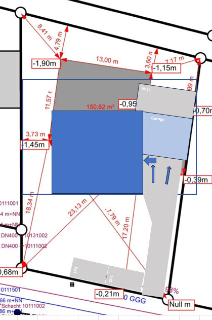

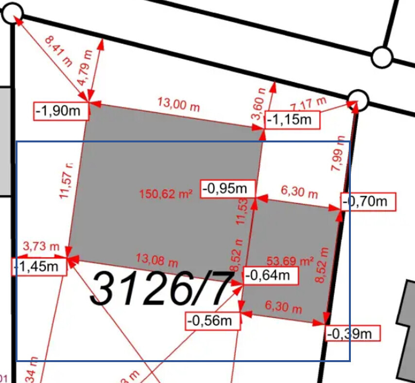

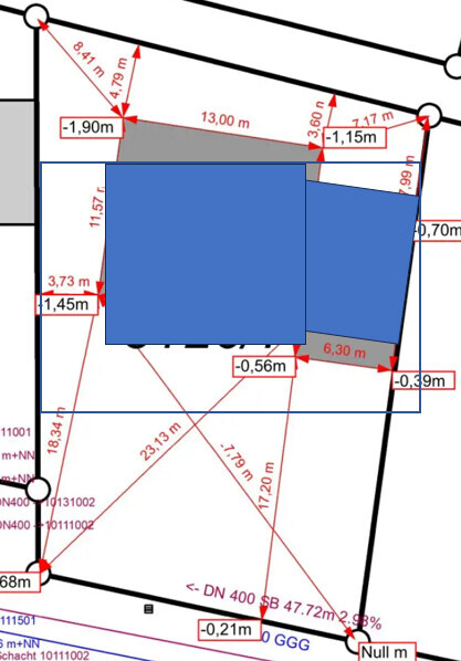

I have a plot of land with a slight slope; the height difference from the front to the back is about 1.5m (5 feet).
For cost reasons, I would prefer to forgo a basement and have as much as possible on the ground floor level. The upper floor is intended to be used either by the children or possibly rented out later, depending on what the children decide to do.
I expect that building upwards with an additional upper floor will provide more flexibility than building downwards with a basement, which is usually less pleasant to live in compared to the same area at ground level.
A large double garage will be built on the east boundary. The neighboring property on that side only has frosted bathroom windows, and the owner (a relative) has also agreed to an easement if the garage is somewhat larger.
Plot size: 814m² (8,761 sq ft)
Slope: approx. 1.5m (5 feet) across the entire area
Floor area ratio (FAR): 0.4
Plot ratio / floor space index: 0.7
Maximum number of floors: 2
Roof style: gable, 30 degrees
Ridge orientation: east to west
Maximum heights / limits: none, the development plan dates from 1980, and various roof and building shapes can be found in this area

hanghaus202314 Sep 2023 11:53Have you already decided on the ground floor height? What have the neighbors done? What does the building authority say? They usually want to set the height.
hanghaus202314 Sep 2023 12:39Ralf1980 schrieb:
How would you evaluate the profitability of a basement compared to grading/fill work or excavation for a basement? For a significant height difference of 1.26m (4.1 ft), the 11ant basement rule (which will be published in eight days at a well-known location) suggests that the basement replacement costs should aim for about 70% of the costs of a constructed basement, meaning an actual basement.
hanghaus202314 Sep 2023 13:11Maybe I see horses everywhere because I have one myself, but why place it so far from the road? That’s a really long driveway/paved access path, which also adds to the cost.

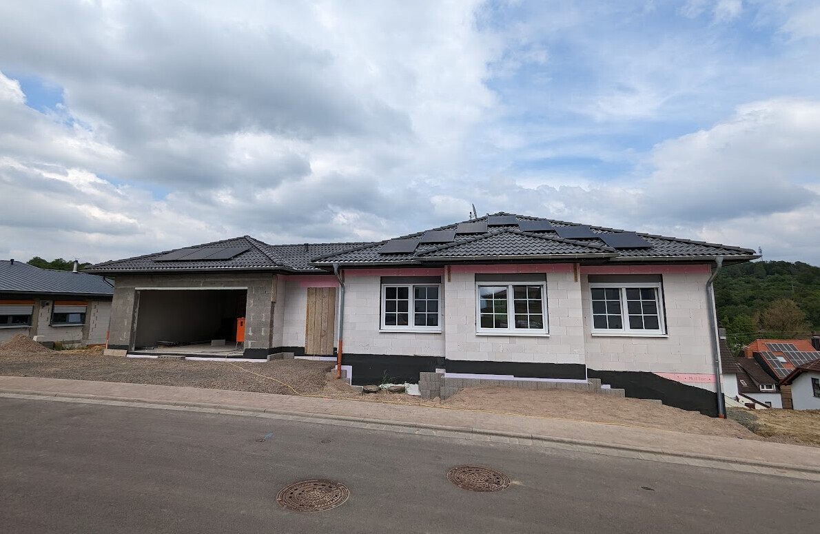

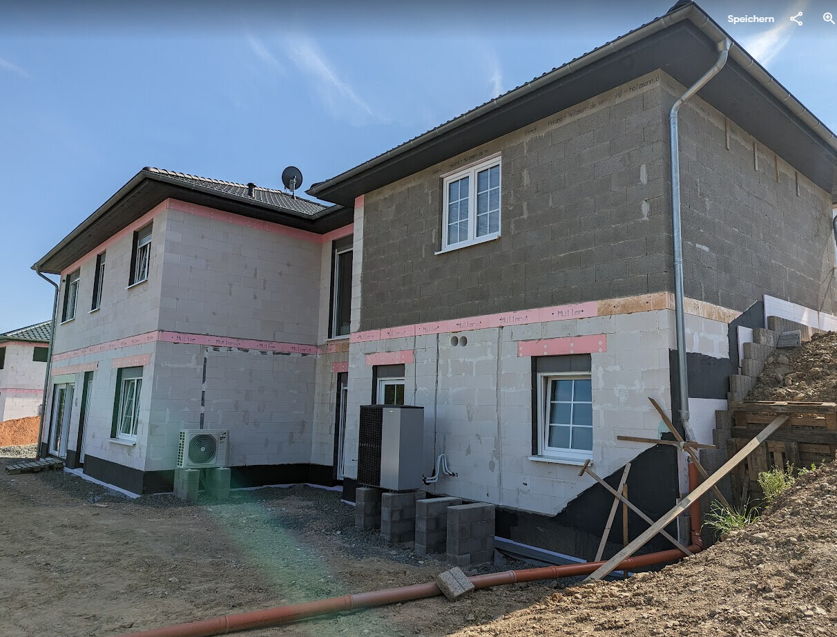

We have a similar slope on our site. We built one floor partially into the hillside. I’m not sure what the technical term is, but when you look at the house from the road, it looks like a bungalow. From the back, you can see both floors.
To get into the living spaces, you go down the stairs. The garden is behind the house. You can access the garden from the living room on a level floor.
I’m attaching a few pictures. We are very happy with this solution. Also, we were able to keep the excavation material on the site. Excavation removal is extremely expensive right now.
