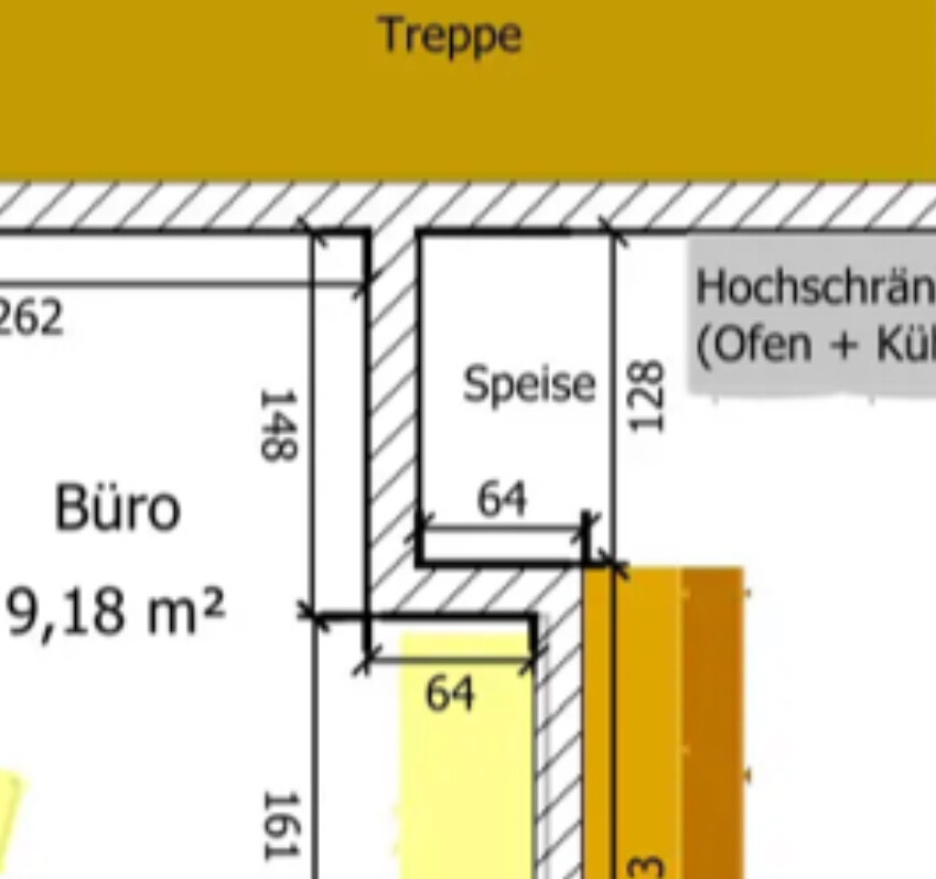

Hello dear community,
we are a young couple (early 30s) with a fairly large sloped plot at the end of a dead-end street, but for cost reasons, we want to do without a basement.
We look forward to your critical feedback on our planning.
Plot size: 900 sqm (approx. 27 x 34 m / 89 x 112 ft)
Slope: yes (see elevation profile image)
Site coverage ratio: 0.4
Floor area ratio: 0.8
Building envelope: 15 x 34 m (49 x 112 ft), 6 m (20 ft) setback from the street
Number of floors: 2
Roof type: gable roof, minimum pitch 40° (does not apply to garages and ancillary buildings)
Style: detached houses only, open layout
Orientation: eaves side facing the street (valley side)
Eaves height: max. 6.50 m (21 ft) on the valley side
Owner Requirements
Basement: no -> Basement cost estimate approx. 90,000 € excluding earthworks is too expensive for us
Number of floors: 1.5 (knee wall 1.60 m / 5 ft 3 in)
Number of occupants, age: 4 persons, 2 adults, 2 children
Space requirement ground floor / upper floor: approx. 160 sqm (1,722 sq ft)
Office: home office
Guest bedrooms per year: none
Conservative or modern design: mixed, rather conservative
Kitchen: combined cooking/dining area; kitchen island optional
Number of dining seats: approx. 8
Fireplace: no
Carport: double carport with storage room
Garden for utility purposes, greenhouse: yes
Further wishes / special features / daily routine, also reasons why certain things should or should not be included:
Planning by: self-designed
What do you especially like? Why?
- Living and dining areas can be separated with a sliding door if needed
- compact family bathroom
What do you not like? Why?
- staircase located in entrance/mudroom area
- limited space for furniture in living and dining areas
- only one roof window in the family bathroom → is ventilation system sufficient?
- bedroom facing southwest
Cost estimate: 450,000 €
Personal price limit for the house including fixtures and fittings: 600,000 €
Preferred heating technology: air-source heat pump and ventilation system
If you have to give up on which details/finishes
can you give up:
- separate dressing room
cannot give up:
- large dining area
- separate living room
- pantry
Number of floors: 2
Owner Requirements
Office: home office
Fireplace: no
- separate living room to have two living areas
- (small) pantry is a must
- technical/utility room large enough for laundry and similar tasks (to compensate for the missing basement)
- technical/utility room with external access (mudroom): for gardening purposes, so dirt does not end up in the entrance area
- family bathroom with double washbasin (more cost-effective and space-saving than separate parent and children’s bathrooms)
- master bedroom with separate dressing room (different waking times)
- possible space for a (small) storage room
- wish: possibility to live on one level in an emergency (office -> sleeping and shower/WC on the ground floor)
can you give up:
cannot give up:
- large dining area
- pantry
