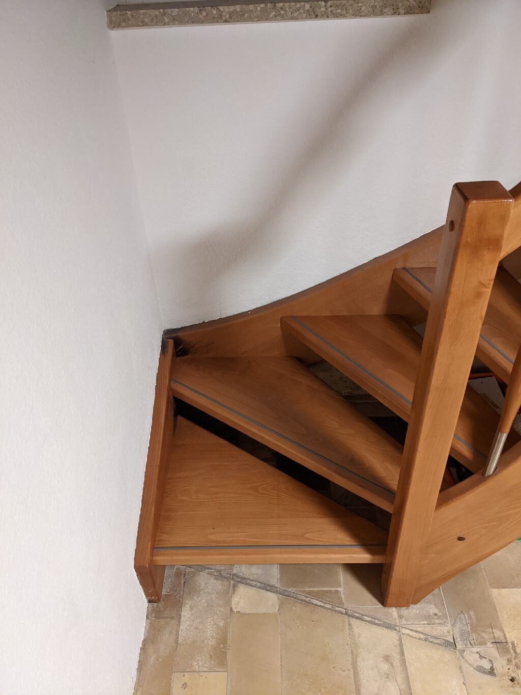

kbt09 schrieb:
I’m not aware of any quarter-turn staircases that end exactly at the orange line; they usually extend about one tread depth further in the exit direction.
Well, I know something like this from my basement:
Whether it’s nice or comfortable, that’s another question.

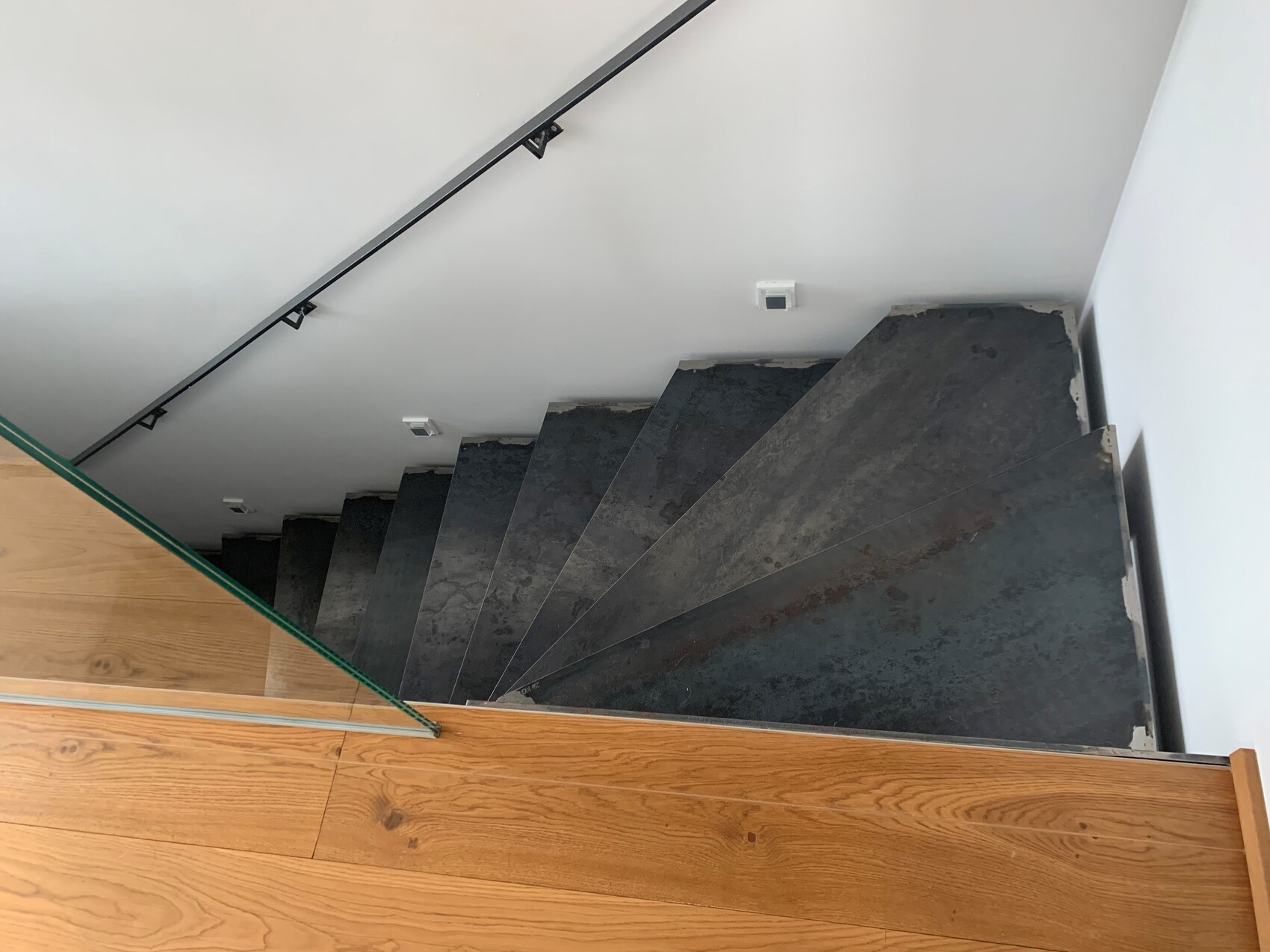

kbt09 schrieb:
@Würfel* .. by 125 cm (49 inches) width I mean the orange-marked corner stub that you also have
![grundriss-efh-ca-190qm-mit-keller-auf-millimeterpapier-571554-1.png"]71287[/ATTACH] <br />
And this corner extension is not taken into account in the floor plan drawing for the basement stairs by @Hausprojekt35, but it would make the area near the slanted wall even tighter. </blockquote> <br />
I meant my basement stairs. They don’t have an extra corner and are really comfortable to use. <br />

[ATTACH type="full" alt="View from above of a dark stone/metal staircase, glass railing on the left, wooden floor at the edge.](/attachments/71494/)
Hausprojekt35 schrieb:
@Würfel* : What do you think about the new version with the open staircase, especially since you obviously have one yourself?I’m not a fan of open staircases at all. I’ve seen it in terraced/townhouses or semi-detached houses where the dining area is always next to the stairs. I just find it uncomfortable to have the staircase in view. Not to mention the odors and noise. My photo might be misleading—I basically have a closed stairwell. So, I definitely prefer the option with the closed staircase :-)In your new living room, I feel there aren’t enough windows. It would be too dark for me. You have such a great view of the forest; there should definitely be a large window there! Put the TV on the small west wall. Do you always just sit on the sofa to watch TV? Looking out into the forest is almost meditative. Simply wonderful.
