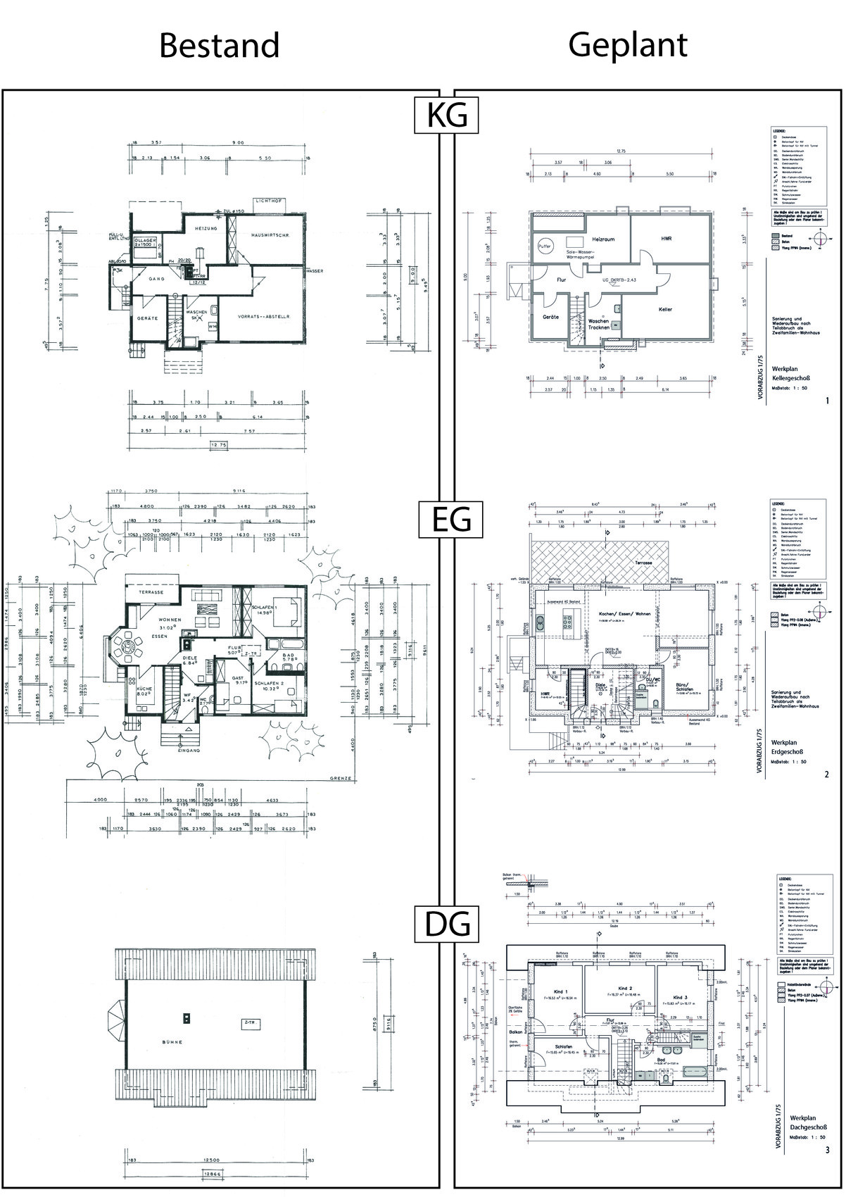

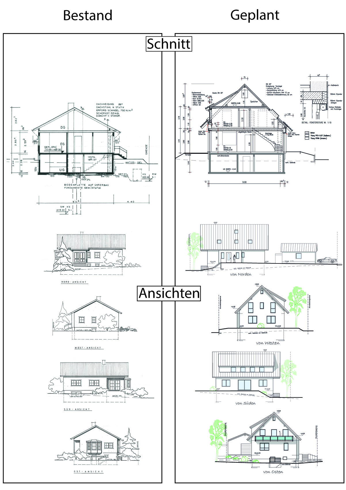

Without much effort and screenshots, it is quite difficult for me to follow what was and what is intended. Maybe you could post the before and after images with the same orientation.

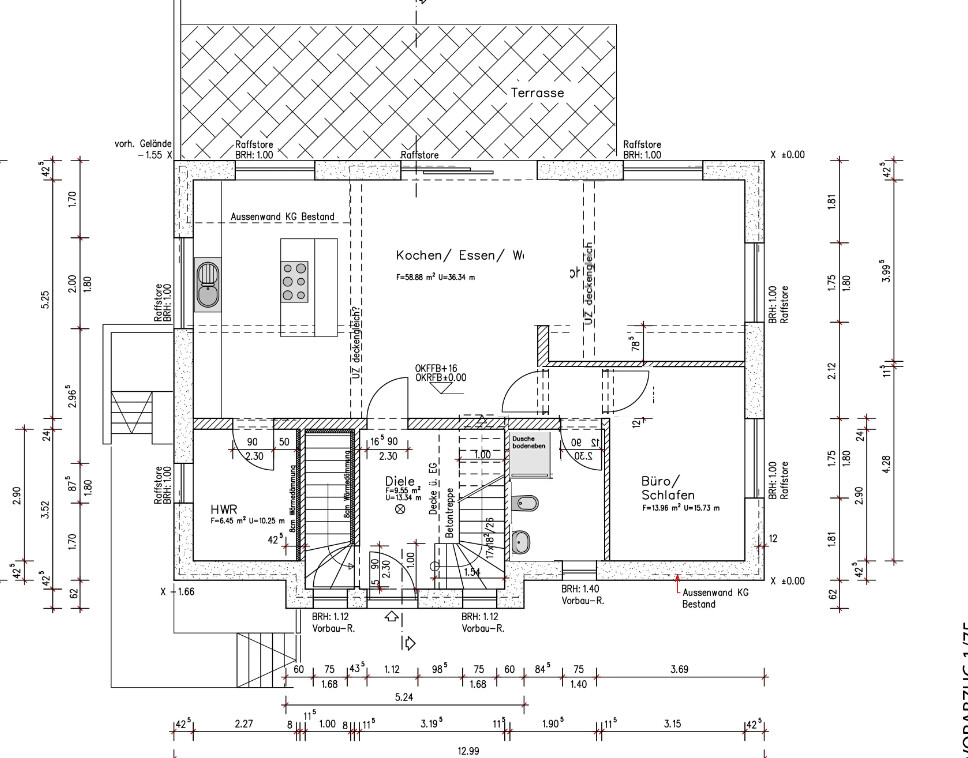

I think it’s quite good overall.
What stands out to me: I would add about 15cm (6 inches) more depth to the bathroom and bedroom. The kids probably won’t notice much, but in the bedroom, this would allow for a large sideboard or an additional wardrobe along the wall. Otherwise, the available floor space feels too tight to me.
I would move the toilet along with the dormer closer to the bathtub to make room for a large laundry basket. The 40cm (16 inches) behind the door probably isn’t enough and will already be used up by a shelf for towels and detergent. With five people, the washing machine runs almost constantly, and in my opinion, the space is far too limited. In principle, it’s a shame that the washing machine and related appliances are in the bathroom, but I don’t see an alternative here without major structural changes.
On the ground floor, my biggest issue is the direct access from the dining room to the guest toilet. I also find the arrangement of the sanitary fixtures quite awkward. I would slightly enlarge the bathroom and arrange the fixtures in a row. Additionally, I would create a separate hallway for better separation from the guest area, so that noise and odors don’t come directly into the dining room.

I’m not sure if this has been discussed yet, and I don’t want to read everything now, but you lose quite a bit of space on the ground floor because the stairs aren’t aligned vertically. Since the neighbor is building a two-story house, I assume it wouldn’t have been a problem to enforce a dormer for the stairs, right?

Without much effort and screenshots, I find it very difficult to follow what was and what is intended. Maybe you could post the before and after views in the same orientation.
Attached is a comparison of the existing condition with our design.
The views are from the approved planning documents, as I currently do not have more recent ones. Details (e.g., window positions) may therefore differ from the floor plans.
Existing (Bestand) and planned (Geplant) building floor plans: basement, ground floor, attic.
Architectural drawing: Existing and planned; sections and elevations of a residential building.

I don’t know if this has already been discussed, and I don’t want to read through everything now, but you lose quite a bit of space on the ground floor because the stairs are not aligned. I assume that since the neighbor is building a two-story house, it wouldn’t have been much of an issue to include a dormer for the stairs, right?
The basement stairs are a bit tricky because the uninsulated existing basement must remain outside the thermal envelope (KfW40). An open stairwell with aligned flights was therefore not possible, and we opted for the solution with separate stairs.
However, I wonder if it might have been possible to insulate between the stairs (i.e., on the underside of the upper floor stairs), essentially creating a “closed” stairwell. A disadvantage of combined stairs would have been the very narrow room in the northeast above the utility room. At this stage, though, we probably would no longer be willing to make such significant changes to the floor plan.
