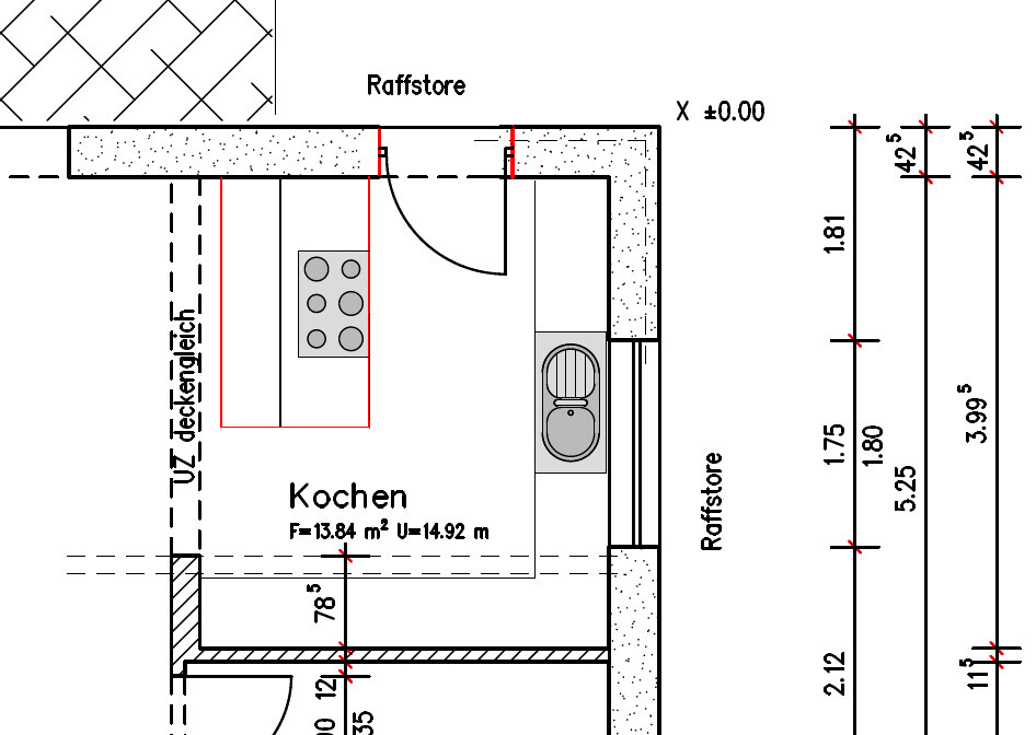

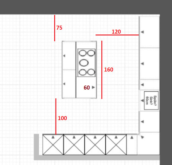

Mal Bauen24 Jan 2024 00:33evelinoz schrieb:
Are you aware that the island is very small? Some would call it more of a side table than a kitchen island.
[ATTACH alt="grundriss-neubau-auf-bungalow-bestandskeller-15-geschossige-652506-1.png"]83825[/ATTACH]Yes, we also noticed that as a downside, which is why we are aiming for a peninsula, as mentioned in post #79. It should look something like this, with an island approximately 2.10 m (7 feet) long:
