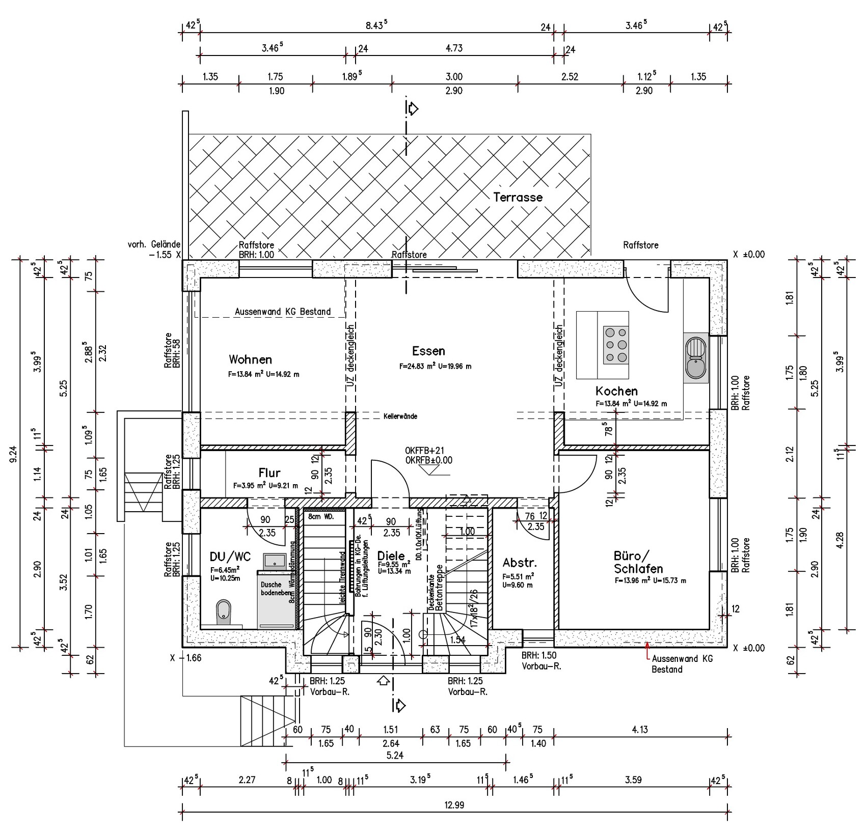

Mal Bauen19 Jan 2024 00:57Professionally drafted by our architect, it looks like this.
What we would still adjust:
Does anyone notice anything else?
Please ignore the arrangement of the bathroom fixtures, they are still placeholders.
- Peninsula against the upper wall instead of an island in the kitchen
- Move the wall between the office and kitchen, as well as between the hallway and living room, 20cm (8 inches) further toward the top of the plan
- Reduce the window seat in the living room to 2.50m (8 feet 2 inches) wide
- Floor-to-ceiling windows for the hallway and shower/toilet
- Thermal insulation on the basement stairs moved inward, toward the stairs
If the walls do not play a structural role for the upper floor, I would not move them. I would avoid floor-to-ceiling windows in all bathrooms. In my opinion, they are also unnecessary in the small hallway. It would be better to use the space for a small sideboard as shown.
Between the living area and the hallway leading to the guest toilet, I would install a proper door. It looks tidier and creates a cozier atmosphere.
Mal Bauen20 Jan 2024 00:30The idea behind moving the wall was that the tall kitchen cabinet row (at the bottom of the plan) would then align flush with the structural wall projection (below the ceiling beam). Visually, this seemed more harmonious to me.
On the living room side, we could also have the TV wall unit flush with the wall, which would give us a bit more space in the hallway for, for example, a sideboard, or just a wider hallway. I wonder if it currently feels too narrow and whether an extra 20–30cm (8–12 inches) in width here could make a big difference.
The structural stability is not an issue with these walls.
Mmh, if you prefer it that way – of course. The space in the small hallway definitely makes things more appealing, but is there still enough room for a sideboard? Maybe rather a 30cm (12 inch) wall shelf.
Personally, I value the 4m (13 ft) wall distance in the living room more. That is my perceived minimum for a house of this size.
I don’t like short wall stubs used only as boundaries. They usually look somewhat cheap and petty, and they take away the feeling of spaciousness. They block a nice sightline along the axis of the room…
I would have kept the toilet where the guest room is and instead built a wall (for privacy, not just a short boundary stub) that could support a mirror or a small dresser. We had that before, and I wouldn’t have changed much about it. This way, the zoning feels fragmented (in my opinion), and if anyone ever needs to use that room for sleeping, they have to pass through the central communal area—so that includes, for example, grandma, who might go to bed earlier when visiting, or a sick houseguest who wants to avoid contact temporarily. On top of that, there’s now a second hallway, which also requires artificial lighting whenever the toilet is used.
Mal Bauen20 Jan 2024 16:00By "short wall," do you mean the thick wall beneath the beam between the living room and dining room? Structurally, it would be easier for us to support the ceiling there. However, it would also be possible to install a column, which would improve sightlines. The space between the column and the wall would then be quite limited. Alternatively, the hallway to the shower/toilet could be shortened, making everything more open.
We are torn between how much zoning or perceived privacy we actually want in the living room. Two homeowners, two opinions.
After much back and forth, the positions of the kitchen and living room are at least fixed. If the room at the bottom left of the floor plan were to become a utility room/storage without a hallway again, you would have to walk through the TV area every time to quickly grab the broom. That was one of the reasons for the current arrangement (others being: a more spacious bathroom, better privacy between living and dining areas, and no need for an overly large utility room).
Regarding your point about reduced privacy due to the interaction between guest/sleeping areas and the toilet, you are, of course, right.
