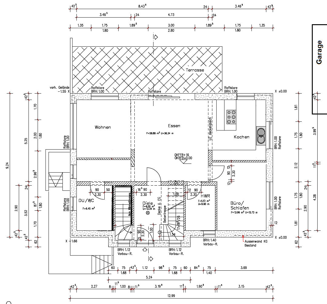

We are still relatively early in our building project and have many fundamental questions to clarify. Nevertheless, I would like to introduce the project here.
We recently became owners of a prefabricated bungalow from Streif Haus, built in 1987. It has a full concrete basement (by Betonkemmler).
Our plan is to demolish the bungalow down to the top edge of the basement and build a new house for our family (currently four, eventually five) on top. The existing basement (very solid construction) is to be integrated as a utility basement including a technical room. At the same time, the heating system will be modernized from oil heating to a heat pump.
Currently, we are in contact with both prefabricated house suppliers (Weberhaus, Danwood) and solid construction companies (Denkinger). The property is located in Baden-Württemberg (southern Baden).
Even though the floor plan is only a first draft, I would like to present it here for feedback (summary below).
In particular, I hope to get some thoughts on the following basic questions:
  • Has any forum member gained experience with building on an existing basement?
  • Is there generally a preferred construction method for our project? We are still undecided whether to go for a prefab timber frame house or a masonry (brick or block) solid construction.
  • So far, we have not discussed a double garage with the builders, but it will be needed. Where does it make more sense: northwest or southwest (directly next to the neighbor’s garage)?
  • To what extent can the project be treated as a renovation with partial demolition in terms of building regulations? Background: Are there any possibilities for funding (still) available?
  • What we want to achieve with the floor plan is short walking distances inside and around the house. Therefore, the main entrance was moved from the north side to the west side. However, since it is on the short side of the house, this results in more corridor space and longer routes inside (e.g., from the front door to the stairs to the upper floor). But as the saying goes, you have to accept some drawbacks — what is your opinion: front door facing north or west?
Here is the summary sheet (key points).
Many thanks in advance for your input, comments, and critiques. I will gladly report further developments here in the thread.

K a t j a schrieb:
Well, if you’re working with lightweight construction on the upper floor, I have this option
That looks great and conveniently includes a larger ground floor bathroom and a separate utility room on the upper floor. Despite using wooden interior walls on the upper floor, our architect insisted that the ground floor walls rest on the load-bearing basement walls. Therefore, we never discussed proposals like yours. Now, I’m not sure if we want to completely rethink our plans. We actually just want to solve the critical areas in our current floor plan but are a bit annoyed that we didn’t think more “outside the box” earlier.
Regarding the knee wall height:
That was a tricky issue as well. We’re glad to have at least 1 meter (3 feet 3 inches); in the first draft, it was only 65 cm (26 inches). The main challenge is the dormer windows on the south side, where the sill height increases with the knee wall. I’ve discussed this in a separate thread: https://www.hausbau-forum.de/threads/kniestockhoehe-bei-schleppdachgaube.45203/

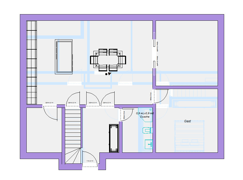

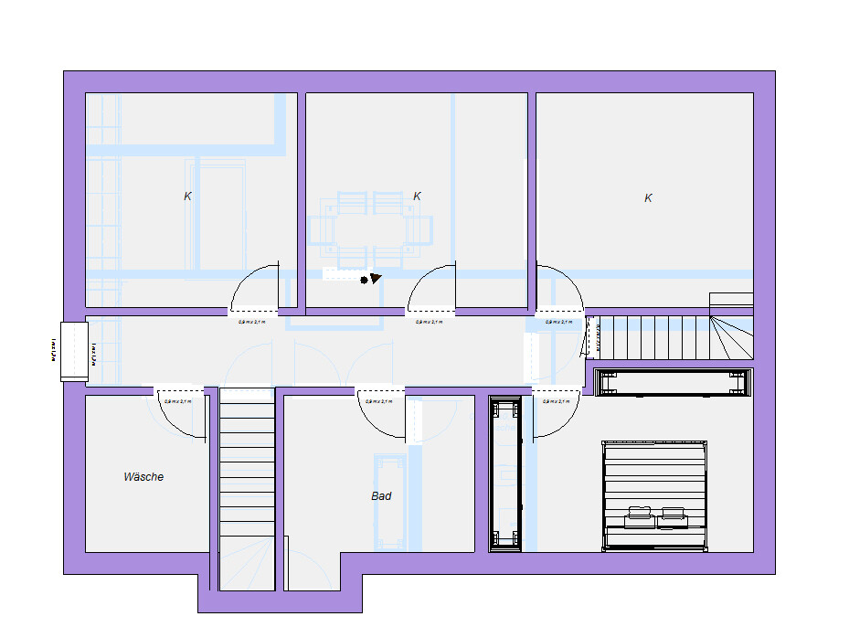

K a t j a9 Dec 2023 09:09
Mal Bauen schrieb:
That looks great and conveniently adds a larger ground floor bathroom and a separate utility room on the upper floor.
Despite having wooden interior walls upstairs, our architect always insisted that the ground floor walls rest on the load-bearing cellar walls. That’s why we never discussed proposals like yours. Now I’m not sure if we want to completely rethink our plans. We just want to solve the critical points in our current floor plan but are a bit frustrated that we didn’t think “outside the box” sooner.
I’ll put it this way: for me, having the access to the guest toilet right next to the dining table would be a deal-breaker. If I’m spending such a huge amount, that compromise would be too big. If the cellar walls can’t “support” all the walls, then maybe rotating the cellar staircase is a feasible alternative. That way, the cellar layout stays almost the same, except for a new passage at the top of the stairs and blocking up the old stair opening. The current washroom would become the stairwell—which I think is manageable. If necessary, the plumbing could be moved to the neighboring room, which would be on the same wall. But the laundry is moving upstairs anyway—maybe something like this:
Floor plan: stairs on the left, dining area in the middle, guest room on the right, bathroom with shower, purple frame.
2D floor plan of a house with kitchen, bathroom, laundry, stairs and hallway

Mal Bauen
9 Dec 2023 15:53
K a t j a schrieb:
I would say this: for me, having the entrance to the guest bathroom right next to the dining table would be a deal breaker. If I’m spending this huge amount, that compromise would be too much for me.
At first, the inconvenience of the guest bathroom entrance seemed small and acceptable to us. The longer we think about it, the bigger it now seems.
Thank you for this additional creative suggestion. One of the dogmas of our previous planning was also not to alter the basement; in hindsight, we should have allowed ourselves more flexibility there as well. Considering the short time until construction starts in March, we will stick to our floor plan and implement your solution for the guest bathroom from post #57.
K a t j a schrieb:
Whatever you told yourselves, that’s complete nonsense. You’re building a new house! The zoning/building regulations don’t restrict you from freely choosing the knee wall height. So just do it! The appearance of the dormer is priority 250 compared to the knee wall height, which is somewhere around 10.
For the dormer, it was less about appearance and more about the concern of having the window frame right in front of the kids’ rooms on the south side. This has since proven to be unfounded. The parapet height is approximately 94cm (37 inches) above the finished floor height at a knee wall height of 1m (39 inches). We could actually raise this by 25cm (10 inches) to a parapet height of 119cm (47 inches) at a knee wall height of 1.25m (49 inches). I’m not sure how strictly deviations from the eaves and ridge heights specified in the building permit/planning permission are handled. Ideally, I should adhere to those measurements.

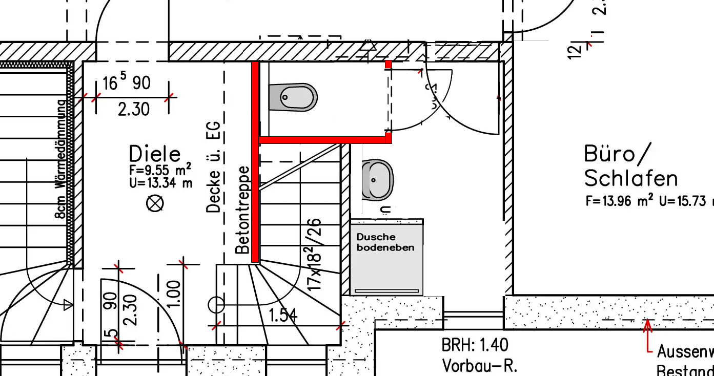

K a t j a10 Dec 2023 13:38
So perhaps it could also be considered to separate the toilet in the bathroom by placing it under the staircase (if there is enough headroom).
Floor plan of a house: hallway, stairs, walk-in shower, office/bedroom.
Then use an effective exhaust system to vent odors outside. With custom-fit furniture and a standard corner shower, it can even look quite nice. It would of course be nicer if the toilet door could open inward, but I cannot assess that with Photoshop.
Mal Bauen
3 Jan 2024 10:22
Thank you for the additional suggestion @K a t j a.
The clear headroom would be between 2.58m (8 ft 6 in) at the top and about 1.90m (6 ft 3 in), 1m (3 ft 3 in) further along the staircase slope. That would be quite tight.
Over the holidays, we took another good look at this floor plan. We like the upper floor as it is, so we won’t be changing the staircase. However, we are still uncertain about the ground floor, especially regarding the placement of the WC (privacy) and the kitchen, also inspired by input from @K a t j a and @ypg (post #67). Our architect planned the kitchen to face the quiet east with a view, and the living room towards the garden, street, and property entrance. If we rotate the layout, it could look like this:
  • The living room would be on the quiet east side, with a nice view (large floor-to-ceiling window or window seat instead of a narrow kitchen window)
  • The kitchen would be closer to the garden/garage/property entrance and could have its own house entrance (directly from the garage for groceries)
  • By swapping with the utility room, the WC/shower would be more secluded from the dining area and a bit larger. The utility room can be smaller since the freezer would move into the kitchen (there is slightly more space there with the L-shaped layout plus a half island than before)
Disadvantages: The large open-plan living space would be divided, resulting in a long, narrow corridor leading to the WC/shower.
Of course, this is a last-minute spontaneous idea from us. Construction is scheduled to start in March and the quotes for the shell are already in. The structural engineer is probably already calculating (I can’t reach him right now). Drainage including ventilation still needs to be checked but seems feasible. It’s not cost-neutral: larger WC/shower, more kitchen cabinets, more walls.
What do you think? Is this a meaningful improvement over the current plan?
