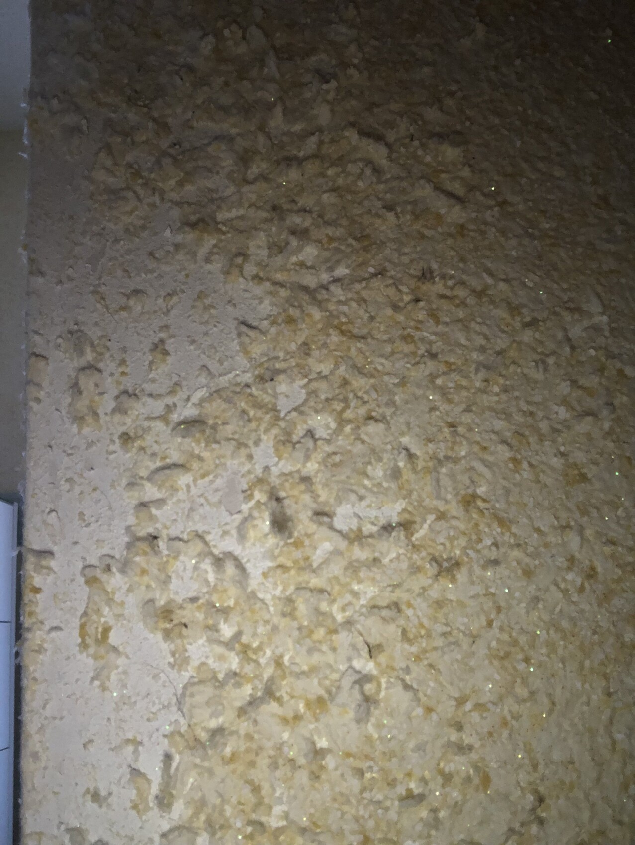

driver55 schrieb:
Cotton-based plaster applied with a plastic trowel. A special primer must be applied beforehand.
This is how our entire staircase is done. Could you please show a picture of how that looks? 🙂

driver55 schrieb:
doesn't really come across well…Actually, it looks quite clear. Is it possible to paint or color it before applying?
I'd like to get a sense of the texture's scale. Is there a photo with a chair, picture, flower, or something similar for reference?
