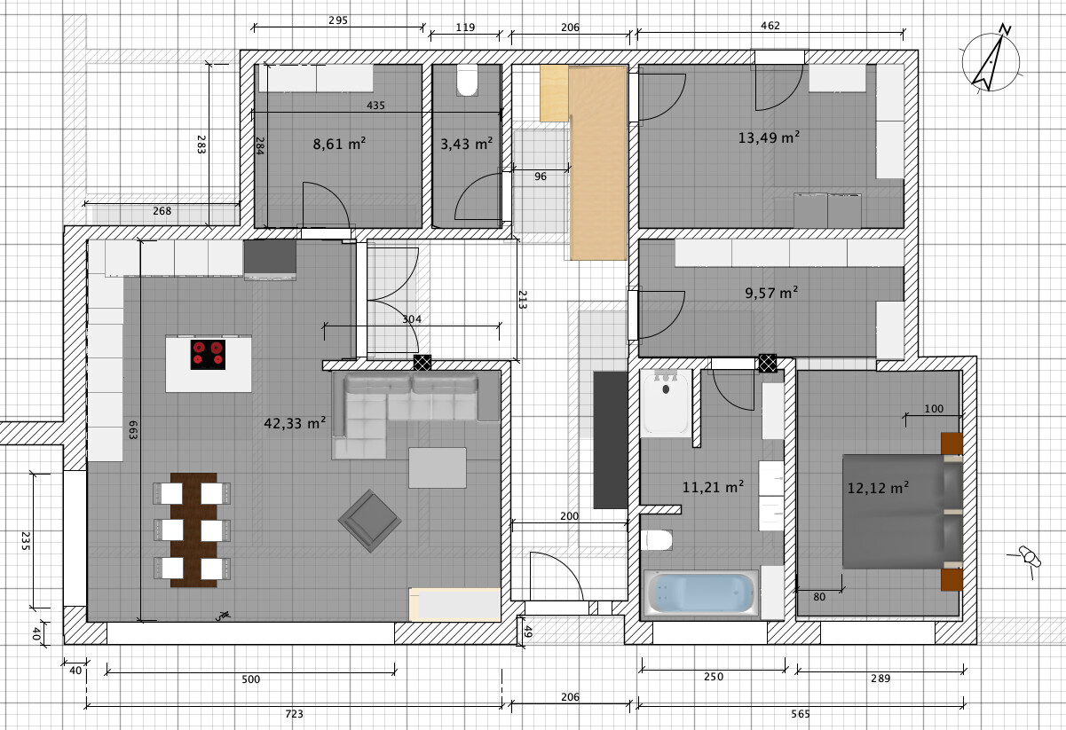

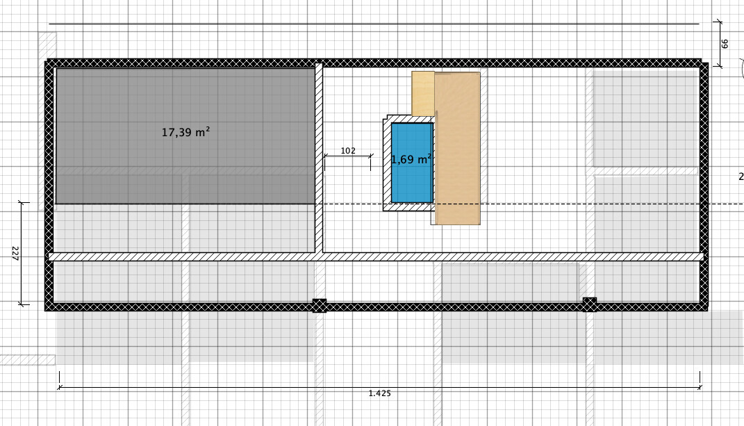

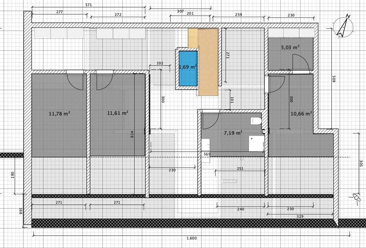

derclaus schrieb:
Ah, yes, of course. Thanks. It’s basically logical, but I missed the m2 (square meters). :p I’m sitting at the hairdresser’s... not much typing possible here :pHow time flies... but of course, I don’t want to leave you without an update on the current status. Sorry for not providing any updates recently, but there simply wasn’t much progress (and no decisions) to report.
Regarding the house-barn conversion, things are finally picking up speed: next week the remaining laundry room will be demolished, then the foundation including strip footing (for the exterior wall that still needs to be relocated) will be laid, and the roof renovation will begin... Of course, for the foundation, the positions of the toilet, shower, kitchen connections, etc. now have to be finalized. And for that, there is now the (new) concept for the ground floor and also the upper floors. Basically, I have a very good feeling about this concept—it could work well.
The staircase has now been moved to the back. The reason for this was ultimately that the chill-out area with TV room at the very back as a combined space was considered impractical. Especially with three small children, reading and cuddling during the day—the room would not be used (at least not in the way we live). So we decided to change the combined space and move the chill area of the living room forward, even though this makes the combined space smaller. Unfortunately, it was no longer possible to keep the guest toilet at the front—the restriction on the south side allowing only 1 meter (3 feet) width for the left-side wall prevented this. Finally, we had to choose between a larger master bathroom or a smaller bathroom with a guest toilet—the decision was for the larger bathroom. Drawing in the wall thickness to be used (+-17.5cm (7 inches)) plus a maximum of 1 meter (3 feet) outward gave the final answer: the toilet has to go upstairs! 😎
(@ypg: I know your concept with the staircase further forward would have worked too, but with these restrictions, it just doesn’t fit anymore given how we see our daily and evening routines. Nevertheless, I really appreciate your efforts and thank you again!)
I’ll just leave the screenshots here without comment for now—even though there are plenty of comments or explanations that could be made. More on this later. Also, the layouts for the first floor and attic are not yet finalized regarding the staircase. There is still work to be done. 😉
Ground Floor (GF) – First Floor (FF) – Attic Floor (AF)
But if anyone wants to say anything, go ahead! That’s what we’re here for, and I’m happy to take any input! 😀

Wow, everything is new!
I have to admit, I don’t quite understand the entire left ground floor. Your explanations are fine, but the placement of the bathroom and utility room doors is not clear. Neither is the recess in the open-plan area with that “anteroom”... But if you like it that way, then that’s what matters 🙂

icandoit schrieb:
Where are the windows on the upper floor and attic?
Are they all double casement windows?All are double casement windows, two per room and two in the open area.
