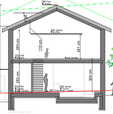

- 1. On the ground floor, the living/dining/kitchen area seems small in relation to the overall house. Recently, we extended the house by 30cm (12 inches) to enlarge the children’s rooms on the first floor. As a result, the guest area also gained 30cm (12 inches). We would prefer to allocate these 30cm (12 inches) to the living room but have not yet received feedback regarding potential additional costs due to structural or load-bearing issues, as the vertical walls on the GF/FF would no longer align.
- 2. Upstairs, we are happy to have symmetrical children’s bedrooms. The hallway (shown in green) will be open to the roof and illuminated by skylights. The children’s rooms will have a gallery where, for example, beds can be placed. Attached are two alternatives for the first floor. They differ only in the access to the children’s rooms: “rectangular” or “diagonal.” In the diagonal variant, the children’s rooms gain about 1.3 sqm (14 sq ft) of floor space, while the gallery loses some space. Additionally, with the diagonal option, there is the question of whether the hallway height above the children’s room entrance doors should be continued or closed off, which would benefit the gallery spaces in the children’s rooms. Our planner has a strong opinion here but also acknowledges the advantages of the opposite. We would really appreciate your opinion.

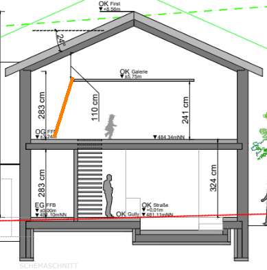

kbt09 schrieb:
I agree with the previous commenters and suggest creating a sectional drawing to better assess the planned loft spaces in the children's rooms. It would also be useful to plan where the access points to these lofts will be located. Similar topics
