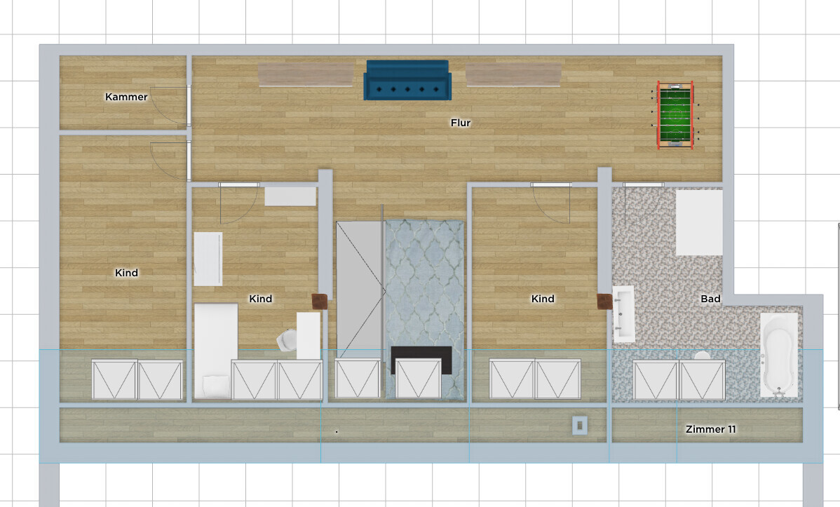

Current Status UPPER FLOOR
So far, I have only worked roughly on this level since I am still not satisfied with the ground floor layout. I have attached a rough draft for the three children’s rooms and the bathroom.
It is important to note: at this level, there are additional supports branching off from the mentioned pillars, running diagonally from the floor to the ceiling toward the north, which cannot be removed either. In my opinion, these should be incorporated into the walls. A door could be installed at the outer edge of such a wall. But we have not reached that point yet...

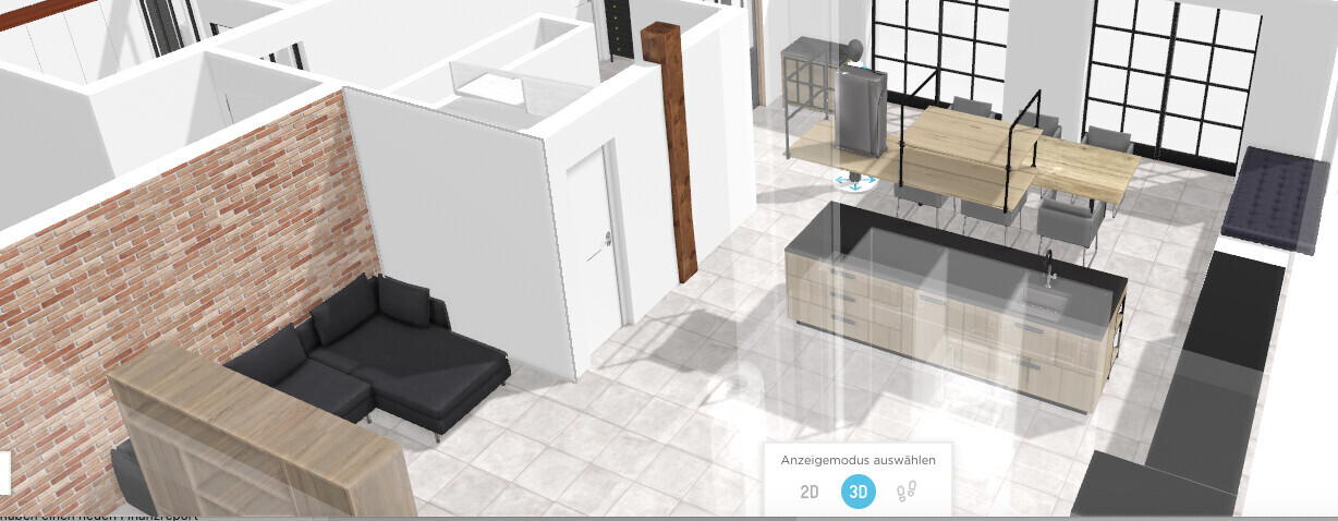

Open kitchen, kitchen island: open kitchen, kitchen island
Number of dining seats: at least 6

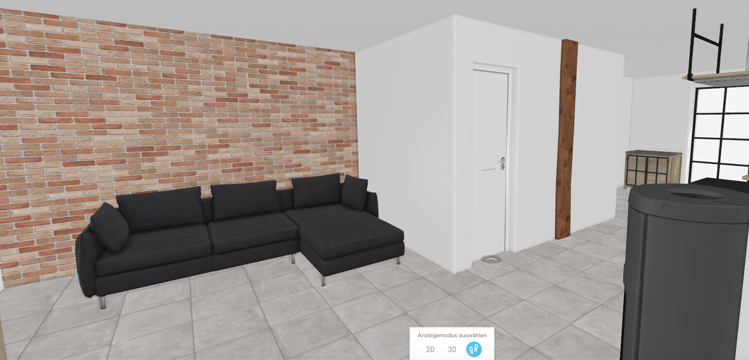

Fireplace: yes, in the living-dining room, preferably on an exterior wall

- The big question is whether the living room should extend to the rear wall. I think there's still light there, but I don’t quite know how to best use the space. Or should a staircase be placed behind it?
- The access to the living room is unclear to me. On one hand, we prefer it to be closed off; on the other, keeping the option to open it up sounds interesting—possibly with a sliding door.

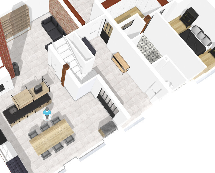

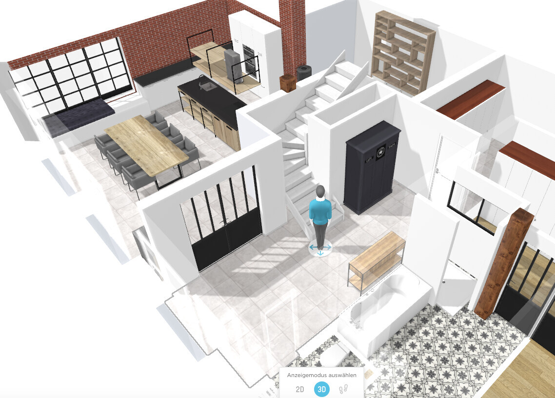

Söööö,
here’s another concept. The concept is good.
Wow! I’m impressed and once again think: this works and even more… it looks great, very harmonious both upstairs and downstairs. I’ll take a closer look again and write something about it tomorrow. There are so many things I really like and I’d like to note down tomorrow what appeals to me.

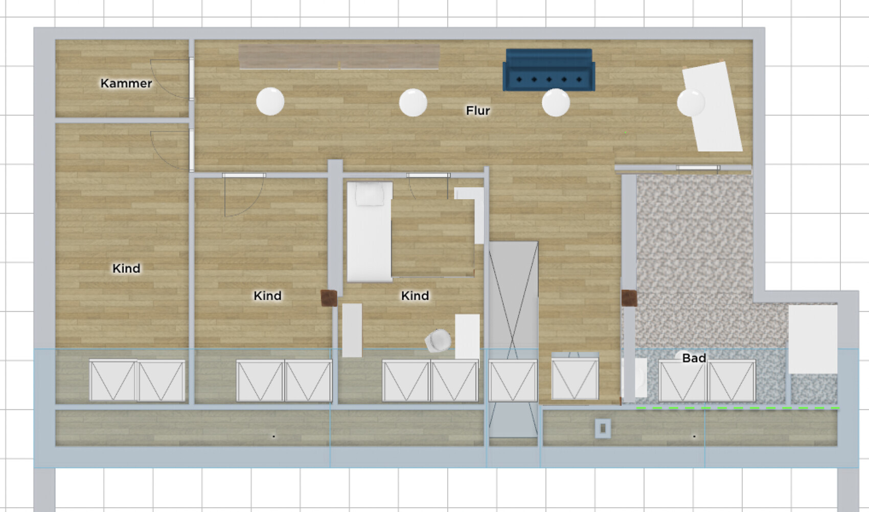

What I just noticed in the upper floor, among other things regarding the lighting:
Would it be possible for Bien-Zenker to access it differently, extend the hallway toward the south, and bring more light inside with a second double casement window or a dormer window — would that work?
Sure, that would make the hallway a bit large, but if necessary I could just put an elliptical trainer there. Or simply look out the window from time to time. Or maybe a small desk with a view of the garden.

Regarding the bathroom: I initially had it like that too, but I found it disproportionately large. Bathrooms that feel like dance floors aren’t very cozy or inviting; they tend to feel more like wash halls.
And I kind of fell in love with the work nook 😉 You also have to make sure the timber frame wall on the right side is showcased somehow. Maybe the timber frame will stay exposed and not become a regular wall?

Oh yes, and then there’s the fireplace question (I knew I’d forgotten something 🙁)

Coordinate this with the location of the windows on the ground floor?
Your suggestion of having a slightly larger entrance hall could also work.
