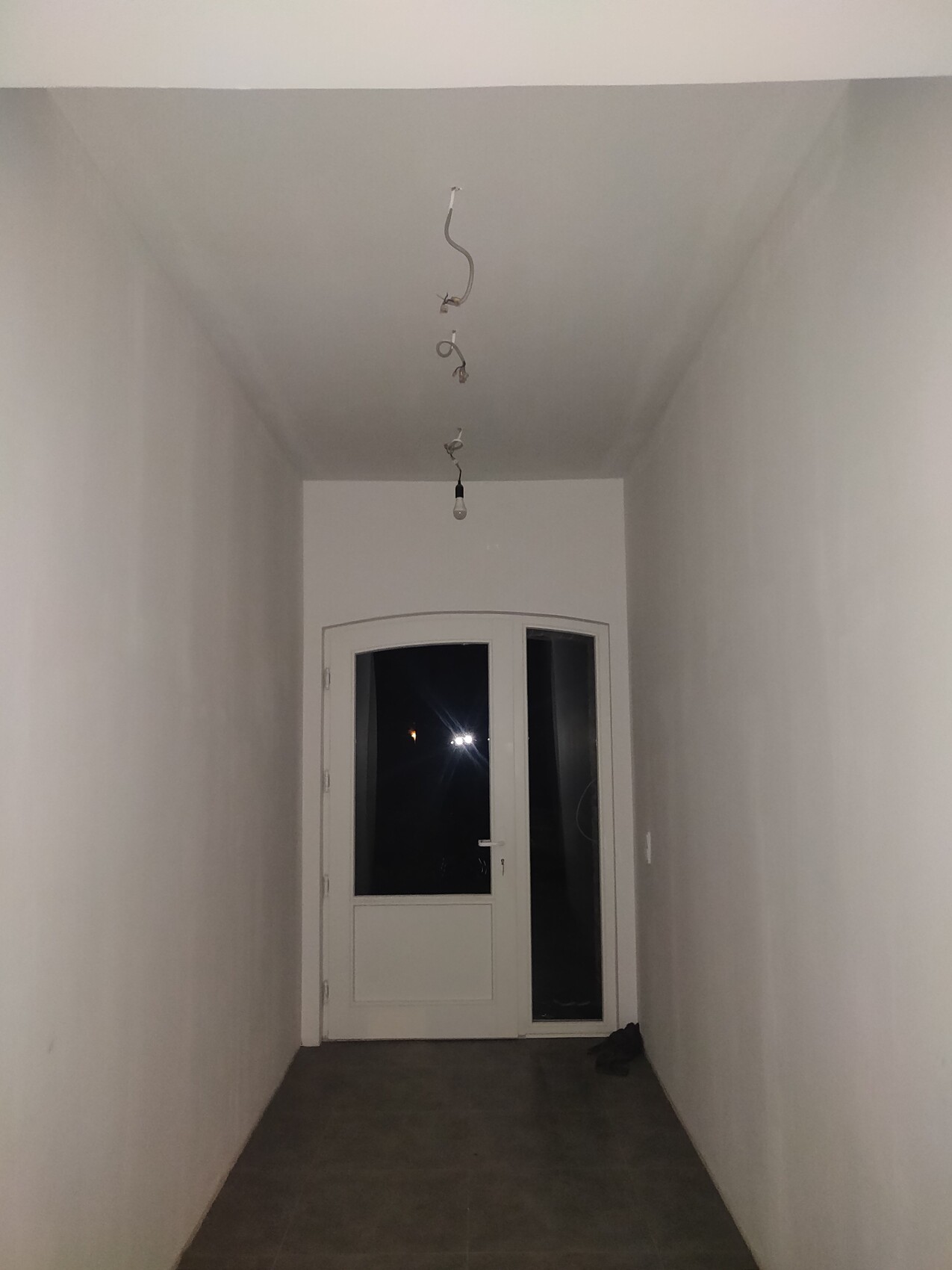

Construction is progressing rapidly.Hello, how is your new home coming along? Are you already living in it?H
hanghaus202324 Nov 2022 16:58ypg schrieb:
Hello, how is your new home coming along? Are you already living in it?They are probably still very busy with it. I would be interested to know as well.H
hanghaus202325 Nov 2022 08:32Great, thanks. Was there also an update to the floor plans? What remains of @ypg’s designs?
