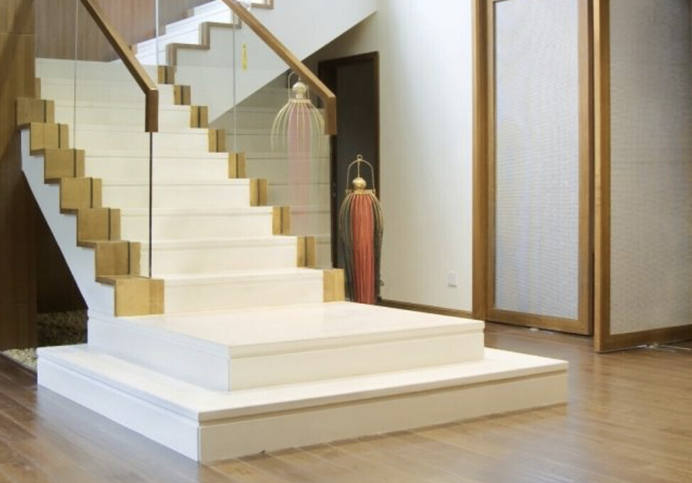

By moving the living room wall, the entrance to the staircase is much better designed.I agree. You could make the first step wider so that it can be approached from different angles. Something like this is what I mean (even though I don’t like the style, yikes 😉).
