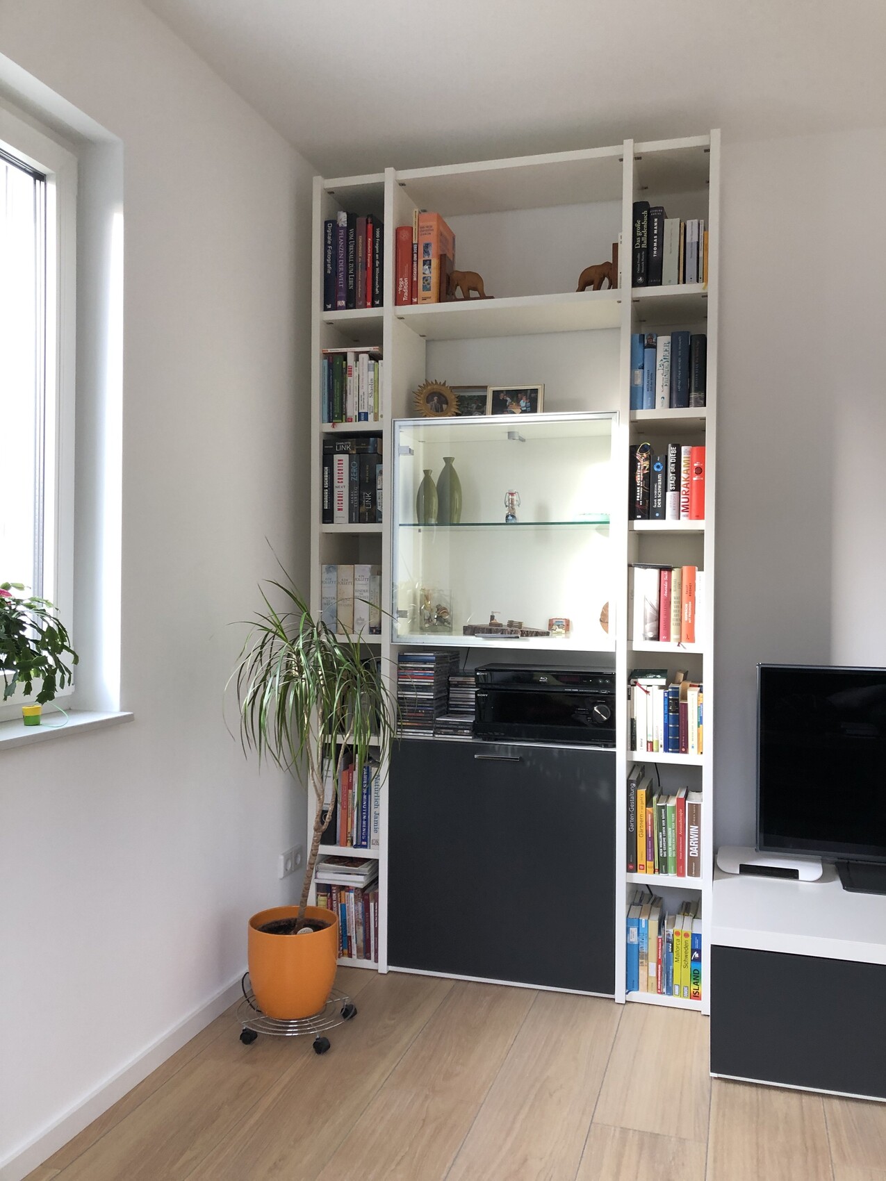

But we still don’t have any pictures of that.I can gladly take some pictures and upload them. The grouper turned out pretty well.chrisw81 schrieb:
Unfortunately, as a "home planner," you are often overwhelmed with trying to imagine and simulate all possible scenarios. [...]
And it’s precisely those small details, like the width of our sliding door, that later make all the difference in how comfortable living in a house can be. [...]
because you spend 99% of your active time in the living room. That’s where 99% of the planning effort should go. Other contributors mainly bring their own life experience to the table—and don’t have a crystal ball showing yours. For me, the foundation of the day is that it starts well; in that sense, the center of my planning world is my bathroom window. I’m sitting here in my imagination next to Yvonne, envisioning a homeowner of the “relaxed lord of the manor” type—because I also consider it a misjudgment that only 1% of the spouse’s free time at the living room, the center of the universe, goes toward laundry logistics. So, do you really think we owe you a poorly sized sliding door?

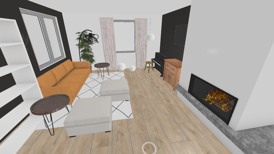

kaho674 schrieb:
Your original post doesn’t mention a piano, nor is one visible. We only found out about it after the house was already built. So you can keep that black mark. A piano, a piano! Our thanks for early notice of that would surely have traveled all the way to Massachusetts.

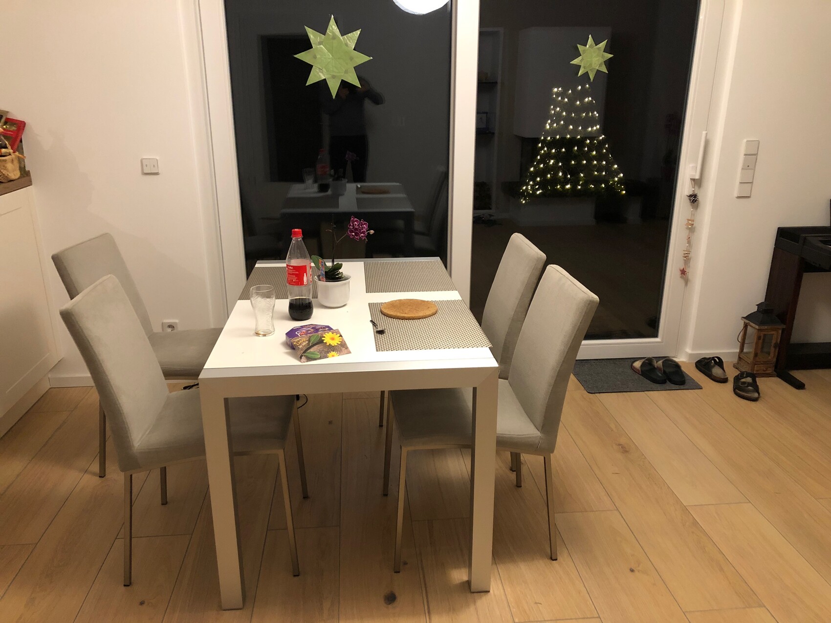

But we still don’t have any pictures of that. And the little table isn’t the same one you have, right? Looks like the model furniture from the draftsman. Attached is a picture of the dining table situation:
The table is still too far to the left here, but this way you can easily reach the sliding door. If it is lengthened, it needs to move further to the right (at least 40-50cm (16-20 inches)) to still allow good access through the kitchen entrance, otherwise it would block the way.
So comfortable and “open” is something different. Maybe a round table actually makes more sense, or a very short one that can be extended a lot.
The next picture shows the window situation in the living area. I feel the windows appear quite lost here and perhaps they should have been arranged differently or made larger. Especially above the sofa it looks a bit small.
Well, there will be a corner sofa here that will reach up to the small window, as well as pictures and so on, so maybe that will help.
Unfortunately, the situation with the neighboring house was quite difficult to create something larger on the west side.
Overall, everything feels a bit wall-heavy; more or larger windows would definitely have been better.

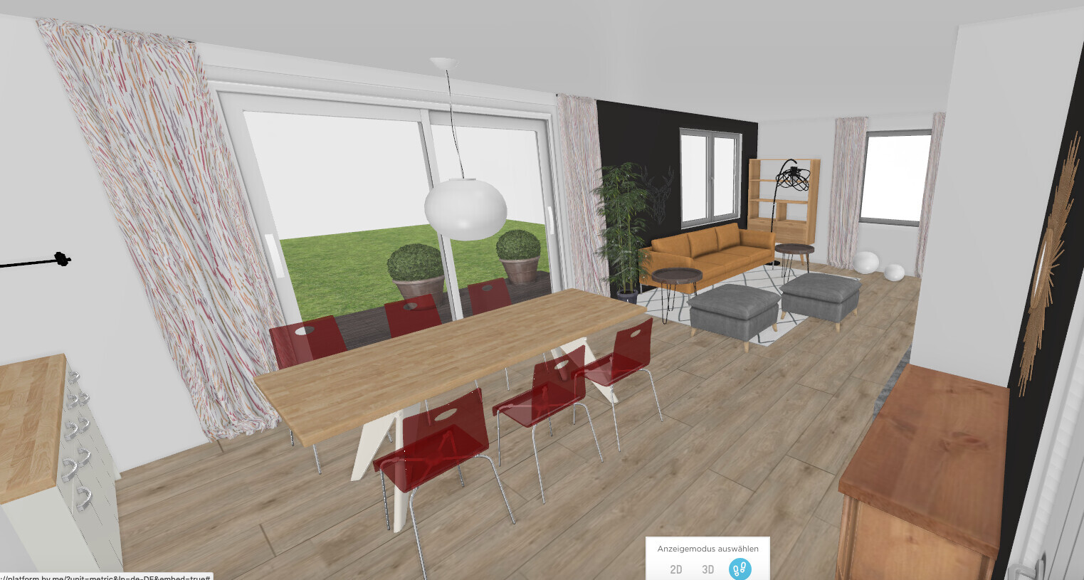

chrisw81 schrieb:
The next picture shows the window arrangement in the living area. Here, I find the windows look rather lost and perhaps should have been arranged differently or made larger. Especially above the sofa, it seems a bit small. You really wanted the windows stacked vertically... and to have a smaller living room...
I have to admit, it’s not my style.
But I’m not planning for myself, I’m planning for the original poster, and you already had the preliminary design from the architect. The dimensions were more or less fixed since you only wanted to spend 200,000 on the house.
I don’t interfere much with window sizes or external dimensions, especially if it’s clear that 150cm (5 feet) windows are wanted or the window sills... For me, low sills are fine and good for privacy, for example on the upper floor. And the external dimensions ultimately reflect the budget.
A lot can be achieved with more money. I would say you have fully utilized the 200,000… or how much did it end up costing? That would be interesting to know. If you had increased one meter (3 feet), perhaps an extra 20,000 to 30,000 would have been added.
I think many things have probably turned out well that you might not even realize right now. What would happen if the hallway or utility room didn’t work???
