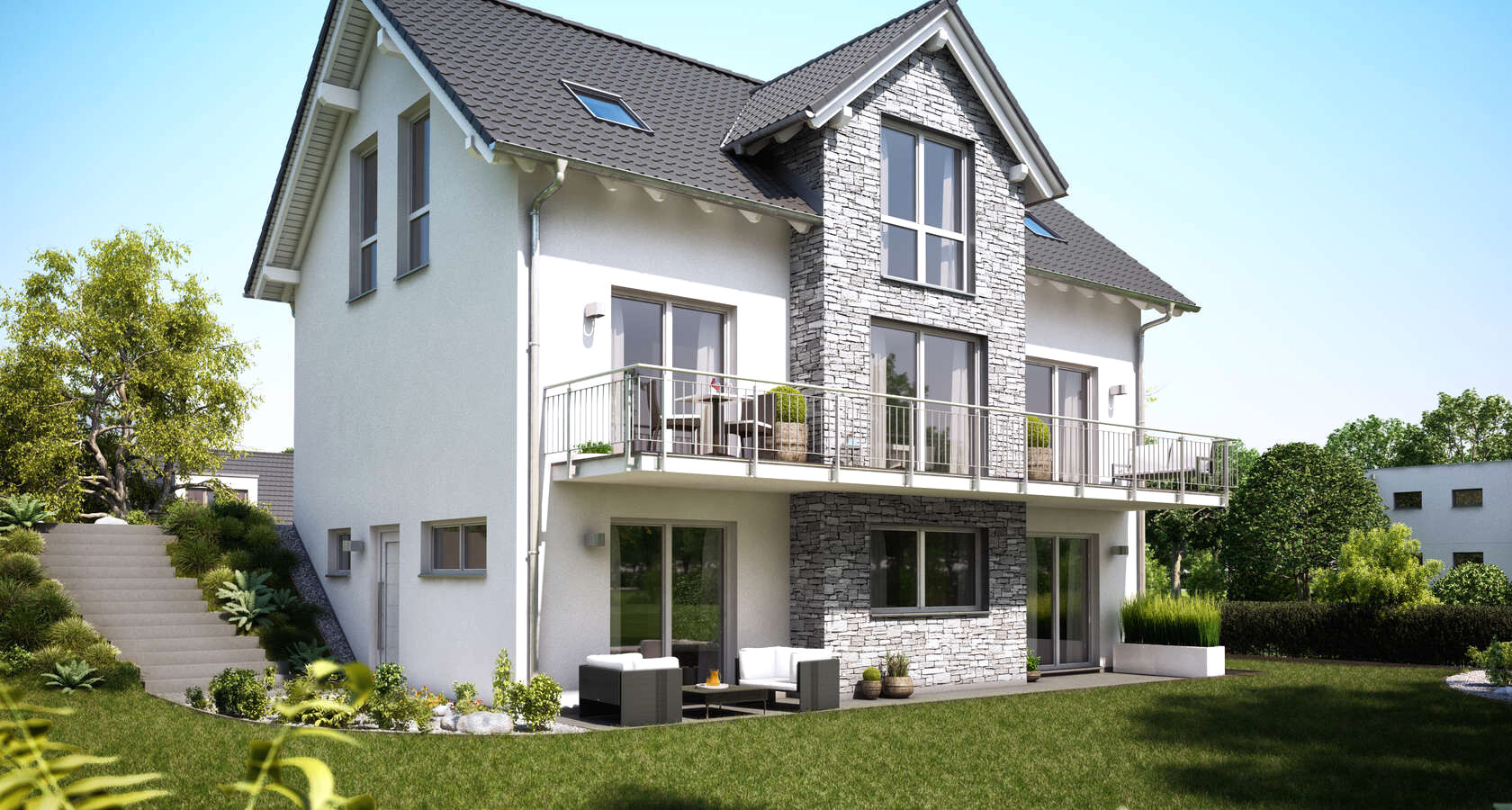

Hehe, I just did the latter. Not sure if that was such good advice:
I know what you mean.
But these are houses in a completely different price range, where you can really make something out of it.
Not in the budget version though...
Although: I’m open to being pleasantly surprised.

haydee schrieb:
Take a look at the Opta hanger house HA 140
Definitely not a standard suburban villa. But does it really count as a 1.5-story design? *slowly rolling on the floor laughing*
