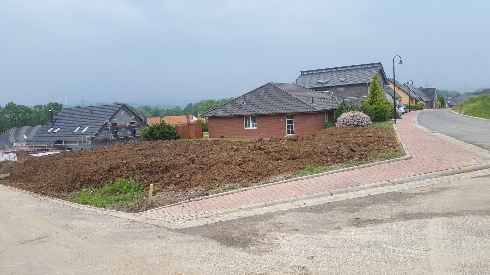

Was the soil just dumped and spread out, or was it properly compacted in layers?
Just dumped, not compacted (for illustration, two photos attached)

Large earth mound on a construction site in front of residential houses in a housing development.
Building plot in a new housing development with earthy construction ground and adjacent houses
