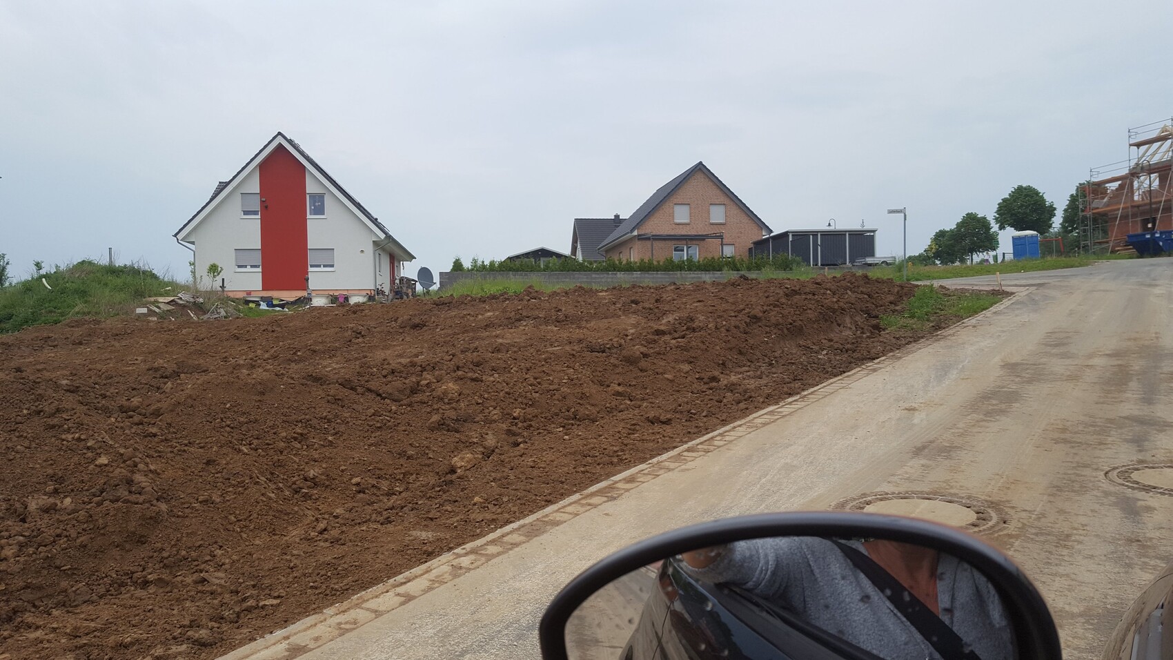

And does it slope evenly downwards?
Over 33 meters (108 feet) down 5.5 meters (18 feet)? Yes, more or less. I uploaded photos earlier (after filling with fill soil) where you can see it quite clearly. I’ll attach another one.
