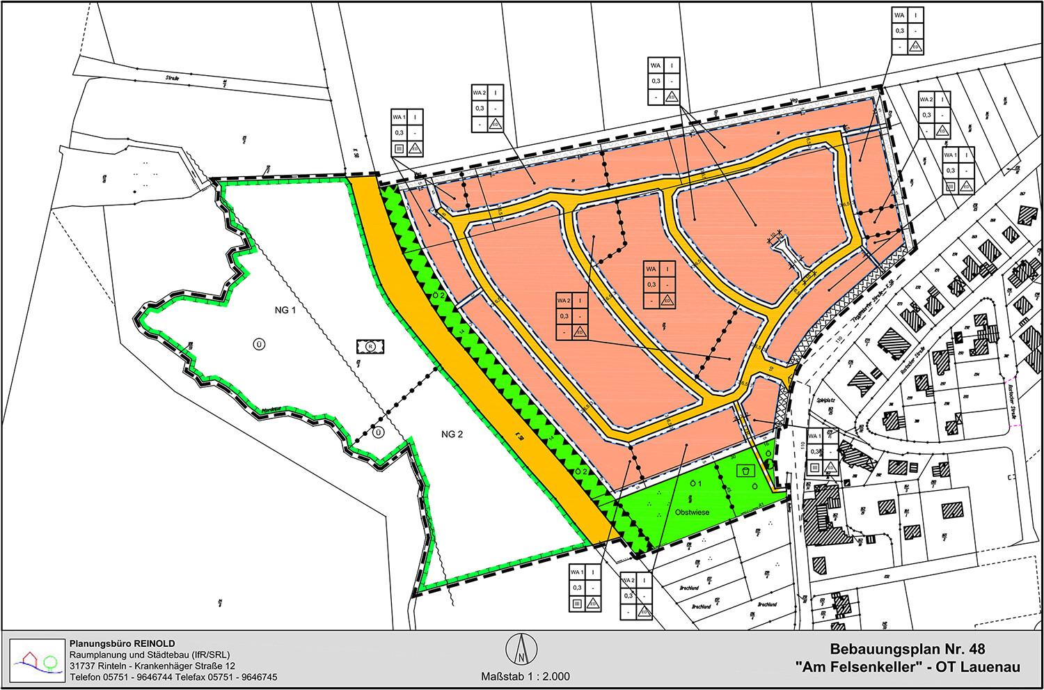

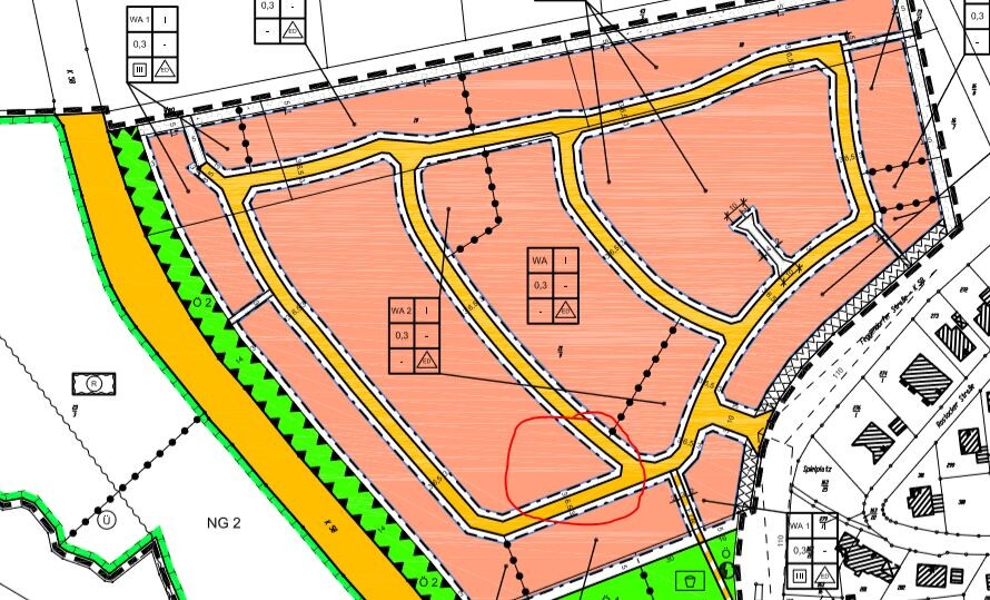

Where exactly is your land located now? Yes, of course... but the PDF file is too large to upload. Which pages do you still need?
My plot is located at the bottom where the light green area is, above the road (the first U-shape, starting at the far right).
