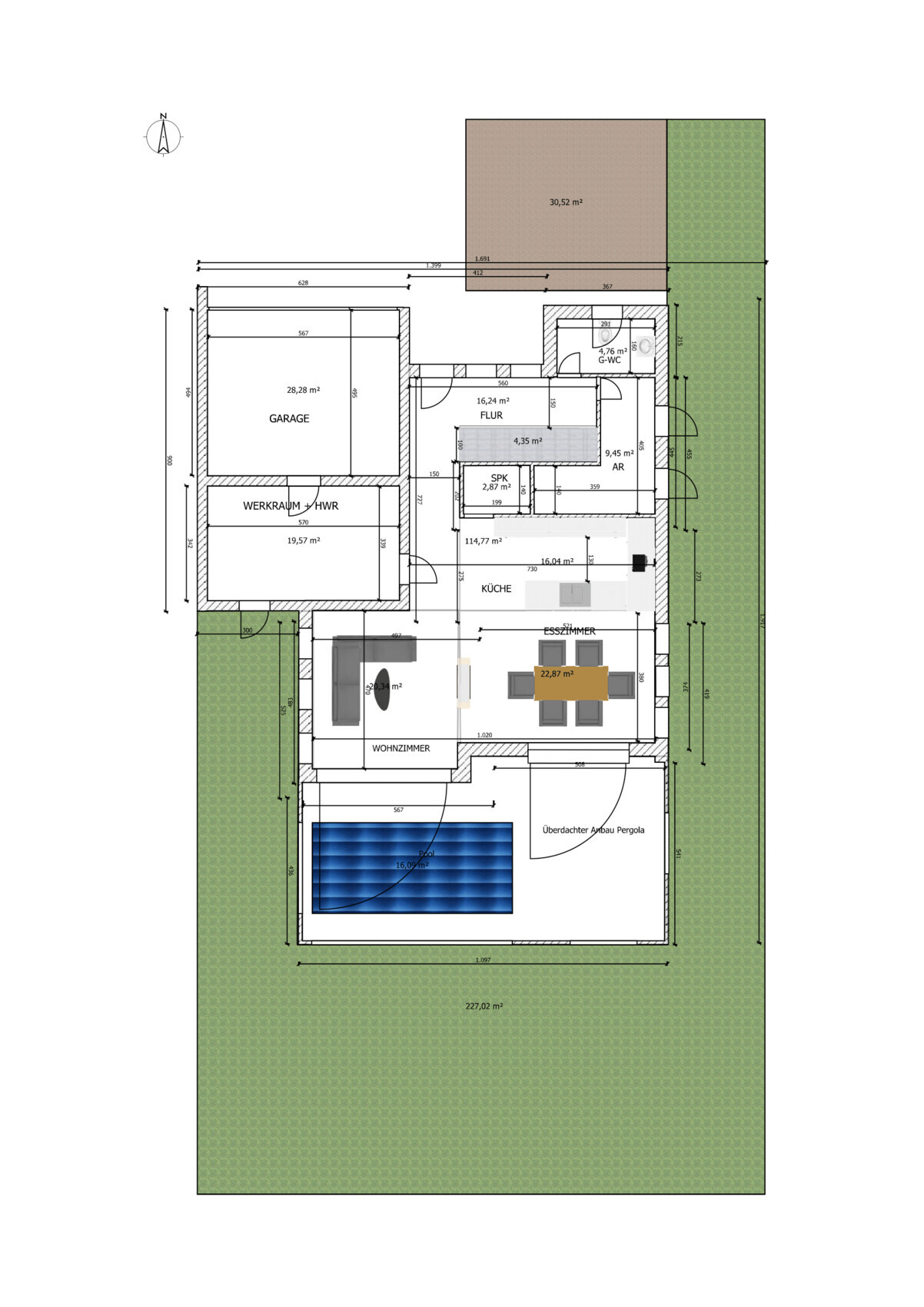

Floor plan of a house with garage, kitchen, living room, dining room, hallway, and garden with pool.

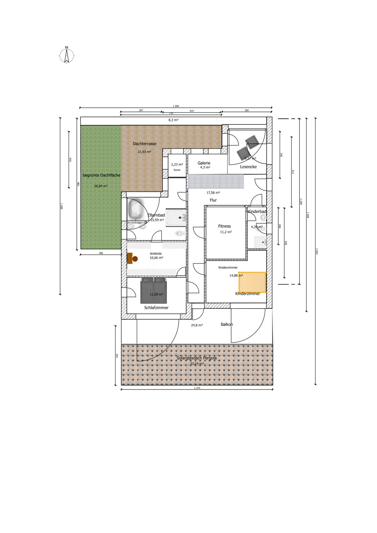

Floor plan of an attic with bedroom, gym, children's room, balcony, and roof terrace.

A sauna you cannot lie down in, but which has a corner window. A hallway as narrow as a rifle barrel. A garage where even a BMW 5 Series or Mercedes E-Class bumps the license plate at the front. You really seem to recreate visuals completely without any sense of dimensions. If you were king, you would have the designer executed as soon as the (curtain) lock shines in its full glory. You don’t learn architecture in a quick driving course.

I personally find the entrance area far from spacious, as you are faced with a long, narrow corridor upon entering.
Is the office even practical to furnish? It also appears quite narrow.
Upper floor: I think the layout of the parents' rooms is better this way, as it makes much more sense in my opinion (keyword: quiet).
However, unfortunately, there is also that long, narrow hallway here.
Gym without a window? Was a basement planned at all, or not?
Roof terrace: do you really think you will use the north-facing side and the side facing the street?
Edit: and on the other side, there is also a balcony... My experience/opinion: you won’t really use these if you have a garden. At most, the child might go there to smoke.
The distance from the children’s room to the children’s bathroom couldn’t be longer. Then the child doesn’t even have any peace there, because someone can still walk through the gym.

The floor plan has been revised again. The upper floor was almost completely changed. The bathrooms are located either above the utility room, the kitchen, or near the main entrance. The entire house was slightly compacted to save costs. In my opinion, without losing living comfort.
The utility room is still a bit too small for me. The storage room as well.
Floor plan of a residential house with roof terrace, bathroom, bedroom, children’s room, hallway, gallery.
Floor plan of a house with double garage, kitchen, living room, dining room, hallway, and storage room.
