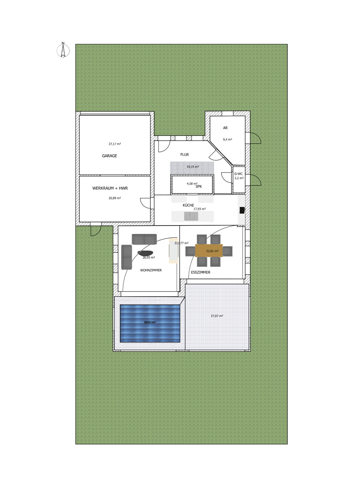

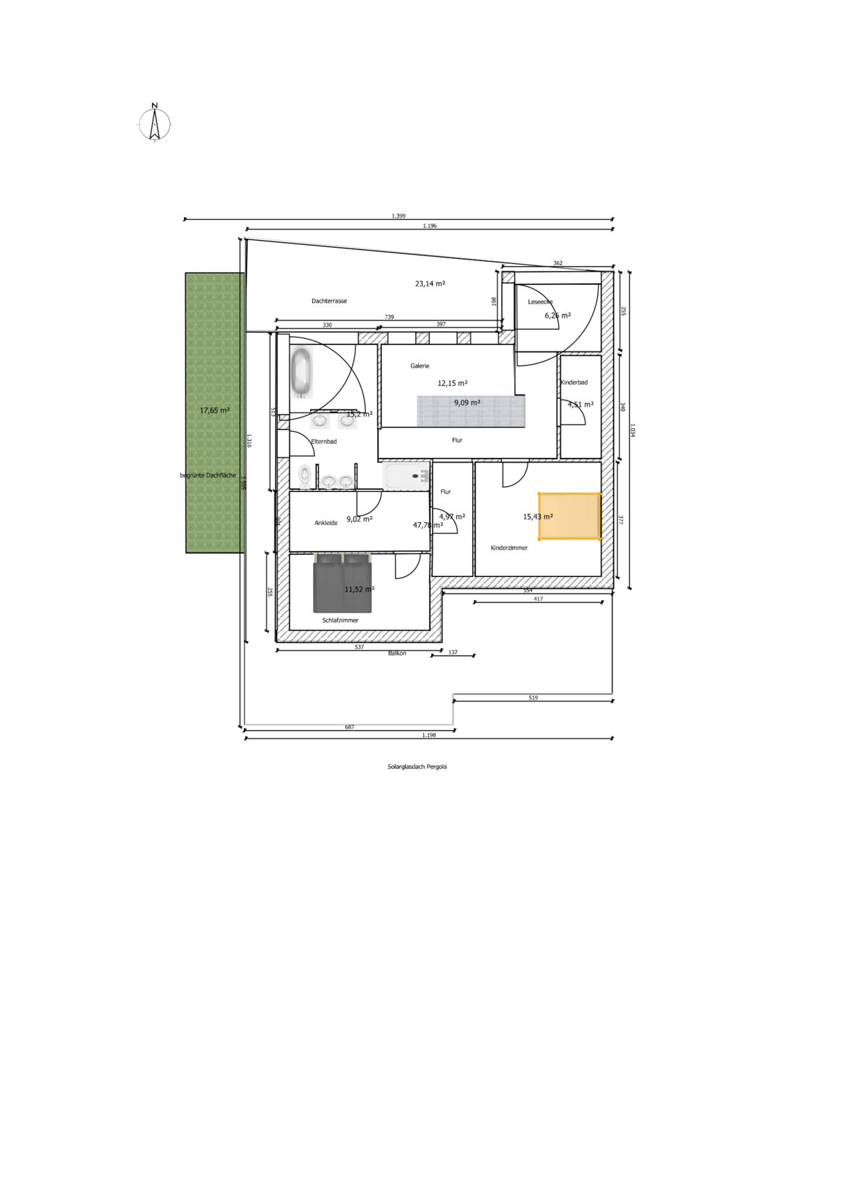

Hello dear forum members,
here is the first draft of our planned single-family home. I would appreciate your ideas, criticism, tips, and tricks. Sorry that dimensions and some furnishings are still missing. I am only interested in the rough floor plan for now.
Between the living and dining areas, there will be a fireplace or a decorative element serving as a room divider. In the pergola, which should have a solar glass roof, a pool is planned if the budget allows.
We plan to build using a construction manager or site supervisor with separate trade contracts, using solid construction methods.
Thank you very much for your opinions.

Henning_8512 Mar 2020 11:10Phew, difficult. I find it way too convoluted. Probably the idea is to make the ground floor feel airy and open, but I don't think that will work.
But for now, I’ll stick with the folds. A garage length of five meters (16 feet) for the vehicle is obviously nonsense – or do you already know you’ll never drive a station wagon or sedan?
The upper floor doesn’t work like this. Narrow hallway to the master area. From the too-small walk-in closet, you enter directly into the shower. Plenty of square meters in the bathroom, yet everything feels oddly cramped.
Honestly – discard the floor plan and consult an architect. You’ll need to see one anyway.

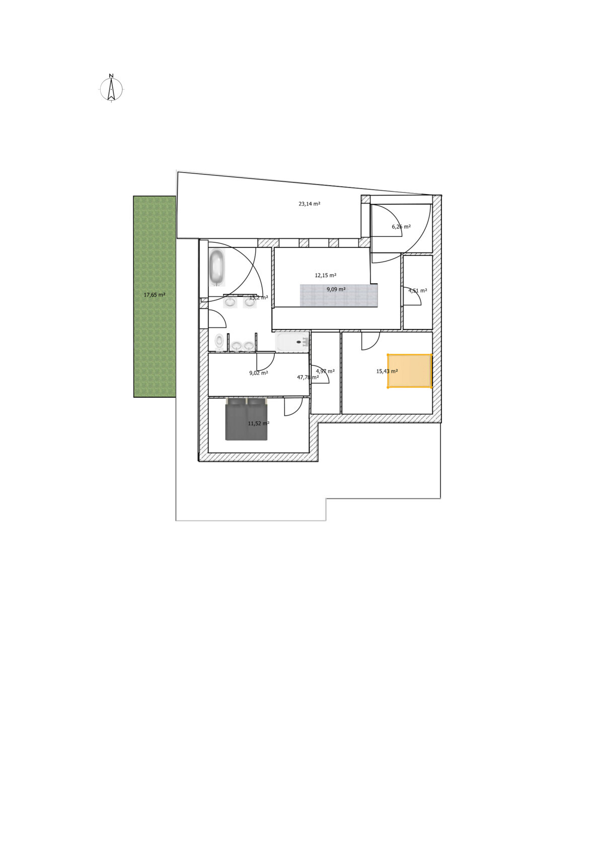

The house can be built much smaller without losing living comfort. At the same time, some rooms can be enlarged to reasonable dimensions.
Let’s briefly discard the floor plan and start with the upper floor.
Parents’ area:
There is far too little space between the bed and the wall. 2.55 m (8 ft 4 in) – bed including frame – plaster, so one person will have to climb over the other.
The walk-in closet is acceptable.
Master bathroom: 4 sinks?
What is the purpose of the small hallway? (It creates the feeling of being in a much too small apartment, as in many other places as well.)
Children’s bathroom: Judge this carefully, it does not function properly.
Reading corner seems like an afterthought.
Very bright, but hardly any space for books and no quiet area.
The large gallery causes sound to travel throughout the entire house.
Ground floor:
The office has hardly any storage space.
The slanted wall does not fit with the house at all.
Guest toilet dimensions resemble more a public restroom cubicle.
How deep is the pantry?
The sofa looks quite delicate.
Positive: finally no tiny table.
A wardrobe or coat storage area is completely missing.
