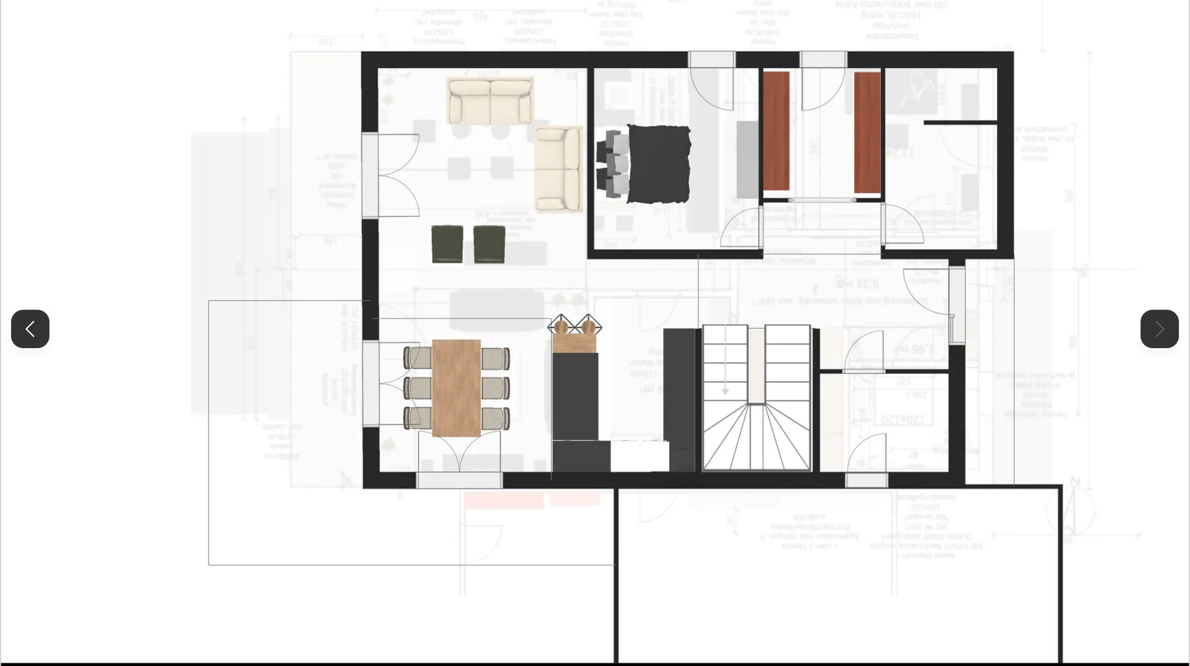

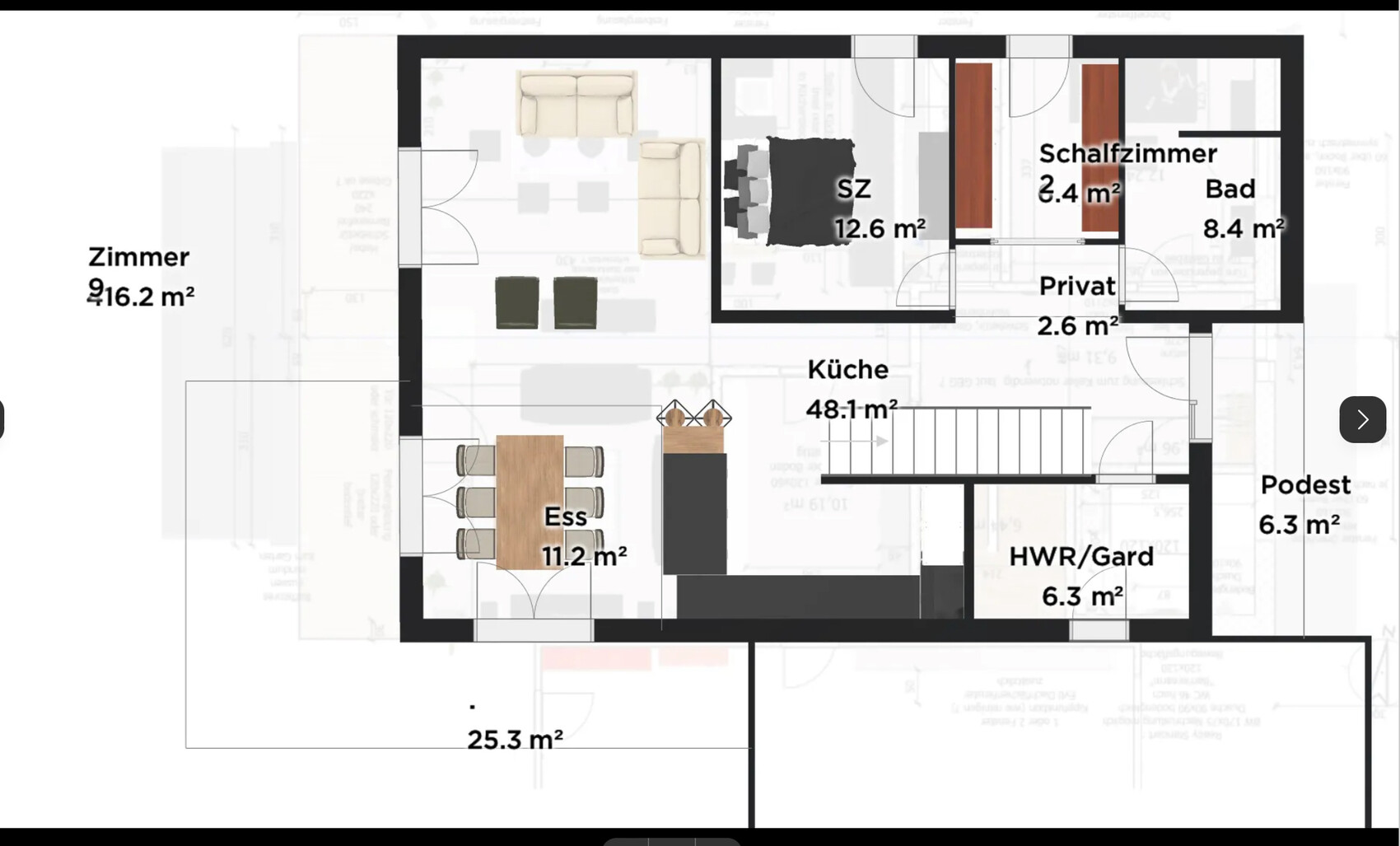

What I like about the initial plan are the open sight lines, the gallery, and the large living/dining area facing the garden (southwest).

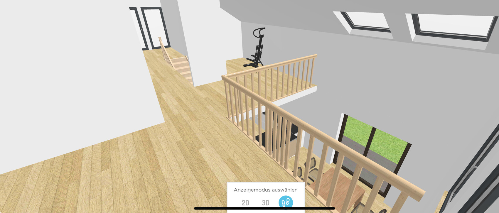

I especially struggled with the staircase design. Initially, I wanted a straight staircase with access from the living/dining area, but I discarded this for various reasons (also because a cellar staircase is still needed “underneath,” which makes a straight staircase less visually appealing).
After initially planning bathroom access from the sleeping area (which also leads to the dressing room), I eventually decided for an access from the hallway to allow a wider shower, a large double washbasin in front of the window, and a toilet with at least 90 cm (35 inches) clearance to the side.
What I don’t like yet is the gable side area between the open space and the office with the 90-degree angle.
In the (probably too) narrow utility room, the washing machine and dryer are to be accommodated.

But remember to allow enough room for movement.
Here’s a rather bold idea concerning the view of the plank wall when entering the house. I hardly dare to say it out loud. Could you design a freestanding steel staircase that isn’t embedded into the side wall, and then replace the front "plank wall" with a glass railing? This would provide a view of the "bold staircase structure" looking down to the basement stairs and up to the stairs leading to the upper floor.
It is always very important to understand the individual “quirks” (in a positive sense, of course) of the people involved to create a good floor plan; I really like when someone plans something special for themselves or their partner. We know a couple where he loves listening to loud music but would never wear headphones (3-room condominium), and they are still married... phew. I usually wear my cozy slippers in the gallery when I watch documentaries. If that’s not suitable for someone, they’ll either need doors or soon the contact details of a lawyer.
@ypg That makes sense to me regarding the hallway/corridor, so I also think this curve is only planned because a “nonsensical curve” was already built before. There are elegant floor plans, even for these spoiled “best agers.”
The staircase also seems somewhat out of place to me, but I can’t come up with an alternative idea.

Then it fits perfectly, that’s what really matters; by the way, I find the walk-in closets quite small, maybe you could pass that on :-). The staircase was a tough, frustrating issue for us, but in the end, it turned out great; check out the “Zeitform” section, especially the cantilevered staircase. It’s a very friendly one-person business that might have the right idea for you or can at least tell you what’s feasible.
Arauki11 schrieb:
That makes sense to me with the hallway/narrow passage, so I also believe this curve is only planned because an earlier "nonsensical curve" was already built in. There are nice floor plans, even for these spoiled "best agers."Well, I’m currently juggling and playing Tetris with walls and have now stepped back. However, I’m also somewhat half-hearted about it: on one hand, it’s about optimizing for the biker; on the other hand, I initially said this plan contains biker-related mistakes that I cannot support.
I have also never understood, as a mature adult, not using the main entrance and why you always want to disappear through the garage into a utility room that has nothing to do with the entrance and usually just has laundry on the floor.

Could a freestanding steel staircase be designed that is not embedded into the side wall and then replace the frontal "plank wall" with a glass railing to have a view of the "daring stair construction" down to the basement stairs and up to the stairs to the upper floor?A lot is possible. With this idea, I wonder why everything else is supposed to be so closed off, but suddenly a basement staircase should bring transparency. A steel staircase has many disadvantages—noise, vibrations, coldness. It looks good if you look at it nicely. A glass wall takes up floor space. Or what exactly do you mean by a steel staircase? Arauki11 schrieb:
By the way, I find the walk-in closets tiny; maybe you can pass that on :-).Yes, most of them are indeed either narrow or small. Usually, that’s intentional. I also don’t see most of them as age-appropriate. There simply isn’t enough space for that. Here are my two variants (with different furnishing; I didn’t save the small furniture):
