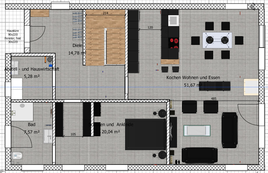

I came across this interesting forum yesterday and would like to take the opportunity to present my first floor plan draft here in the hope of receiving valuable advice. Often, being too focused on one direction limits ideas, so fresh eyes and new inspiration from others are always very helpful.
The general idea is to have the house built completely turnkey by a prefab house company, without any DIY efforts on our part. So far, no architect has been hired because I first wanted to try putting my own wishes and ideas on paper. I believe that with this DIY preliminary planning, there might be a better basis to go directly to an architect or even several prefab home providers to obtain feasible implementations and corresponding cost estimates.
I look forward to your feedback (and I’m already bracing myself...).

A first preliminary plan created using a 3D program is available.
What I like about the initial plan are the open sight lines, the gallery, and the large living/dining area facing the garden (southwest).
I especially struggled with the staircase design. Initially, I wanted a straight staircase with access from the living/dining area, but I discarded this for various reasons (also because a cellar staircase is still needed “underneath,” which makes a straight staircase less visually appealing).
After initially planning bathroom access from the sleeping area (which also leads to the dressing room), I eventually decided for an access from the hallway to allow a wider shower, a large double washbasin in front of the window, and a toilet with at least 90 cm (35 inches) clearance to the side.
What I don’t like yet is the gable side area between the open space and the office with the 90-degree angle.
In the (probably too) narrow utility room, the washing machine and dryer are to be accommodated.

Arauki11 schrieb:
Is the neighboring house actually built right on the property line, or how does it work with that outdoor unit on the wall and the pipes? How does the neighbor access that area?
Maybe you should respond to all the points directly. I get the impression that you are trying to defend or justify your design, which isn’t necessary.
I think the issue isn’t a corner here or there, but rather the earlier decision about how we can live there as comfortably as possible in old age, and what space and belongings we no longer need in this new phase of life. Yes, the neighboring house is built directly on the boundary / at the sidewalk. It’s clear that the air conditioning unit needs to be removed or relocated... that shouldn’t be a problem.
I don’t want to defend anything, but simply explain the boundary conditions regarding the size and footprint of both the house and the garage, since I can and want to work only within these limits.
hanghaus202325 Oct 2024 17:23hanghaus2023 schrieb:
I sketched a ground floor plan.
Thanks, I’m working on it as well. However, it probably won’t be feasible to move the house back another 2m (which would definitely help with the lighting in the kitchen), as shown in your sketch.Biker99 schrieb:
Yes, the neighboring house is located right on the property line / sidewalk. It’s already clear that the air conditioning unit needs to be removed or relocated... that shouldn’t be a problem. If it’s indeed an air conditioning unit, that might become tricky. That’s why I suggested the idea of possibly incorporating the currently unattractive wall into your planning on a win-win basis. In return, your friendly neighbor could leave the unit and pipes as they are. You could then either commission a large-scale mural or, as already mentioned, cover the entire wall with a trellis system and plants to soften its appearance or even turn it into an attractive feature. This approach could make the space feel cozy, like a pleasant or greened courtyard.
hanghaus202326 Oct 2024 12:06ypg schrieb:
Roughly sketched out your requests, with the lower part a bit longer Thanks again for your comments. I have tried to put together a first draft of the ground floor based on your rough sketch.
This has made the house 1m (3 feet) longer for now.
I will also take another look at hanghaus2023’s sketch with the central entrance and the small guest WC.
