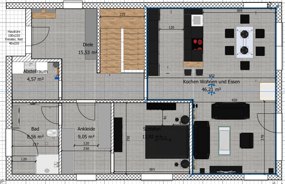

Here is the ground floor plan first
Floor plan of a house with hallway, cooking/living/dining area, bedroom, bathroom, dressing room, storage room
Biker99
27 Oct 2024 15:56
And the upper floor as well.
The idea here is to have the option of a sleeping area for two people and a bathroom both on the upper floor (for guests or the homeowners) and on the ground floor, with the ground floor designed to be as age-appropriate / accessible as possible.
The open gallery is currently on the south/southwest side, as you rightly suggested. The window design and placement could certainly be improved; the upper floor should be bright and open facing southwest.
I am also not really satisfied with the arrangement of the sanitary facilities yet. Perhaps, or most likely, you will have better ideas.

First of all, thank you for your critical comments!

Biker99 schrieb:
I’ve worked on it again and hope I have now better matched your design.
It would be great if you and the other experts could comment on this one again.
Thank you very much
Here is the ground floor for now
Amateur opinion:
The hallway takes up a lot of space at 15.5 sqm (167 sq ft). It’s a zigzag when entering the house because you immediately run into a wall, then turn right and run into another wall. From there you look at the next wall (door to the open-plan room). This door might possibly be removed, but then you just have this endlessly long, narrow corridor.
I quite like the sleeping area with the walk-in closet, separated like an apartment (we unintentionally did this in our upper floor and are happy about it), but there is no guest toilet on the ground floor, as visitors shouldn’t have to walk through your private bedroom area.
Unfortunately, this is just some “criticism” without a concrete solution idea, but that’s what stands out to me.
On the upper floor, having the bathroom door open outward is not ideal, and the bathroom could be about 4 sqm (43 sq ft) smaller; as it is, it just creates unnecessary walking space and cost. Also, the extra room upstairs for hobbies and the fancy sports gallery—maybe you could specify your hobbies? You plan to live there as a couple and have guests occasionally, which is fine. But so much separation and extra rooms—each as a separate space—is probably more than needed.
We like the open plan for two people and also appreciate having some quiet time, but for me, this is too many individual, separated rooms.

Arauki11 schrieb:
Amateur opinion:
The entrance hall takes up a lot of space with 15.5 sqm (167 sq ft). It feels a bit awkward entering the house because you immediately face a wall, then turn right and run into another wall. From there, you look directly at the next wall (the door to the open-plan room). That door might possibly be removed, but then you'd have this endlessly long, narrow corridor. I like the bedroom area with the walk-in closet, separated like an apartment (we unintentionally did something similar in our upper floor and are happy with it), but then there’s no guest toilet on the ground floor, since strangers shouldn’t have to pass through your private bedroom area.
Unfortunately, this is just criticism without concrete solutions, but these are the points that stand out to me.
Upstairs, having the bathroom door open outward isn’t ideal, and the bathroom could be about 4 sqm (43 sq ft) smaller, otherwise it’s just unnecessary walking and expense. Then you have an extra room upstairs for hobbies and a fancy sports display; maybe you could specify your hobbies? You plan to live there as a couple and occasionally have guests, okay. But so much separation and so many extra rooms—do you really need a separate room for each?
We like open living together, but also some peace and quiet from each other, though for me, this is too many individual, separate rooms.
You’re absolutely right about the bedroom door upstairs—I quickly redrew the floor plan this afternoon based on suggestions from "ypg" (though not copied exactly to avoid further comments). That will be changed.
Yes, the entrance hall or foyer also seems a bit (too) large to me, and I will try to make the “wall to the ground floor walk-in closet” more open and differently arranged.
The extra room upstairs is needed to display some cabinets for items that don’t tolerate much light over time. My/our hobby is classic cars and vintage racing bicycles. The "sports gallery" also seems a bit (excessively) large on the floor plan, although I like the idea of working on bikes there (which I won’t tell my wife, of course).
Biker99
27 Oct 2024 18:43
Arauki11 schrieb:
Amateur opinion:
The hallway takes up a lot of space at 15.5 m² (167 ft²).
I will try to shift the staircase slightly towards the entrance. Maybe then the house can also be reduced from the originally planned 14 m (46 ft) back to 13 m (43 ft) without making the living area on the ground floor too small.
27 Oct 2024 19:38
Biker99 schrieb:
even if not adopted 1:1 so there won’t be any more comments). This will be changed
Haha, I just wanted to point out the relevant minor details.
Biker99 schrieb:
I’ll try to move the staircase a bit closer to the entrance.
Just keep in mind to allow enough space for movement.
Arauki11 schrieb:
This could possibly be omitted, but then you end up with that endlessly long, narrow hallway.
Exactly. The endlessly long and narrow hallway is actually only as long as the staircase is wide. The reason for this is to avoid an even longer hallway if the entrance is centered, creating a break instead. Besides, it also eliminates the need for the second hallway, which is disguised as a vestibule/storage room where laundry is presumably done. Personally, I wouldn’t put a staircase there either.
Arauki11 schrieb:
But you don’t really need so much separation or extra rooms each having their own dedicated space.
There are two of us and we like the open layout as well as having peace when needed, but for me, that’s too many separate, closed-off rooms.
We are two as well and enjoy having two floors. That’s enough for mutual quiet. We don’t need doors or small rooms for that. I just bring my hobbies into the open living area and take over the table there. Although, of course, having an additional separate room is not something you can dismiss outright.
