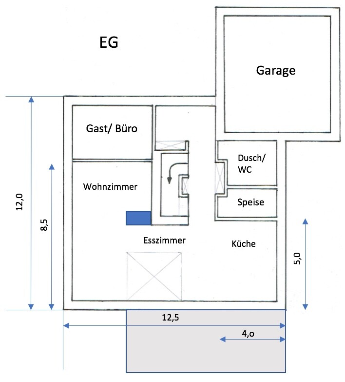

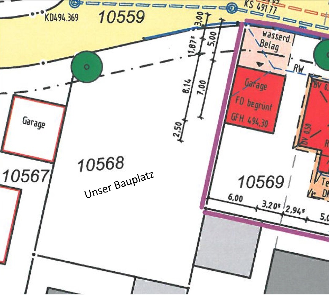

Three years ago, I purchased a building plot that is subject to a development obligation by the municipality. Therefore, if possible, the construction should start this year. You can probably imagine that in Beijing, it’s not so easy to visit model homes that would fit into a typical building plot in southern Germany. So, over the past few weeks, my wife and I have been working intensively to put our wishes down on paper ourselves. Our approach was similar to the suggestions from ypg. We considered the sun’s path, neighbors, and of course our own needs.

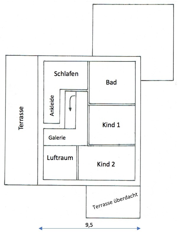

We are quite satisfied with the result so far. However, I think it’s easy to get stuck in one’s own ideas, and a lack of experience might prevent us from noticing some important aspects. For example, the bedroom on the upper floor has turned out too small, and I am not at all sure about the proportions of the desired open space above the dining table.

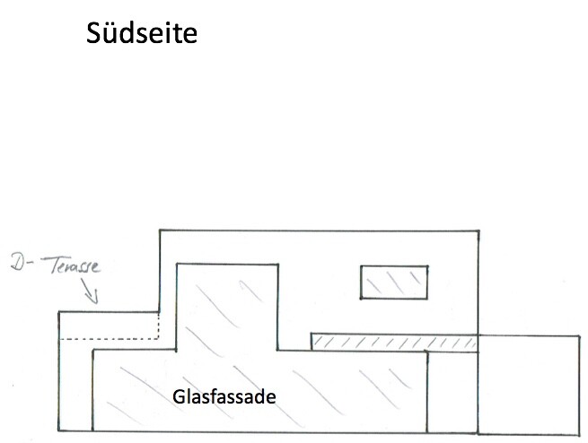

Maybe you could find a few minutes to take a look at our floor plan drawing.

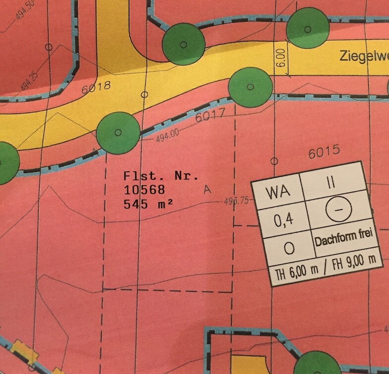

Plot size: 545 sqm (about 5865 sq ft)
Slope: no
Site coverage ratio: 0.4
Floor area ratio
Building envelope, building line and setback
Edge development
Number of parking spaces
Number of storeys: 2 full storeys
Roof type: (flat roof planned)
Architectural style: Bauhaus
Orientation: south
Maximum height / limits
Additional requirements

Additional wishes: generous open living area, open space, large glass facade facing south

the design developed based on our wishes and the orientation of the neighboring buildings.

Personally, I find a gallery area above the dining table position somewhat unappealing. It creates a hall-like feeling at the dining table, makes lighting more difficult, and since that’s exactly where people like to sit and chat with friends, all the noise easily travels up to the rooms above the children's bedrooms. Just something to consider 😉

I can understand the arguments against the granny flat. Oh, I definitely understand the arguments "for" as well. The problem is that they come from different perspectives: almost all the "pro" arguments are economic, while nearly all the "contra" arguments are related to construction. Without a sloping site, it’s more complex to build a suitably attractive granny flat, especially if you mean a basement apartment. And a ground-level granny flat requires a larger plot.
Practically, this means: if you want a granny flat, you either need a villa-sized lot for what would otherwise be a normally sized single-family home, or a sloped site. If the plot is only normal-sized and flat, you have to artificially expose the basement or essentially build an inverted one-and-a-half-story house, with the larger part of the living space on the upper floor. These planning consequences are why many home builders in flat development areas opt for just a single dwelling unit.
