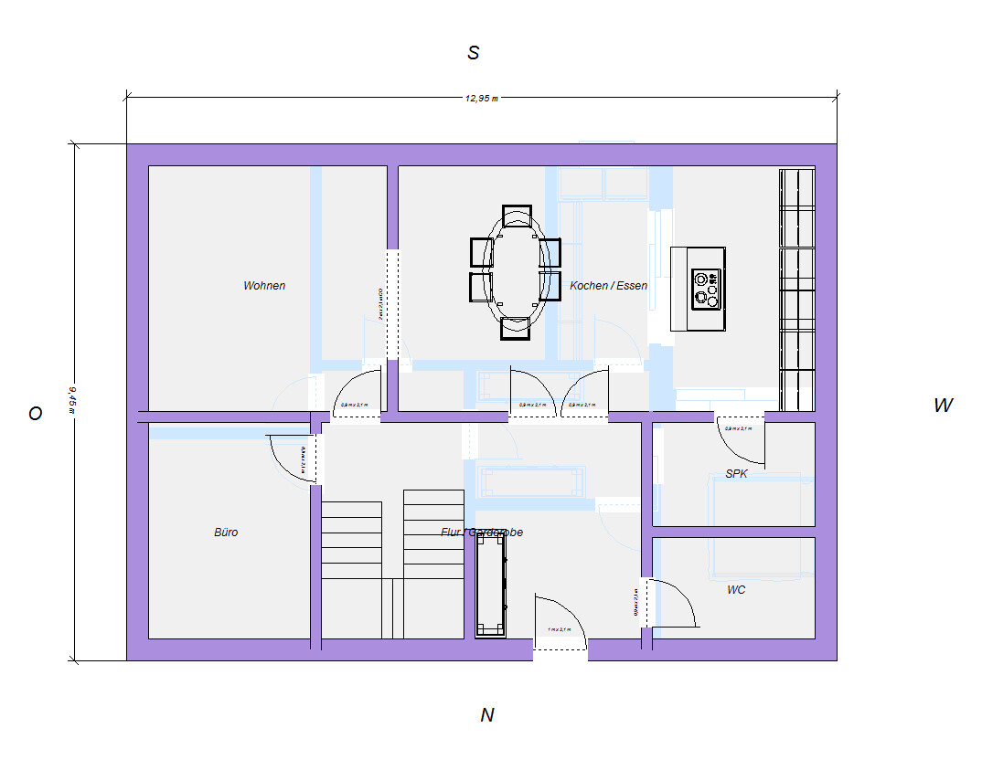

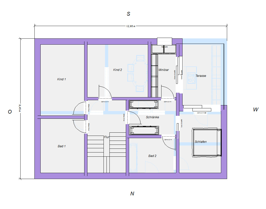

Dear building experts, homeowners, and creative minds,
Due to work, my family and I are currently living in the Middle Kingdom (Beijing :-) ). At the end of September, after almost four years, we will be returning to our home country. Our plan is to build our single-family house as soon as possible and enjoy the peaceful life in the countryside.
Three years ago, I purchased a building plot that is subject to a development obligation by the municipality. Therefore, if possible, the construction should start this year. You can probably imagine that in Beijing, it’s not so easy to visit model homes that would fit into a typical building plot in southern Germany. So, over the past few weeks, my wife and I have been working intensively to put our wishes down on paper ourselves. Our approach was similar to the suggestions from ypg. We considered the sun’s path, neighbors, and of course our own needs.
We are quite satisfied with the result so far. However, I think it’s easy to get stuck in one’s own ideas, and a lack of experience might prevent us from noticing some important aspects. For example, the bedroom on the upper floor has turned out too small, and I am not at all sure about the proportions of the desired open space above the dining table.
Maybe you could find a few minutes to take a look at our floor plan drawing.
Many thanks and Nihao from faraway China :-)

Your plot is not suitable for a basement.
You will face extremely high costs for earthworks, light wells, and the entrance.
The light wells could affect your exterior landscaping. That alone would be a deal breaker for me. I build to live without restrictions.
This is likely also the reason why there are hardly any granny flats in the development.
It’s also questionable whether the children will ever move in with you.
Manu82 schrieb:
The width of the lot is 19m (62 feet). The length of the shorter section is 24m (79 feet). We are already working on a new floor plan. We found a floor plan online that might fit. It still needs to be adjusted to our lot.Isn’t 19m (62 feet) too narrow for a double garage? That would take up almost a third of the lot, needs to be integrated into the house, and will probably be quite expensive.Yes, it would be a semi-integrated design, see page 4, post 20.
Marvinius II schrieb:19m (62 feet) minus 3m (10 feet) building setback on both sides = 13m (43 feet) house width, with 3m (10 feet) of it projecting as one half of the garage.
Is 19m (62 feet) not too narrow for a double garage?
