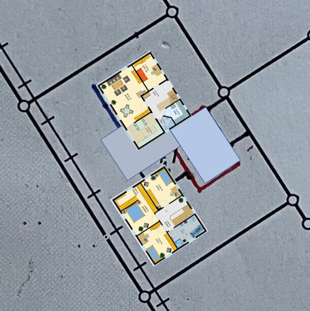

I have been quietly following for some time and would now like to take the opportunity to gather some tips and advice. We are currently planning our house and would like to share our initial drafts with you.
We are completely flexible in the planning and want a functional home for 4 people. Important features for us are a kitchen island, fireplace, and walk-in shower on the ground floor.
We would appreciate any tips and suggestions, as we have never planned or built a house before.

Could it be that you planned the house around the kitchen? It’s understandable if the sofa/TV area is somewhat secondary, but ultimately, a family wants to feel comfortable in the house every day. Life isn’t just about cooking 😉No, we only used that as inspiration… having a niche for the side-by-side refrigerator isn’t necessary; it could be placed elsewhere. But you have to get your initial ideas from somewhere….H
hanghaus202311 Mar 2023 15:23icarus123 schrieb:
That also looks interesting, although I think the actual dimensions will probably mess things up again... A kitchen island would be important to us instead of a seating area.That’s possible, as mentioned before, with an island. You would even save one door that way.I
icarus12311 Mar 2023 15:34hanghaus2023 schrieb:
Here is the upper floor. Total: 145 sqm (1560 sq ft)
Do you have the dimensions/room sizes for this? I can’t quite make them out...H
hanghaus202311 Mar 2023 15:59H
hanghaus202311 Mar 2023 16:05Dimensions: 10.44m (34.3 ft) by 8.44m (27.7 ft). Look up the original "Starlight Stadtvilla 145". I have mirrored it.
