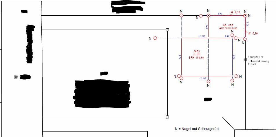

Plot, north orientation plan on top:
Site plan of a building plot with floor plan and north orientation

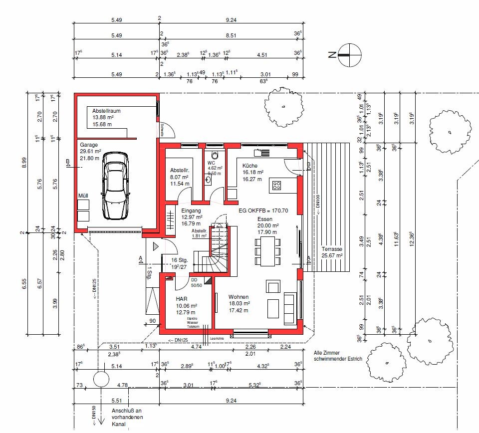

Ground floor:
Floor plan of a house: ground floor with terrace, kitchen, dining area, living room, and garage.

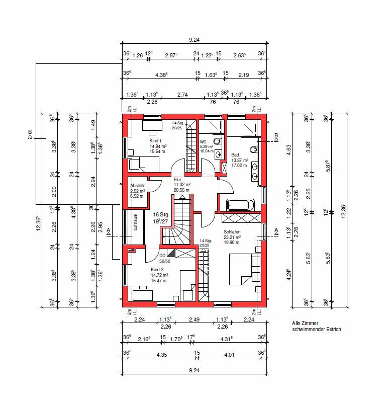

Upper floor:
Floor plan of a house with red outline; layout with bedrooms, bathroom, WC, hallway, and stairs.

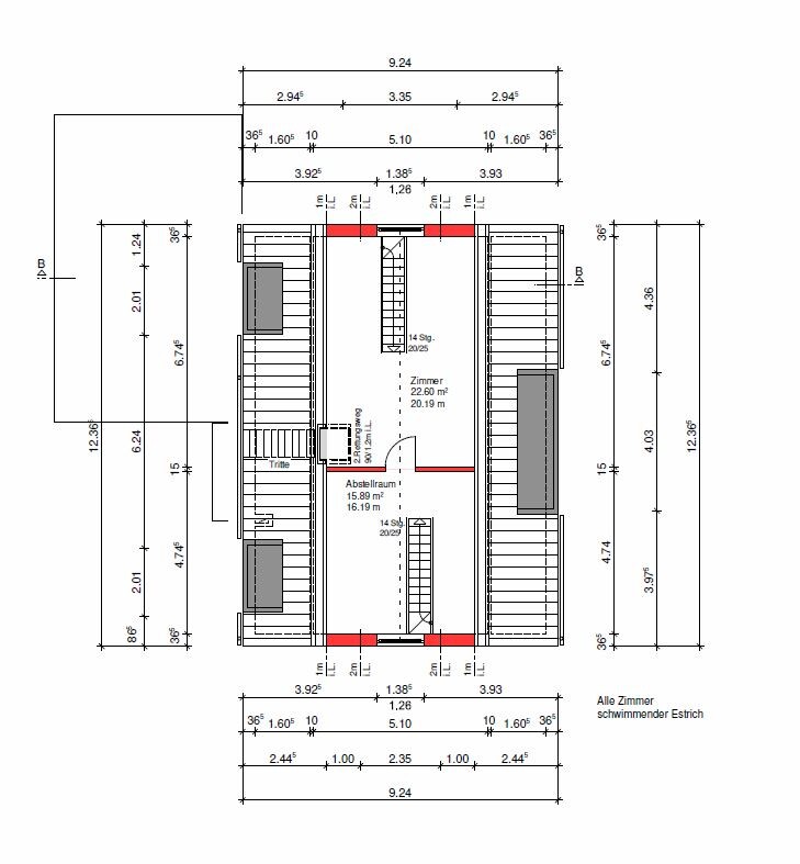

Attic floor:
Floor plan of a building with stairwell, rooms, and storage; dimensions.

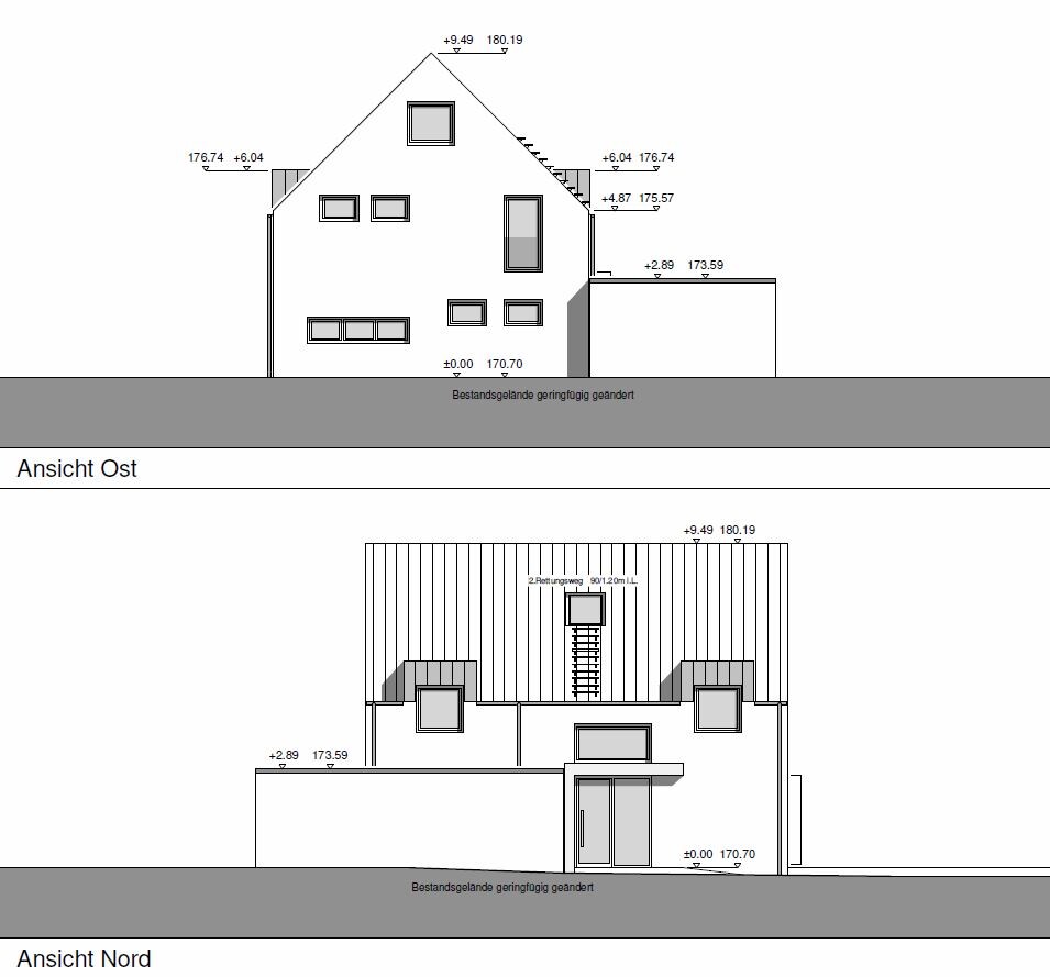

North/East elevation:
Architectural drawing of a house with east and north elevation and dimensions.

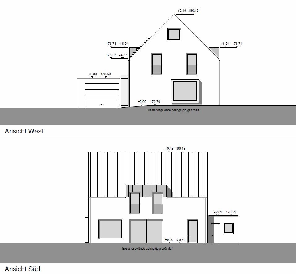

South/West elevation:
Architectural drawings: west and south elevation of a single-family house with garage.

I like it! Especially the fact that you can scare your child at Halloween when you climb into the kids' room through the attic.

Hehe, somehow I have to check which gentleman the lady will be seeing later if I can’t catch him at the front door first.
Actually, we had to do it this way because of the escape route through the roof. Otherwise, we would have had to install a second roof window.

The only thing that would bother me is the windows in the showers in the bathrooms. In the main bathroom, I would have replaced it with a double casement window.
