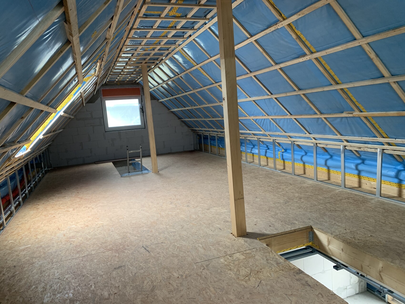

This is how we built the attic floor. However, the partition wall is still missing.
Attic shell construction with wooden studs, blue insulation foil, OSB floor, and window in the gable.
