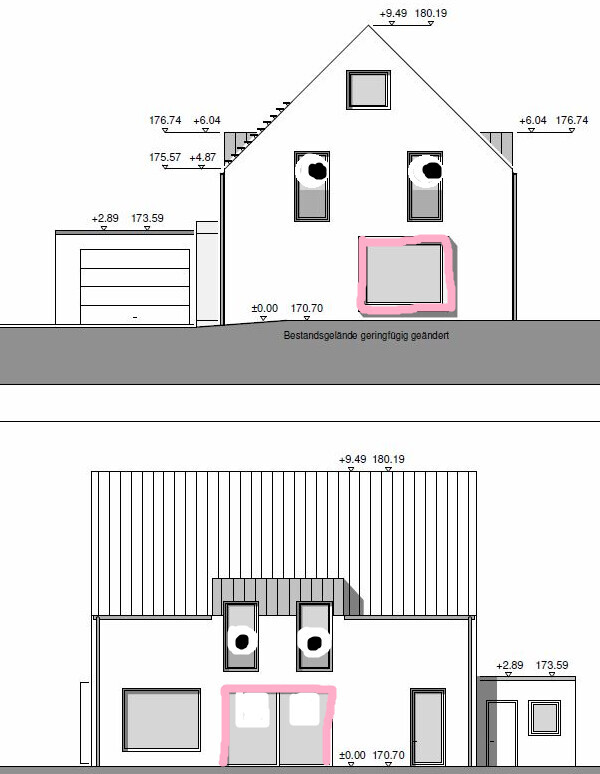

We are talking past each other because you, @Tarnari, have a two-story building, so a double casement window for the bathroom obviously won’t work. @Alessandro also misunderstood that.
Ah, got it. You can still tell I’m a building newbie.

We have about a 50cm (20 inch) slope in the bathrooms; how would a window be installed there? Or is the window supposed to transition from the wall to the slope?
No, a crank-operated double casement window could be installed if, instead of an attic, you had a "ridge-open" roof slope here.

We are talking past each other because you, @Tarnari, have a two-story building, so a double casement window for the bathroom obviously doesn’t work. @Alessandro also made a mistake there.
That’s correct, sorry.
I also didn’t look at the exterior views, otherwise I would have immediately noticed the following:
Architectural drawing: house with garage, front and side view, door opening marked in pink.
