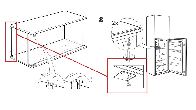

On the other hand, the fridge is supposed to be aligned using the height adjuster, but the issue here is that the plastic feet of the fridge protrude about 3-4 mm (0.1-0.2 inches) beyond the “edge” or so far out that the FA700 door remains slightly open. Hmm. So, do you cut off the plastic feet? That doesn’t really look right either.
The question is: does the Förkyld door still close properly if you adjust it using the plastic feet, which have an angled edge? The picture in the instructions also suggests that the feet align flush with the bottom edge.
