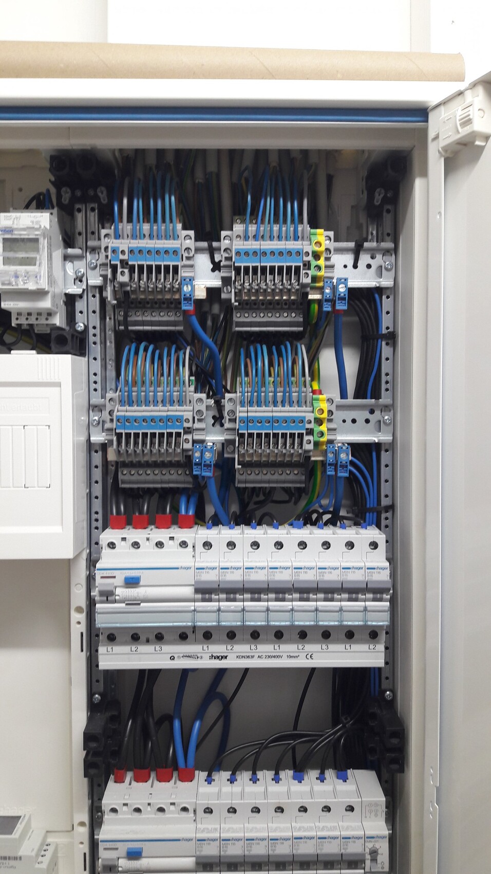

We moved into our new end-of-terrace house near Singen (Htw) at the end of February and are mostly satisfied. However, I’m concerned about the electrical installation:
In our electrical panel, we have three fuses, and I have had to replace one of them several times (two were 10 A fuses, which were replaced by 16 A fuses, and one was a 16 A fuse). This past weekend, for the first time, a 16 A fuse blew, so nothing worked anymore. Unfortunately, I don’t know when it happened because we only noticed it in the morning while showering—no hot water, since the heat pump had no power.
I then looked into the distribution box and removed the cover behind the fuses. You can see the result in the attachment.
What do you think? Is this common or is it poor workmanship? I have no knowledge of electrical work, and the local electrician only said the measurements are all good and that everything else is just cosmetic... is he right?

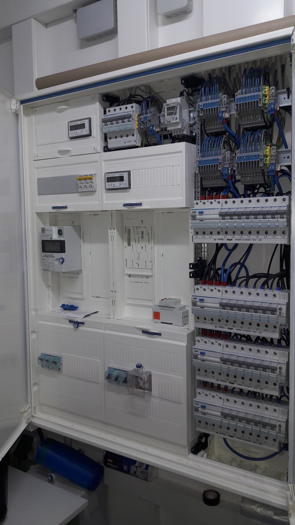

toxicmolotof25 Apr 2018 00:09So, I have now looked at the pictures again on my PC in a larger format, instead of on my smartphone. It doesn’t get any clearer, but I remain a layperson.
Nevertheless, I took the trouble to dismantle my electrical meter cabinet, just for you. It might not be a 100% reference, but this is how it could look. The difference is noticeable, and our cabinet is smaller yet more fully equipped.
@toxicmolotow: This already looks much better, but there are still a few points to address. Terminal blocks must be mounted on insulated DIN rails. Additionally, grounded rails need to be clearly marked as such. The labeling of the terminal blocks is also missing. This might seem a bit picky, but if you’re reviewing the setup, you should point out what stands out immediately. Another thing to note is that the assembly carrier on the far right is installed upside down.

@toxicmolotow : This already looks significantly better, but there are still a few things to mention. Terminal blocks must be mounted on insulated rails. Also, grounded rails need to be clearly marked as such. The labeling of the terminal blocks is also missing. This might sound nitpicky, but if you’re already reviewing it, you should point out what immediately stands out. Another thing to note is that the device carrier on the far right is installed upside down. Phew, I think I’ll keep my cabinet closed after all^^
