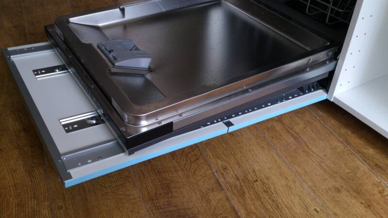

IKEA-Experte27 Feb 2015 11:04This is how it looks with BEHJÄLPLIG. It might be even more pronounced with the lower dishwasher:
With the Vario hinge it looks like this:
The more moving parts you have, the easier it is for something to break. Whether you will be able to get replacement parts for BEHJÄLPLIG in the long run is uncertain. Assembly is also more complicated.
I would change the order and return BEHJÄLPLIG.
