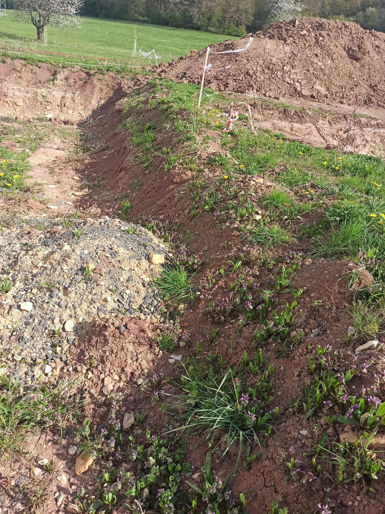

… Because that’s the kind of garden she has. For others, some more details or dimensions might be missing in theory. Because my parents dug out the area, there’s already quite a high earth wall facing us. They want to terrace it toward us. But if we add a 1m (3 feet 3 inches) wall on top of that, it will be taller than their entire ground floor and will block a significant amount of light. Of course, that would be the easiest solution, and if it were some neighbors, I wouldn’t mind. But since it’s my parents, I’d like to give them some sunlight because they’re already quite sunken into the pit from the excavation 😀
I attached a photo. It’s a bit misleading, but in the back corner the height reaches about 3m (10 feet). Adding another meter on top looks, in my opinion, somewhat unattractive...

Because my parents excavated, there is already a relatively high soil wall facing our property. They want to terrace this slope towards us. However, if we now add a 1m (3 ft) wall on top of that, the wall will be higher than their entire ground floor and will block a lot of light. Of course, this is the simplest solution, and if it were any other neighbors, I wouldn’t mind, but I’d like my parents to have some sunlight since they are already quite sunken due to the excavation 😀
I attached a photo. It’s a bit misleading, but in the rear corner the soil wall is about 3m (10 ft) high. Adding another meter on top seems, in my opinion, unattractive... How do you come to that conclusion? The priority is the house itself, not necessarily the garden. According to the development plan, the only thing that must definitely remain as is are the steps next to the house.
