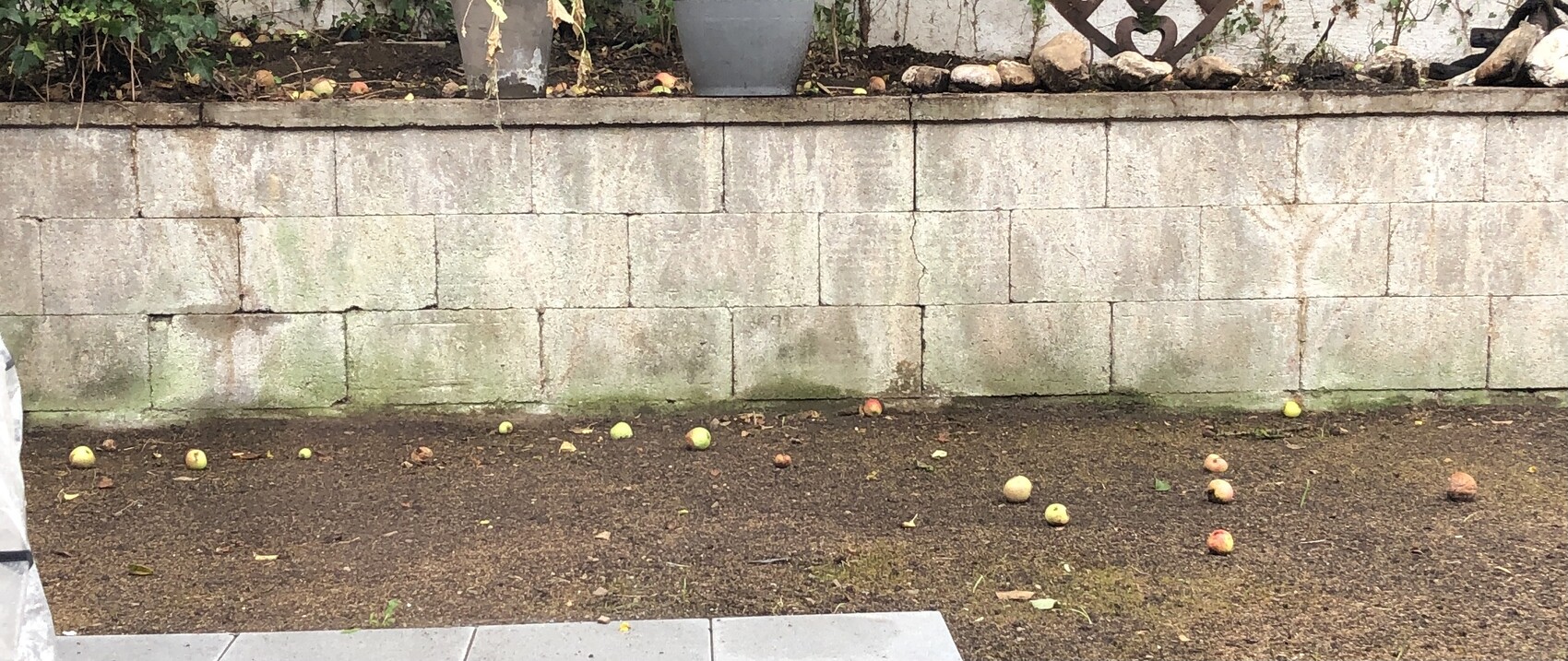

Last year, I built a wall using formwork blocks. Now it’s time to plaster it. I have never done this before and am hoping to receive plenty of experience, tips, and ideas.
My plan was to first use mortar to even out the “irregularities,” then clean the surface, apply a primer and let it dry well. Next, I want to apply the base coat (scratch coat), let it dry again, smooth it out, then apply the finish coat (top coat), and finally place coping stones on top of the wall.
What do you think of this approach? Do you have any advice on which products would be best for this? I am particularly struggling with choosing the right coping stones and finish coat. Perhaps someone has some ideas or even alternatives for me.
Attached are two pictures of the wall, which is 22 m (72 feet) long and 75 cm (30 inches) high.
Thanks a lot Best regards

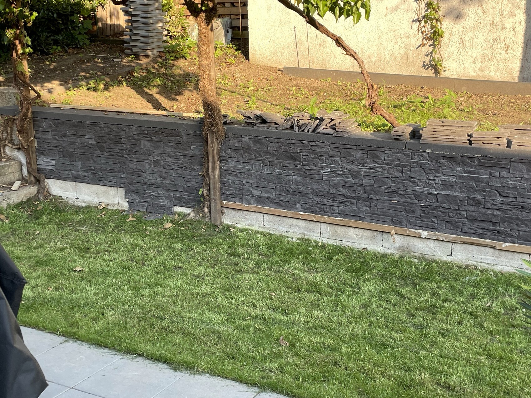

Stefan2.84 schrieb:
Hello everyone, I am also planning to improve the appearance of our concrete block wall. I am currently planning to apply a base render and then either cover the walls with tiles or cladding panels. Has anyone done something like this before?
Does anyone have an alternative example with the wall just rendered and painted?
Thanks and best regards,
Stefan Hi, I covered a garden wall with cladding panels. Rendering wasn’t an option for me because I didn’t feel confident doing it myself. I’m more than happy with the cladding. Unfortunately, I only have two old pictures at the moment. I can take a current photo if anyone wants.
