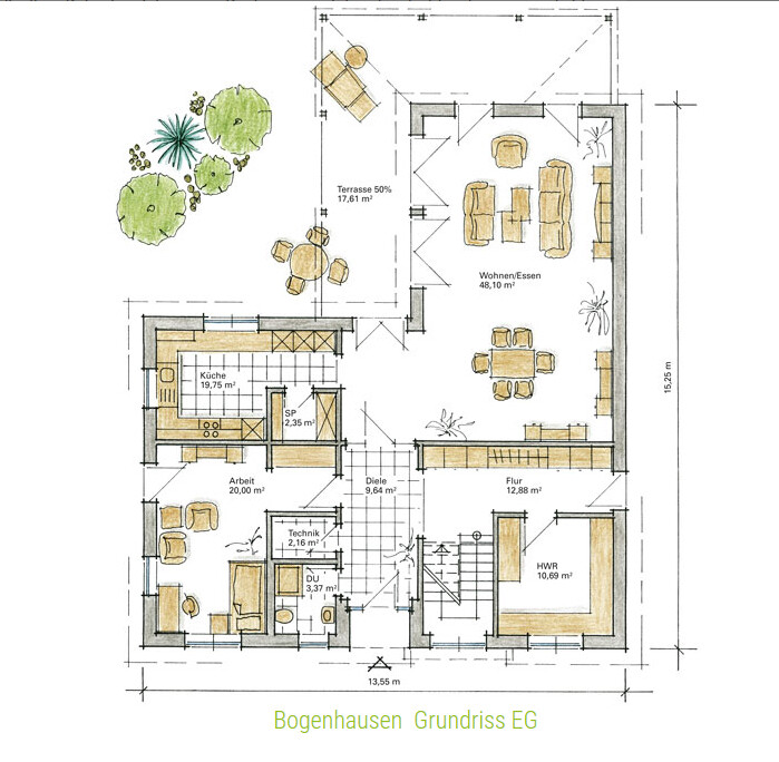

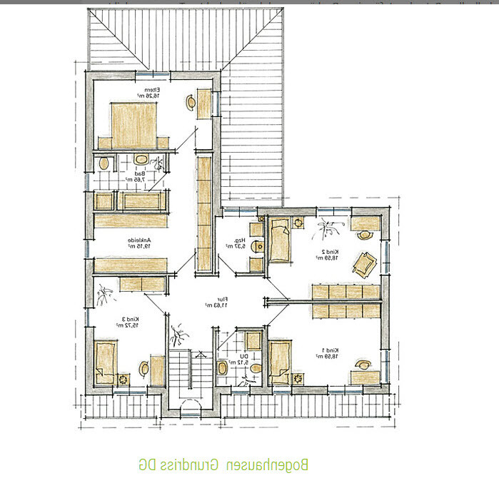

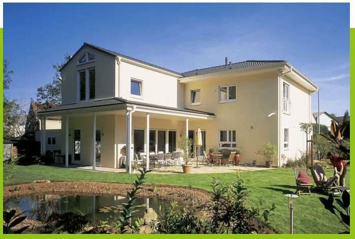

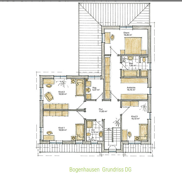

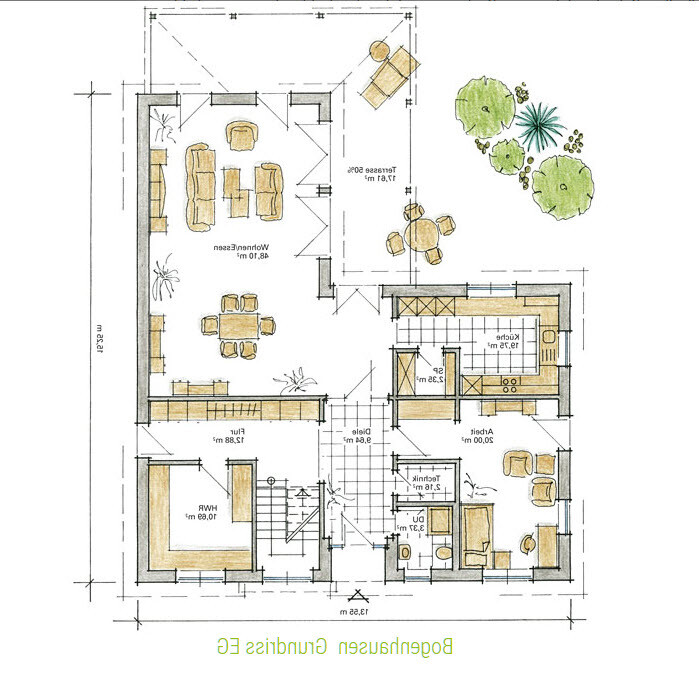

What about this option?
I started sketching the idea earlier, just quickly.
I also really like Yvonne’s version for a nice square terrace surrounded by greenery. It might be nicer than a strip, even if that has more surface area.
Gussek Haus even has a matching design for it (would still need to be mirrored):

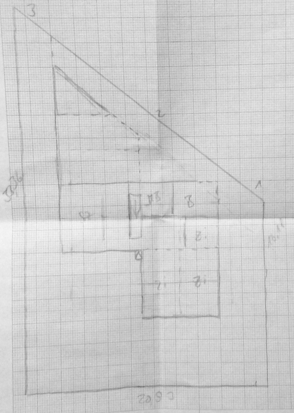

PitFlocke19 Nov 2018 14:27ypg schrieb:
I don’t find it easy: I sketched an L-shape in one or the other direction, also a rectangle... the plot is not very large, under 550sqm (about 5900 sq ft), and the triangular shape takes up a lot of space. Everything I draw works best with a carport/garage in the northwest corner. No matter how you turn it, elsewhere a double carport plus space for a bike parking area simply takes up too much space that could be used differently. We independently came to the same conclusion as three planners, since otherwise we just can’t use this corner better.
Also, question: how was that? Is building on the boundary not allowed? Of course, that reduces the depth available for the cars... On the street side, I will have to keep a minimum distance of about 1.5m (5 feet).
To the east, I can build up to 1m (3 feet) from the boundary, and to the west, it’s 3m (10 feet). (If I want to build closer to the west, this would need to be agreed with the neighbor.)
Earlier, I started sketching the idea briefly.
You would have more open views from the house into the garden, and parts of the house would benefit more from the west side as well as the south side. Ah, so you mean an L-shape for the entire main building. Not like currently, where the main building is basically just a rectangle and the short sections represent the garage and terrace.

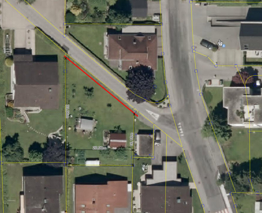

Here is the aerial photo of the plot with the neighboring buildings. (The building to the east is a transformer station.)
From your perspective, approximately like this:
PitFlocke schrieb:
From your perspective, something like this:
Yep.PitFlocke schrieb:
We independently reached the same conclusion as three planners, since otherwise we simply cannot make better use of this corner.
Towards the street, I will need to keep a minimum distance of about 1.5 meters (5 feet).
To the east, I can build up to 1 meter (3 feet) from the boundary, and to the west the distance is 3 meters (10 feet). (If I want to build closer to the west, this would need to be agreed with the neighbor.)
Oh, so you mean an L-shape for the entire main building, not like currently where the main building is basically just a rectangle and the short sections represent the garage and terrace.
Here is an aerial photo of the plot with the neighboring buildings. (The building to the east is a transformer station.)
From your perspective, roughly like this:
No, exactly not. That way, you end up with almost two courtyards: one in front of the carports and one in front of the entrance.
In my case, the main building is rotated 180 degrees... and now you can read my post about sun exposure and sight lines again.
