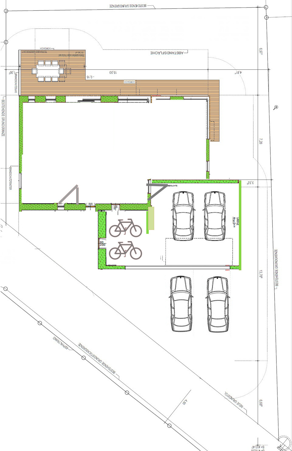

kbt09 schrieb:
@kaho674 .. the issue might be the corner at the bottom left of your plan. It probably needs to be at least 1 m (3.3 feet) away from the "new property boundary." This is just a sketch.
PitFlocke15 Nov 2018 12:38kbt09 schrieb:
And, the cloakroom can be placed quite nicely in the discarded version. Where would you put it then?
kbt09 schrieb:
@kaho674 .. the problem could be the corner at the bottom left of your plan. It probably needs to be at least 1 meter (3 feet) away from the "new property boundary". From the left side 1 meter (3 feet), from the street about 1.8–2 meters (6–6.5 feet)
kbt09 schrieb:
@PitFlocke ... double garage and parking space .. how many cars actually need to fit? Not counting visitors. 2 cars, 2 motorcycles, and 6 bicycles. I was also thinking of adding a workbench in the garage since the space where the garage is planned can hardly be used for anything else anyway.
kaho674 schrieb:
Alternatively, you could consider rotating the garage and giving the house a slight L-shape. This would also have the effect of creating more garden space. (green = new, red = old) Thanks for the input, I need to take a closer look. I’m not sure if this would just free up space that I still have to keep clear anyway due to the setback from the street.

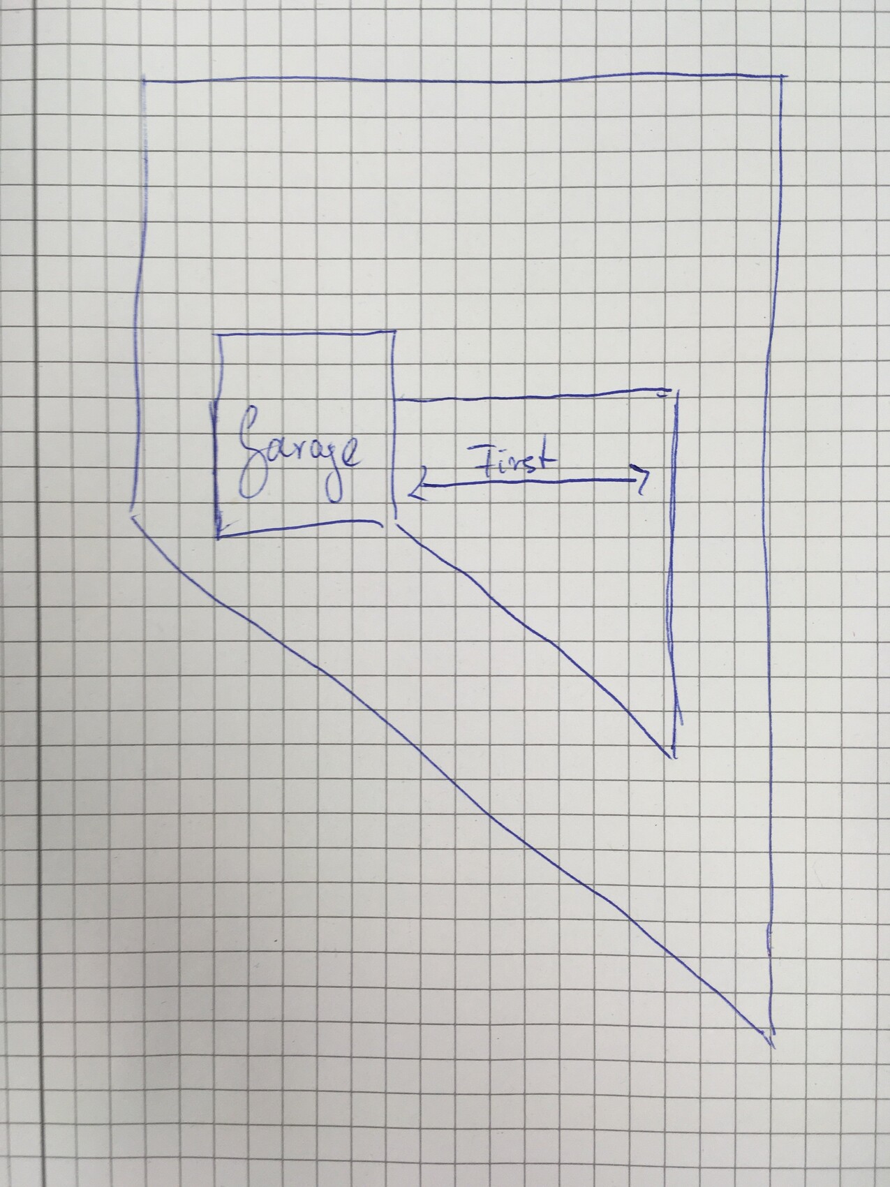

PitFlocke schrieb:
2 cars, 2 motorcycles, and 6 bicycles. I was also thinking about including a workbench in the garage. What surprises me a bit is the hip roof. I had rather expected a flat roof. A gable roof would also be possible. But a hip roof for this length? Do you already have elevations?
Has anyone tried positioning a more square-shaped floor plan on the west side and the garage on the east side to push the main building further north?
I would also consider shortening the discarded design in length – that way, it can remain further north while still complying with the setback requirements.
Alternatively, if allowed by building regulations:
A house whose front follows the northern boundary line, with the roof only "skewed" accordingly.
