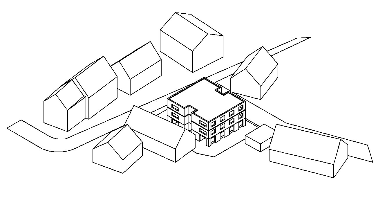

These are roughly the plans for the second project. Since there is no zoning plan, I am still unsure whether the environmental authority (UBA) will approve it, as the new building must fit into the surrounding area. However, my architect said it might be possible because "the Bauhaus style is timeless."
As a first step, I will submit a preliminary building inquiry here.

These are roughly the plans for the second project. Since there is no zoning plan, I’m still unsure whether the environmental agency will approve it because the new building has to fit into the surrounding area.
However, my architect said it might be possible because “the Bauhaus style is timeless.”
It doesn’t have to be exact, just approximate. You also need the hours for the accident insurance. You don’t have to write down every day from 5:30 pm to 10:45 pm on site minus 28 minutes chatting with the new neighbor, but something like: I was on site about 5 hours each day during the week, plus 10 hours on the weekend. Egon was there for two evenings as well, and I spent 10 hours on masonry work.
I’m optimistic about whether the house will be approved. To me, it doesn’t really fit in. Where I live, you would still have a good chance though. Vacancy reduced, living space created = no outmigration, the center becomes more attractive.
