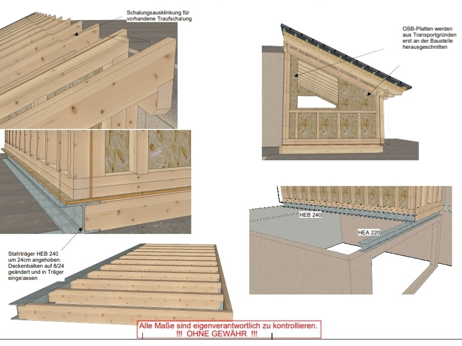

The extension continues with an additional 17m2 (183 sq ft).
The price of 1200 euros per m2 (111 USD per sq ft) remains the same.
Modern two-story house facade with garage and entrance in 3D visualization
Schematic wooden structure: timber frame, OSB sheathing, and roof construction.
