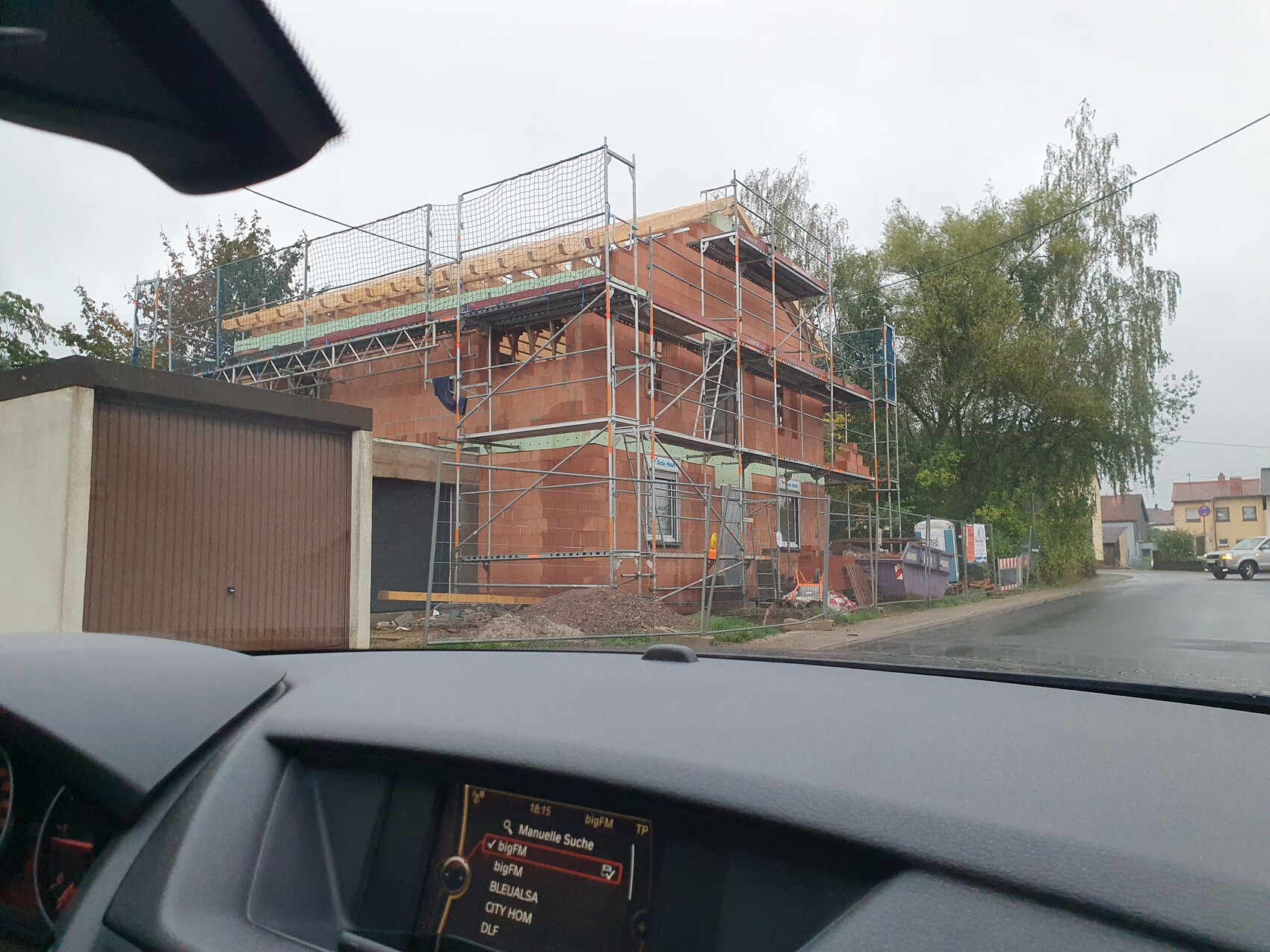

Progress is slow. The garage roof has been sealed twice. The roofer was supposed to come this week, but the construction company was missing 40 bricks for the gable.
The windows on the ground floor have already been installed.

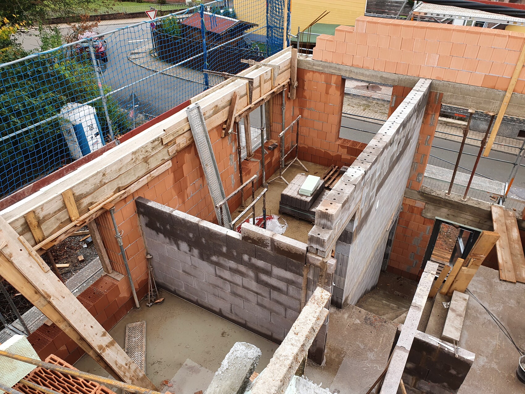

The beam structure is in place.
Now it’s the slow construction company’s turn again.
I will show the defects I have identified so far separately.

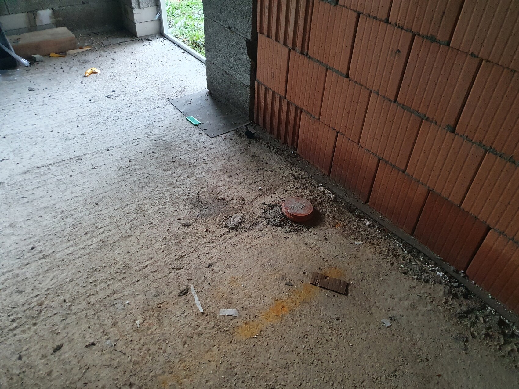

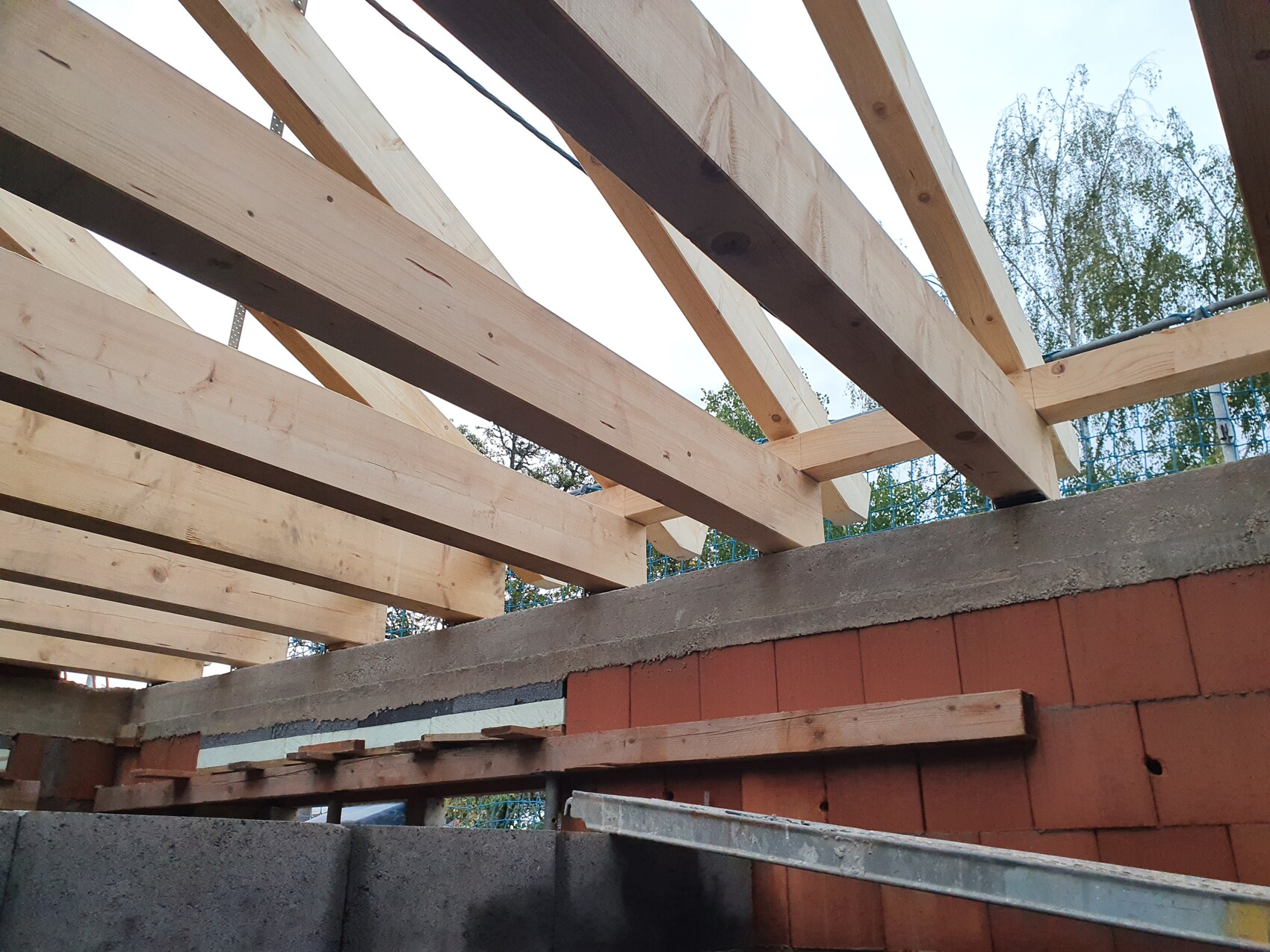

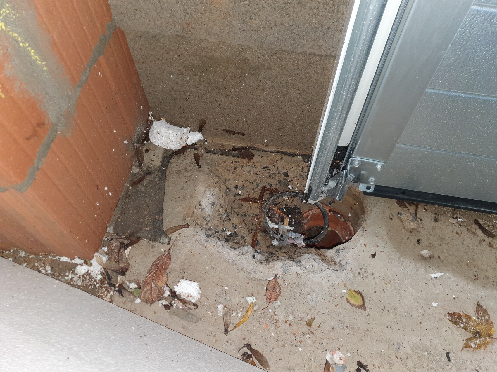

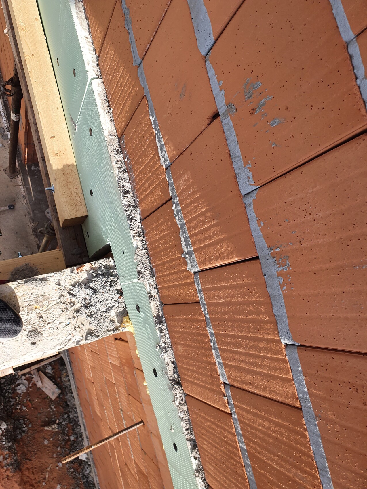

Here are the defects I have identified:
The drainage in the garage is located too far from the wall. Since the concrete will only be sealed, this is not acceptable.
The insulation has been pushed out in the ceiling area of the ground floor.
The ring beam on the upper floor was poured unevenly, so the rafters now have to be filled underneath.
