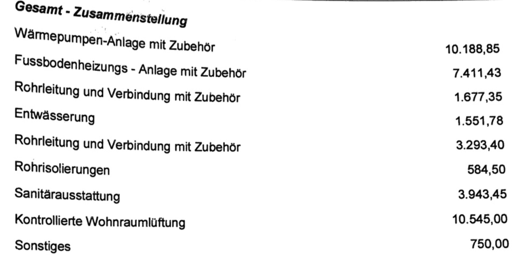

The heating seems okay, I think, considering there’s a large area for underfloor heating. What kind of heat pump is included?
The ventilation is acceptable if it’s a reputable brand and the basement is also connected.
The plumbing costs are quite high if that really doesn’t include any fixtures. See the line items from Zaba. We have about €4,000 (around $4,400) gross for two bathrooms, a kitchen, two outdoor connections, two utility rooms, etc., covering fresh and wastewater including venting. Even with a surcharge for Bavaria, I find that quite expensive.
