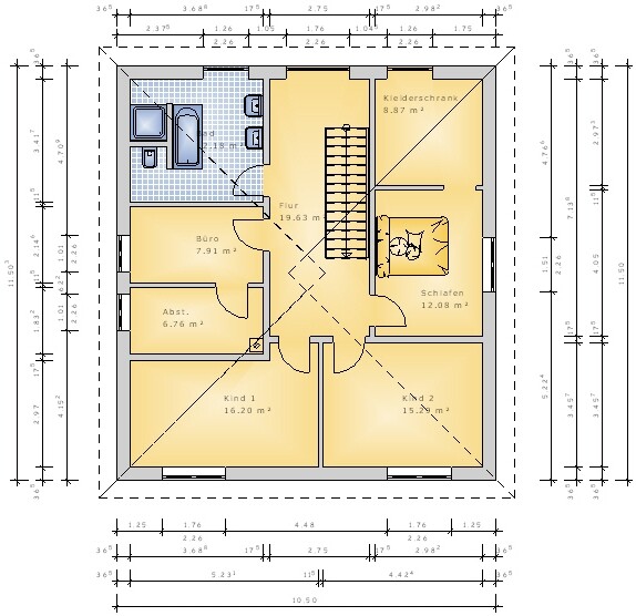

Dear Forum,
We have been silent readers for some time and have now reached the point where a first draft has been created for our building project (planned start spring 2018). Before we proceed with the planning, we would appreciate any tips and suggestions regarding the design. Thank you very much!
Development plan/restrictions No
Plot size approx. 1900 m² (20,451 sq ft)
Slope No
Number of floors 2
Roof type hip roof
Style urban villa
Orientation southeast
Owner requirements
Style, roof type, building type none
Basement, floors no, 2
Number of occupants 3
Room requirements on ground floor, upper floor
Office: family use or home office? family
Fireplace yes
Balcony, roof terrace no
Garage, carport yes, separate
Gallery in the entrance area, side entrance, large utility room, spacious kitchen, orientation of all main rooms (living room southeast, utility room north), large windows on the south side
What do you dislike? Why?
Children’s room with a corner, position of the chimney (a tile stove is planned on the shared wall on the ground floor)
Cost estimate according to architect/designer: approx. €290,000
Why does the design look like it does now?
Research and "combining" of various floor plans, own ideas
House floor plan: living/dining, kitchen, guest room, utility room, shower/WC, staircase.
Upper floor plan: hallway, master bedroom, child 1, child 2, office, storage room, walk-in closet, bathroom.
