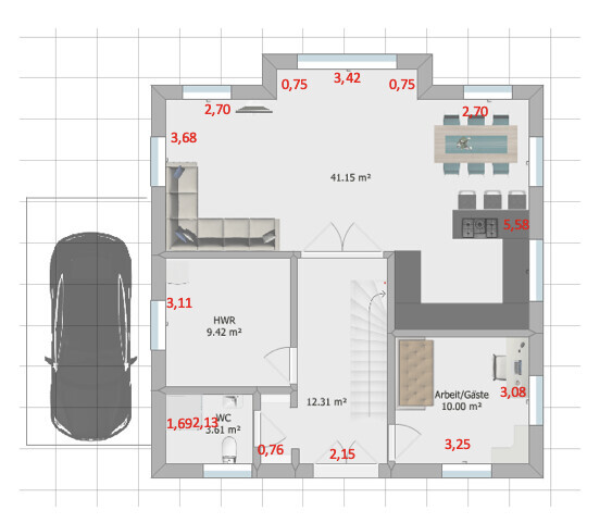

Unfortunately, this does not include any dimensions.
Then try removing the floor coverings in the software, and you will see the grid.
I took a look at the Lugana model with 9.53 x 9.53 meters (31.3 x 31.3 feet) and am surprised about the space you have on the ground floor despite the additional room.
You should realize that the dining table probably won’t fit in the top right area as planned because there isn’t enough space there, so the dining area will likely have to move to the center.

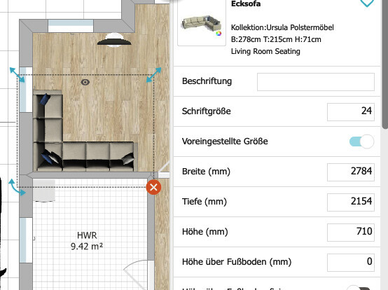

Also, I’m not sure what kind of sofa you have in mind, but the depicted four-seater is rarely possible in just under 3 meters (about 10 feet). The sofa suggests more space than is actually available.
In the office, a desk should be at least 60 cm (24 inches) deep, preferably 80 cm (31 inches). Your desk is narrower than the kitchen countertop...
Furthermore, the interior symmetry is off. If I were to focus on that, it would be distracting.

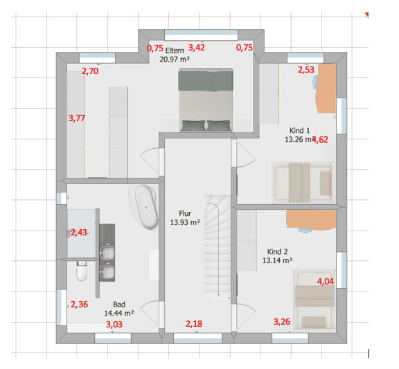

Upstairs, this applies to the bedroom: apparently, the walk-in closet is larger than the sleeping area. The sleeping area should be about 12 square meters (130 square feet), but that doesn’t match the total of 20 square meters (215 square feet)...

A non-expert will most easily recognize the issue with the "dollhouse furniture" by trying to transport a couch like the one shown in a car. Look at the car and the couch. Something doesn’t add up.

You are absolutely right. I just looked at the measurements of the furniture in the program. For example, the desk is listed as 110x90cm (43x35 inches). After measuring it myself with the tape measure tool in the program, I realized that these dimensions include the chair.
The kitchen unit along the wall measures a total of 2.90m (9 feet 6 inches) (excluding bar stools). The kitchen showroom assured us that there would still be room for the dining table there... I will double-check this.
The bedroom is about 20sqm (215 sq ft) in total, including the walk-in closet, which is not considered a separate room.

The bedroom has a total area of about 20 m² (215 sq ft) including the walk-in closet. The closet is not classified as a separate room.
You can see for yourself that a walk-in closet with two wardrobes, each 60/65 cm (about 24/26 inches) deep, cannot create two adequate aisles.
Matthias_1212
13 Apr 2020 20:03
You can see for yourself that a walk-in closet with two wardrobes each 60/65 cm (24/26 inches) deep cannot create two adequate walking paths.
That’s a good point. I will revise this.
How wide should the “walkway” into the room be at a minimum? Currently, it is about 1.00 meter (3.3 feet). What alternatives are there for the walk-in closet?
