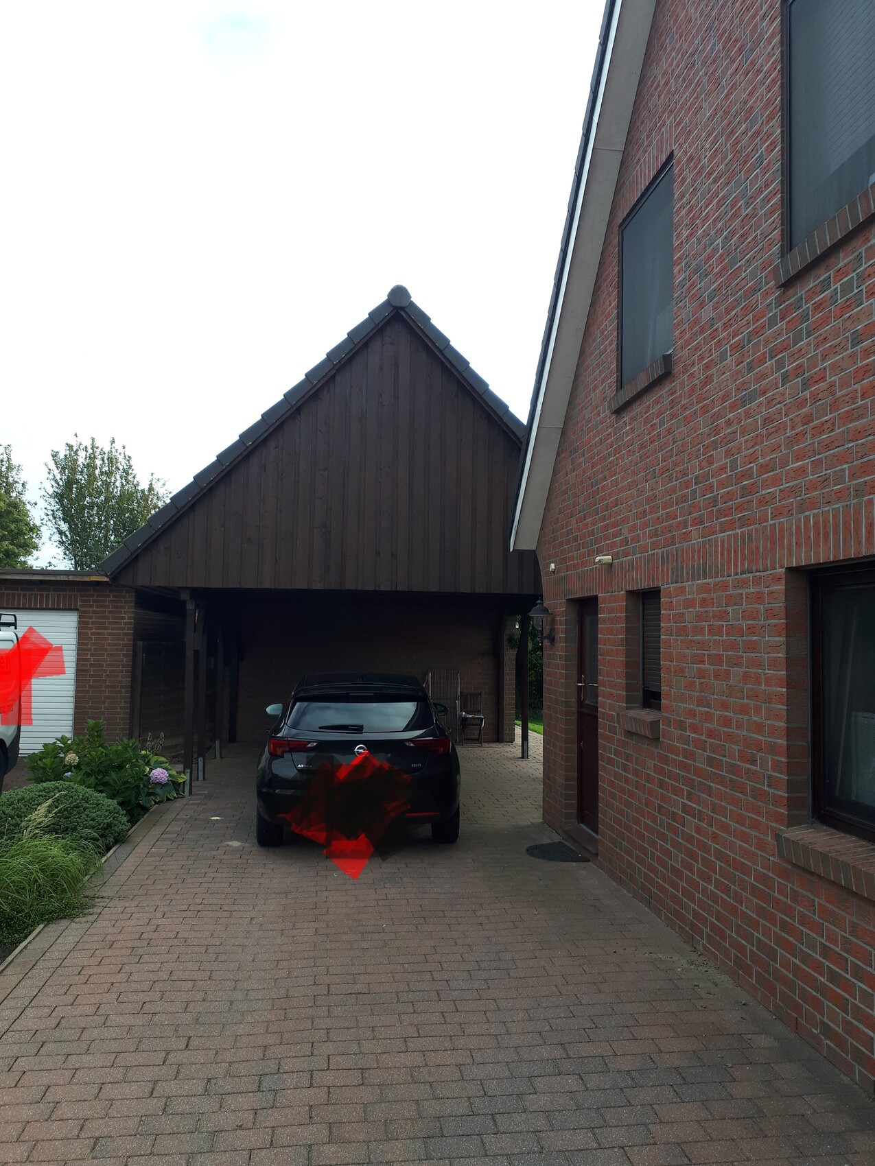

This is approximately how it’s going to look.
pffreestyler schrieb:
It should look something like this Ah, okay, then you can consider the wall thickness more relaxed. As shown in the picture, the roof structure rests more on the supports than on the masonry, and the ring beam can also be slimmer.
pffreestyler18 Sep 2019 12:58Perfect
