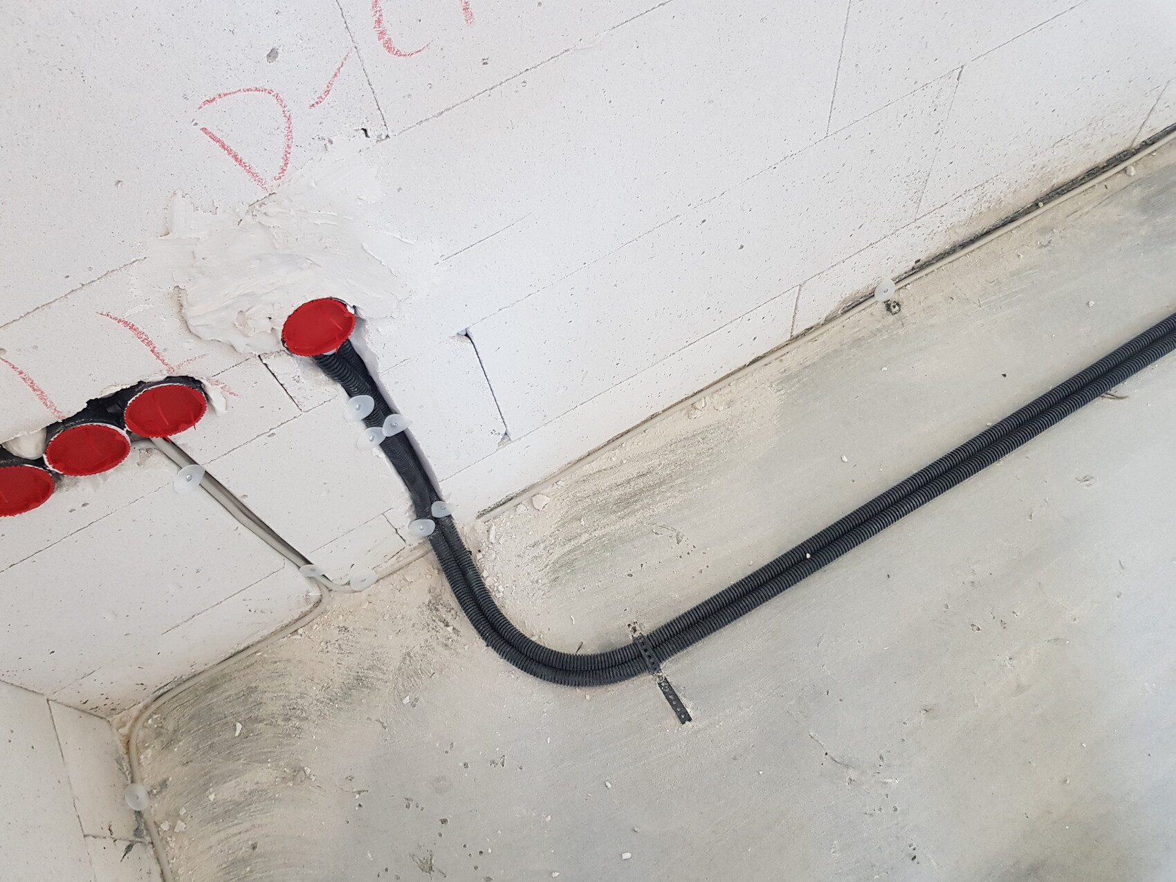

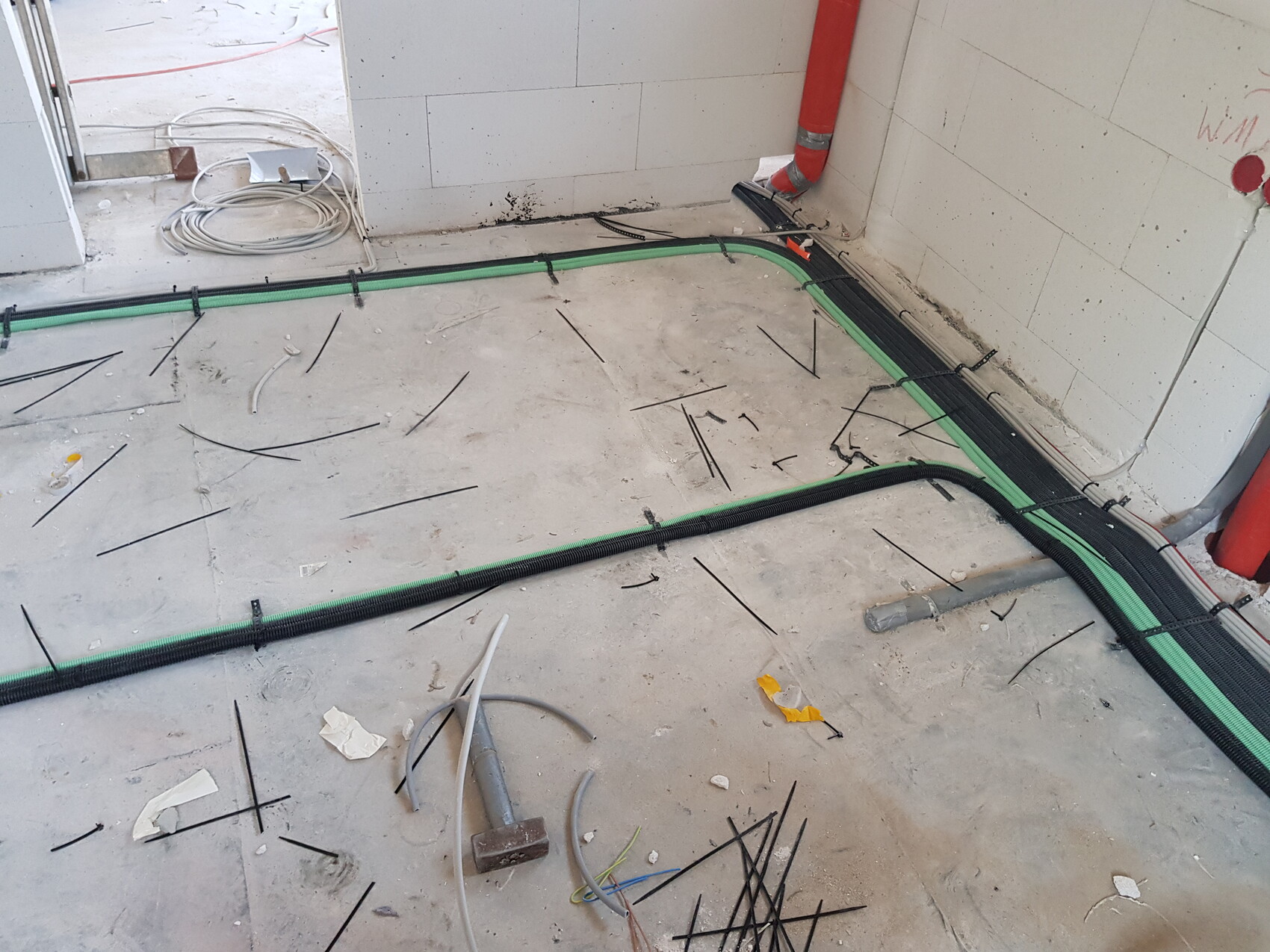

I thought I’d share a photo of our top-quality CAT cables neatly installed in conduits, just because it looks so nice.
The photo was taken during working hours; by the end of the day, the floor was also nicely tidied up again. I have to say, even though we had some discussions at the beginning, to my layman’s eye it looks like they are definitely delivering professional work.
knalltüte25 Jun 2020 07:18I’m wondering how the electrician planned to protect the LAN cables from mechanical damage during the construction phase before the screed was installed. And how did he intend to replace a cable if it got damaged (stepping on it once with a hard-soled shoe could be enough to cause lasting damage)? Removing the screed, underfloor heating, etc.? That would have been quite a challenge.

superzapp schrieb:
I’m wondering how the electrician planned to protect the LAN cables from mechanical damage during the construction phase before the screed was installed. And how did they plan to replace one of the cables if it gets damaged (for example, stepping on it once with a hard-heeled shoe might be enough to cause permanent damage)? Would they have to break up the screed, underfloor heating, and so on? That would have been quite a challenge. I think if we had said no conduit, they would have run the LAN cables through the walls instead of under the floor. But I could be wrong.

ElMatschi8 Apr 2021 11:17kati1337 schrieb:
The photo was taken during working hours; by the end of the day, the floor was neatly tidied up again. I find the pictures really interesting because we will hopefully be getting a similar wiring installation soon. Are there perhaps more photos like this?
ElMatschi schrieb:
I find the pictures really interesting because we are hopefully going to have similar wiring installed soon. Are there maybe more of them?Hi there, yes, I uploaded all the pictures on our blog back then. I’m not allowed to link it here, but you can try searching on Google for "Chris and Kati build a house," and you should find it. 🙂
