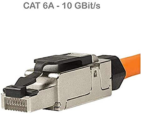

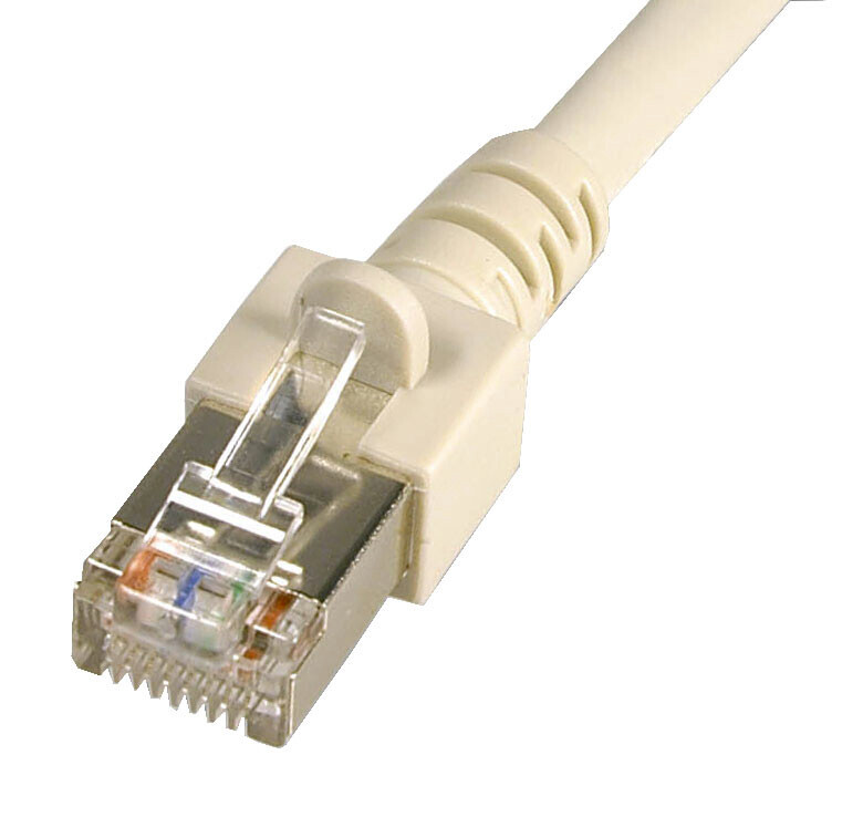

knalltüte
15 Jun 2020 17:11
Close-up of a Cat6A network connector with orange cable
or like this
RJ-45 Ethernet connector on network cable, close-up.
The upper one does not fit into the access point, but the lower one does.
