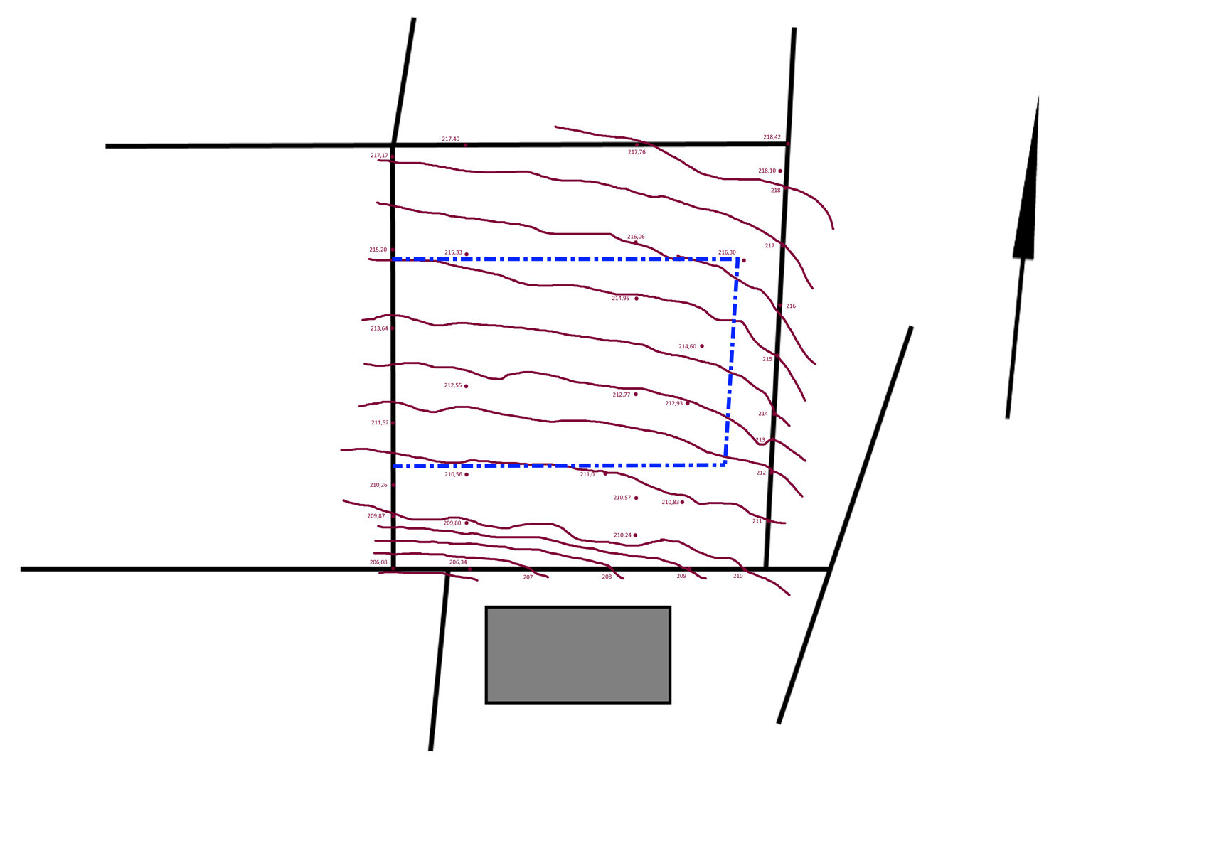

We are more or less about to start the project, and finally, the surveyor has sent the data to our architect.
Now we have a problem with the reference height: our building plot starts 7m (23 feet) from the property boundary, and according to the architect, the bottom edge of our garage is at about 4m (13 feet) elevation. This makes it impossible to create a reasonable driveway directly into the garage, as the slope would be around 50%.
Do you have any suggestions on how to keep this within a sensible range without having to create switchbacks for the garage entrance?
I have attached the architect’s drawings.
Thank you very much and best regards, Anson

Actually, I was hoping for some proposed solutions here, but so far I haven’t noticed much. This is not due to a lack of proposed solutions, but rather because you are not retaining the information. You also do not respond to follow-up questions or do so unclearly, which makes it difficult to explain the proposed solutions to you in more detail. Here is the basic elevation plan, showing the information from the development plan and your site plan:
As shown here—as was already evident in the west view—it is clear over the area that the steepest slope is at the driveway. Therefore, for the majority of the earthworks, it does not matter whether you plan open parking spaces or garages, since the slope will need to be reduced to 15% in any case. It is also clear that shifting the building east-west will not affect the earthworks because the contour lines run almost exactly in that direction.

Every cubic meter of soil moved costs 20,- € excluding disposal fees, so hopefully it’s understandable why I am reluctant to reshape the entire plot. Correct. It is not allowed according to the development plan anyway. That is why I shifted the house eastward and raised it by 1.5 m (5 feet). I also positioned the garage away from the neighboring boundary, since the future owner is unknown and any boundary building—whether garage, carport, or retaining wall—would only be feasible with sheet pile walls, which would significantly increase the budget. If funds are tight, you can start without the garage.

hampshire10 Oct 2020 10:26Just estimate a flat additional cost of €150,000 (approximately $165,000) for your plot with a flat land design. This allows you to build something on the property that doesn’t necessarily have to follow the most economically sensible approach. If that’s too expensive and you find the basement solution too boring, then stay away from the plot.
