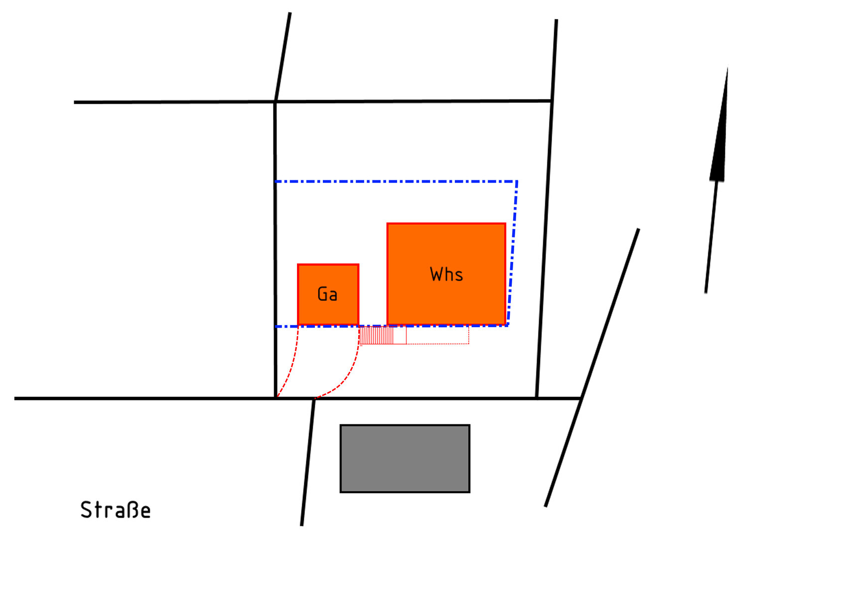

We are more or less about to start the project, and finally, the surveyor has sent the data to our architect.

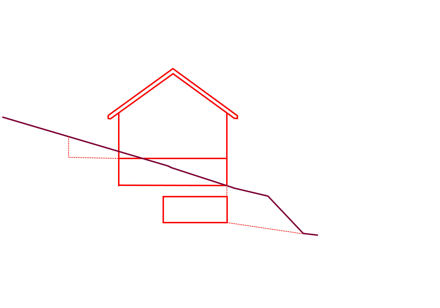

Now we have a problem with the reference height: our building plot starts 7m (23 feet) from the property boundary, and according to the architect, the bottom edge of our garage is at about 4m (13 feet) elevation. This makes it impossible to create a reasonable driveway directly into the garage, as the slope would be around 50%.
Do you have any suggestions on how to keep this within a sensible range without having to create switchbacks for the garage entrance?
I have attached the architect’s drawings.
Thank you very much and best regards, Anson

And if I understand the original poster correctly, the general contractor (GC) doesn’t want to start deeper because, as a timber construction GC, he only wants to subcontract the basement and not the first residential floor above.The GC will have to accept that if he wants the contract. For projects like this, separate contracts are apparently much more flexible.I’m afraid the original poster tends to favour inclusive planning by the general contractor. However, I don’t see anything resembling a standard building plot here :-(
We have a slope of 1.2 m (4 feet) over 8 m (26 feet) in length, slightly steeper than in Hampshire. My parents have a section with 2 m (7 feet) over 6 m (20 feet) length. Without ice and snow, it’s manageable. However, in winter, you often end up sitting on your backside unintentionally.

clearly shows an integrated garage on the uphill side as wellWhether the garage is fully integrated cannot be determined with certainty due to the missing third dimension, since a system section cannot be assumed to be a typical true straight section. In any case, the garage is located below the basement level and does not extend the full depth of the house.Here is an example of an underground garage with visitor parking spaces in front.
